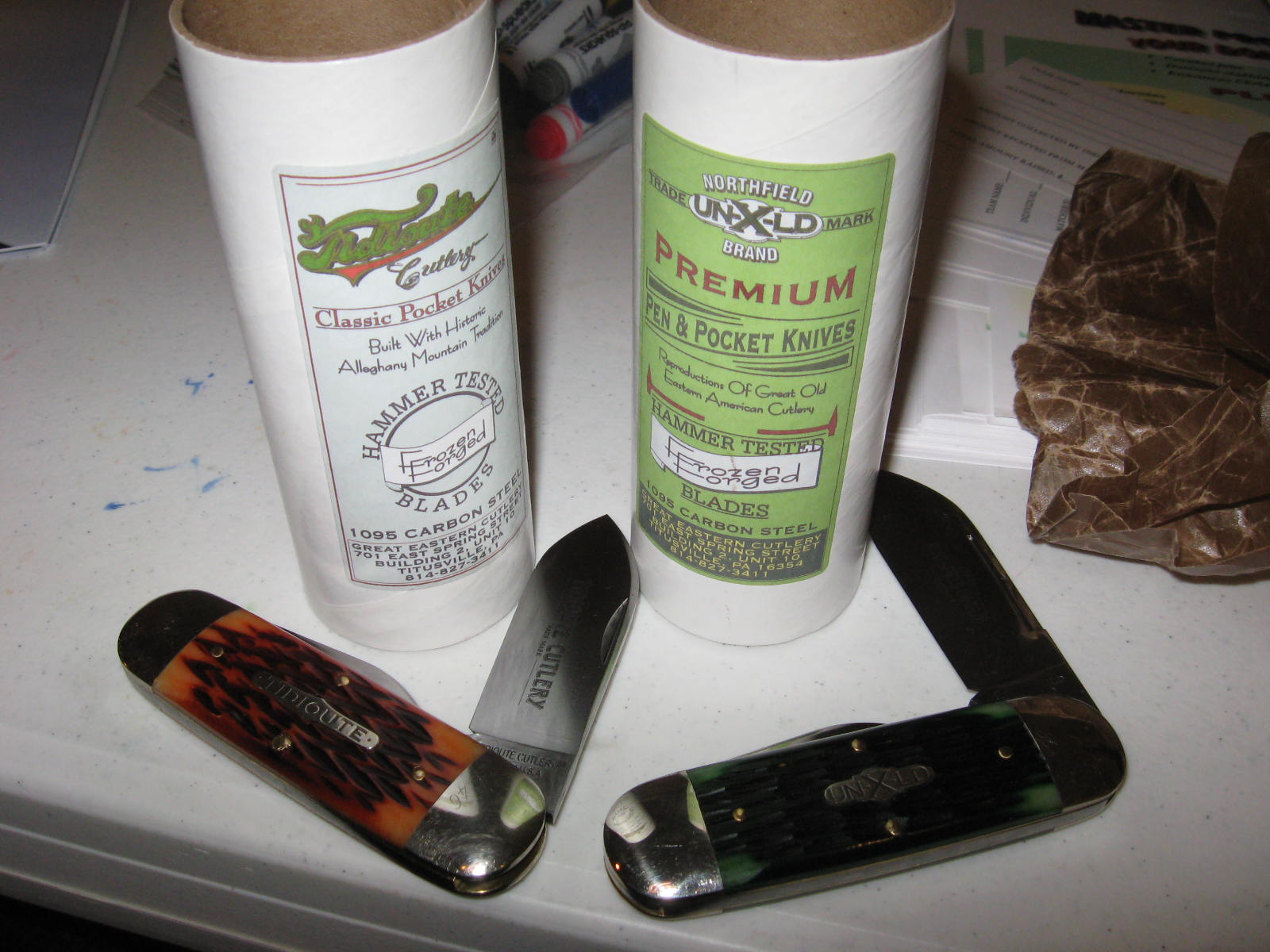

FELLAS,
GOT TWO NEW TOENAILS. TRACTOR GREEN,CARVED PUMPKIN. NICE KNIVES BUT A LITTLE DISAPPOINTED. THE CARVED PUMPKIN MASTER BLADE WILL NOT SNAP AT ALL. YOU HAVE TO PUSH IT ALL THE WAY TO GET IT TO CLOSE? THE TRACTOR GREEN SNAPS WEAK BUT DOES SNAP. GREAT AESTHETIC BUT DISAPPOINTED IN THE MECHANICAL.
ONE MORE QUESTION? THE MASTER BLADE SEEMS TO BE RESTING AGAINST THE BRASS RAIL. (IS THAT WHAT IT IS CALLED) ITS SCRATCHING UP SIDE OF THE BLADE WHEN YOU SHUT IT?
JAY PARKER

I think what your saying is the blade is getting scratched from the brass liner, thats not something to uncommon in the knife world, and I believe if you sent them to GEC they would take care of everything.
They are both beautiful knives. 8)

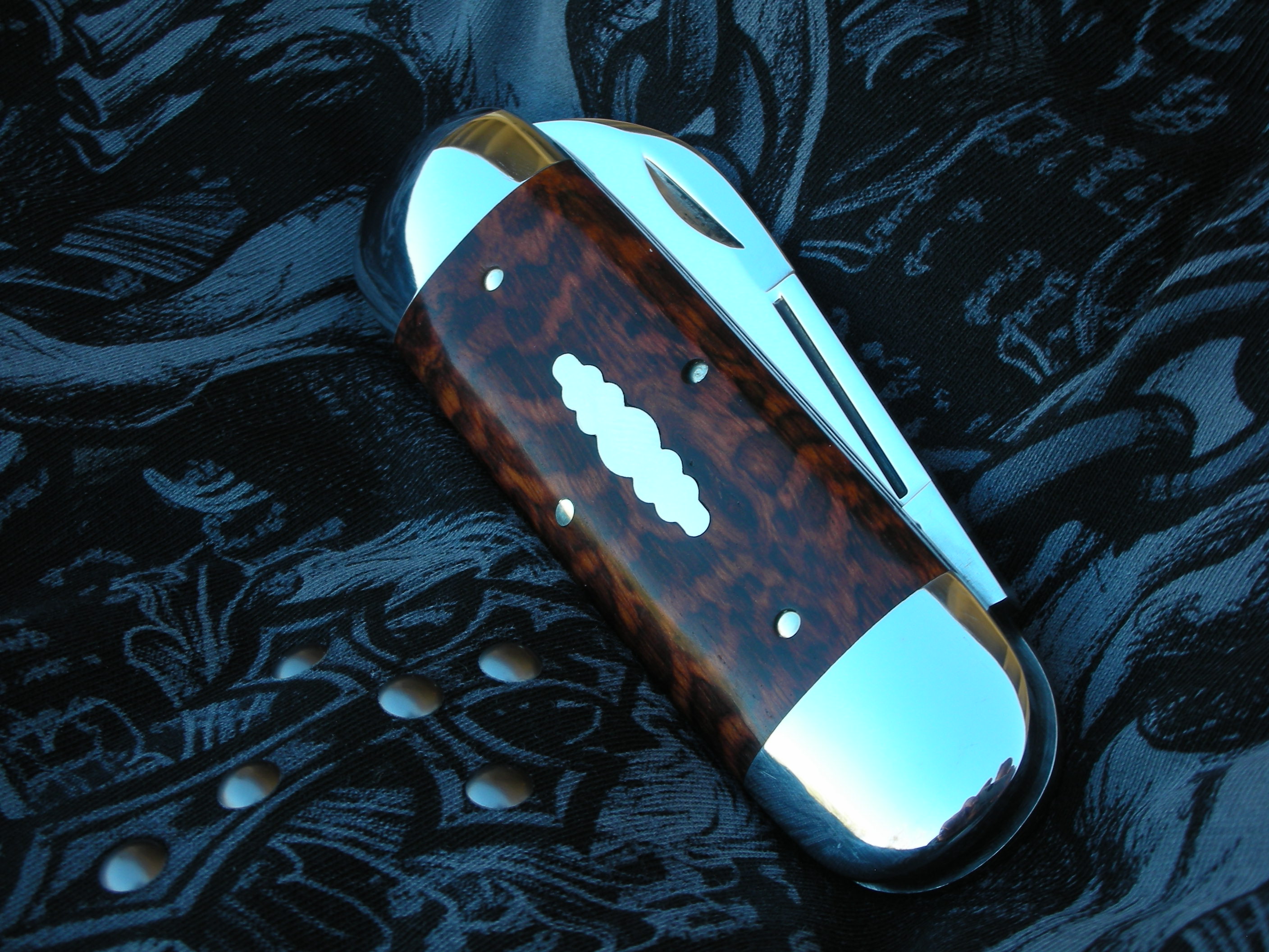

from CK.net web site
Sunfish Note
For safety reasons, these GEC Sunfish knives do not have the closing snap of other patterns. They are radius cut and the closing action is very slow. It is not a defect, but something the buyer needs to be informed about
Must have missed this one cause it will take your finger off
JAYLUPARK
Posts: 98
Joined: Mon Dec 06, 2010 3:24 pm
Re: NEW GEC SUNFISH
Post by JAYLUPARK »
JODY, The carved pumpkin toe I have is real hard to open? Almost like it's stuck closed. I'll contact gec and see what they say.
