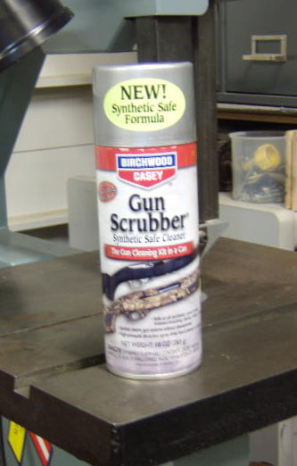

Is that the stuff in the spray can? Almost like carb cleaner/degreaser? I've got a few recently purchased knives that just don't have any "snap" to the blades. Springs seem heavy enough, but the blades don't snap open like I'd prefer. Have blown one out with WD40, which had minimal effect. I would try something like the gun cleaner if I was certian it'd not harm the finish of the knife. Two of the knives I'm thinking of are Case stags, and it appears they have some type of clear coating or varnish over the scales. I don't want that stripped off by using a harsh cleaner if I can help it.have had knives with no snap that I clean with Birchwood Casey gun cleaner,
Any and all info is appreciated.
- orvet
- Posts: 19898
Re: Lazy springs.
The stuff I got says it is safe for synthetic materials.
I don't think I have used it on celluloid, but I have used it on stag, wood, metal and bone handles without any probs.
W-40 is really made to dry something out - Water Displacement -formula 40
It really doesn't lubricate much.
Clean it with the Birchwood Casey, (it is the aerosol can) then lube it with Slick 50 One Lube.
I think you will be surprised at how well it will snap then.
Let us know how it works.

I know they aren't worn and the springs should be strong. I assume the Birchwood Casey is a solvent; will it take the color (dye) out of bone scales? I haven't been able to find this product locally. I have some Hoppe's # nine;
hoping that will work as well.

I have found Birchwood Casey at Wal-Mart, Sports Authority, most gun shops and most Sporting Goods stores in my area. My local Wal-Mart stopped carrying it a few months ago. That is when I started looking for it. It is more readily available than I had thought.
I have not had a problem with it on the bone or any handle material.
It is safe for synthetic materials according to the label.
I try not to get the Gun Cleaner on the handle; I use the nozzle (tube) and spray it down in between the liners & basically blow the gunk out between the liners, springs and tang of the blades. It has a good amount of pressure so the pressure and the cleaner blows the gunk out. I have even seen chunks of gunk blown out of knives. After I have sprayed it I blow any loose dirt out with my air compressor.
The Gun Cleaner has a very low evaporation point and dries in seconds after spraying the knife. I think it evaporates too fast to soak into the bone. Personally, I would be hesitant to use Hoppe's because of the oil in it. The oil in the Hoppe’s makes it evaporate much slower & it might cause a problem with some handle material.
Here is a pic of the Birchwood Casey Gun Cleaner so you know what to look for.
Good luck with it,
Good luck with it,
