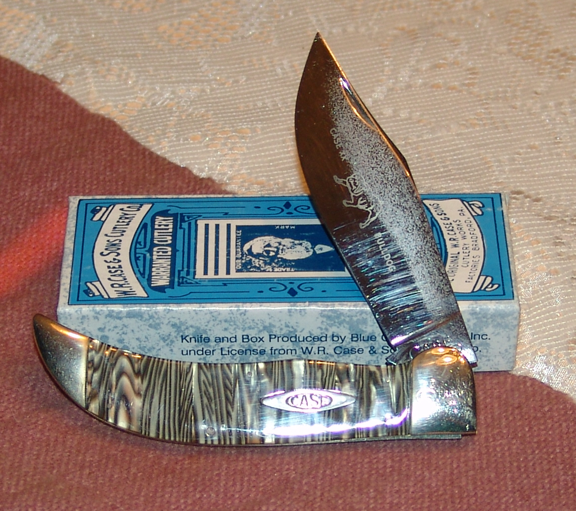

Here is a good example of what outgassing can do to a knife. This is a Case Classic prototype(probably a 1 of 1)...
...CCBill...
...CCBill...

Ouch!!!
It hurts to look at that...even though it is a good example of a bad thing (outgassing).

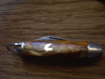

Here is a little shell handled Hammer, that has it all...outgassing, crazing, peeling, cracking, shrinking, and pitting.
Otherwise, it's in mint condition.
Bill
Bill
