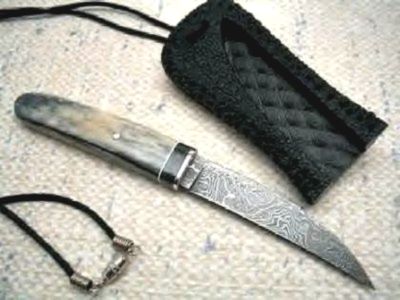

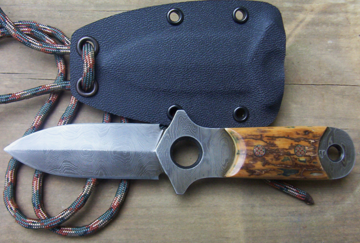

Here is one that I wear whenever I choose to wear a neck knife. Yes, I have used it...but not abused it.
In my opinion, a folded and welded, or laminated steel (Damascus type or Wootz) blade isn't necessarily a "better" blade than any other well made blade. They do allow for some striking and/or progressive patterns, which many collectors seem to prefer over plain steel, especially on modern knives.
Usually, a couple different types of high carbon content steels, and an etching component, are used to create contrast. Often, some nickle is added for toughness.
There is also a stainless "Damascus" (like Damasteel brand, for one) that has become popular. So there are differences. Also, a well made blade is a good thing
...but a poorly done blade is still just poorly done, whether is stainless, carbon rich, or Damascus.
I guess one answer about EDC and Damascus is...that it usually costs more, so a lot of folks don't want to screw it up. Then it becomes art...rather than a tool.

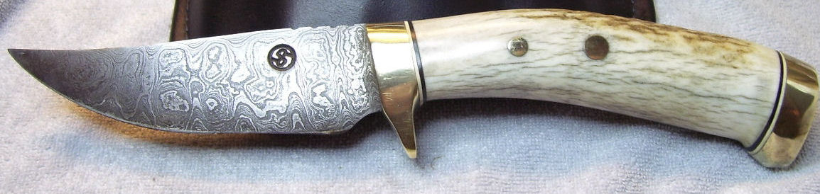

I have one Damascus fixed blade which I have used quite often and have not taken care off as good as I should have..!!
I found some information on Damascus from the maker of this fixed blade that you might find interesting or helpful...
The following information comes from Ray Rantanen Custom Knives..
Today’s average prices, in the US, for blade quality Damascus steel knives, ranges from $175 to $250 a blade inch with some makers getting near $1000 per blade inch. There is a lot of Damascus steel that is inferior steel, much of it imported. Just because it is Damascus does not necessarily mean it is a good knife. A quality Damascus knife is a thing of beauty, strength, integrity and is unique from all other knives.
The final price depends on the width and length of the blade and any special handle materials.
SHARPENING DAMASCUS:
When the Damascus is put into the acid it is sharpened first. After the acid etching the blade is resharpened with 320 grit sanding belt on a 1 x 42 inch belt sander. Then it is sharpened on a 600 to 1100 grit worn belt. The cutting edge is placed so that it is facing the belt – the belt is moving towards the cutting edge. After several passes the blade is stropped on leather, resharpened, stropped again until it has an edge sharper than a scalpel. Stropping breaks off any wire edge that is developed on the edge from the sharpening.
This is the state you should receive your Damascus knife. As the mild steel wears away faster than the other two high carbon components, a miniature saw is created at the cutting edge. After a while the minute saw teeth become misaligned a bit. Now, with two gentle strokes per side on the ceramic rod the knife will be shaving sharp again. This is done by holding the ceramic rod in the left hand. Put the heel, near the guard, of the blade on the rod at about a 20-degree angle. Draw the blade from heel to tip gently and slowly with very little pressure. Do not try to remove metal, just use a light pressure from heel to tip. Do the other side, and then repeat once more. The edge on your Damascus when you receive it has a uniform angle the whole length of the blade. So sharpening should be easy. If the blade becomes hard to sharpen this angle needs to be reset as I do on belt grinder. I recommend you send it to me for cost of postage and I will resharpen it.
Serrated edges are another story. These should be sharpened on a triangle cross-section set of ceramic rods supplied by Spyderco Company. The knife blade should be held vertically and drawn from heel to tip down the ceramic rod, alternating each side. Each individual serration does not need to be filed or worked with a stone.
Occasionally, the Damascus blade and the brass fittings should be cleaned. To clean the blade use a piece of worn 600 grit sandpaper and sand lightly lengthwise on the blade. This will polish the raised portions of the pattern and make the blade look brighter. I use Flitz metal cleaner on the blade after it is sanded and also on the brass and handle tang metal that is exposed. This cleaner will clean all metals. Any brass cleaner should work on the brass pieces. WD-40, Birchwood Casey gunstock wax, Johnson’s paste wax, Vaseline, or vegetable oil will also work on the blade.

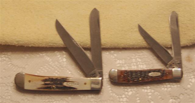

Here's a(sorry) picture of a 5254D, made in 1996 and a Roger's bone mini trapper, made in 1989.

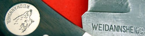

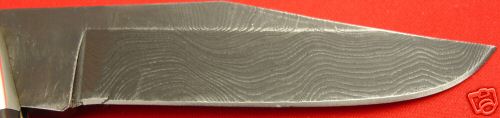

Now if I under stand correct this knife would not be one to buy then.
Because it might be poor or fake. I don’t see the lines or as you might say art work on the whole blade?

Hey Ken,
Weidmannsheil is a pretty well known brand out of Germany that went out of business and the rights to the brand were purchased by Jim Parker of Bulldog. They are currently manufactured in the same factory as Bulldog, FightN Rooster and others by the Olbertz factory.
I personally do not know much about their quality in damascus maybe some others will know ?? One thing that does jump out though is that the tang on the knife you have in the picture has mispelled weidmannsheil...

It looks like real damascus too me . There even appears to be a tiny weld crack in the edge near the ricaso.
Good damascus basicly comes down to the steels used.
You can make it from any two or more steels that will forgeweld togeather, however as with any steel the heat treating process is the final result. If two or more steels are used that, by themselves, make a good knife, you're gonna have a good piece of steel.
