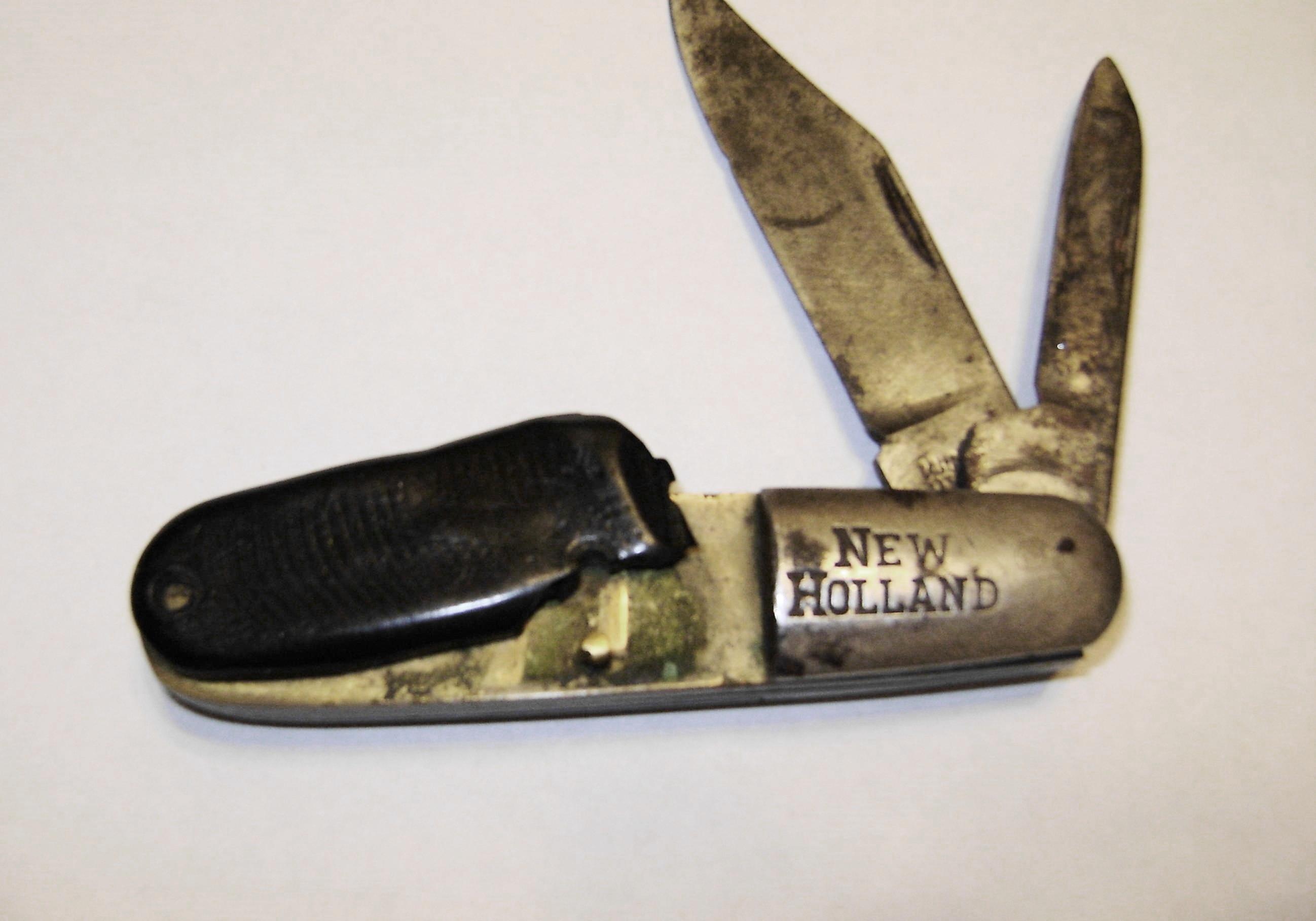

Can anyone tell me what is the best glue to attach new handles ?
This is my first attempt!

Thank you for all the suggestions. I'll be rehandling a A Kutmaster Barlow with a New Holland stamp on the side of the bolster.

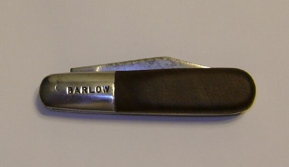

Finished! What do you think?
or

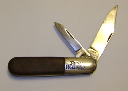

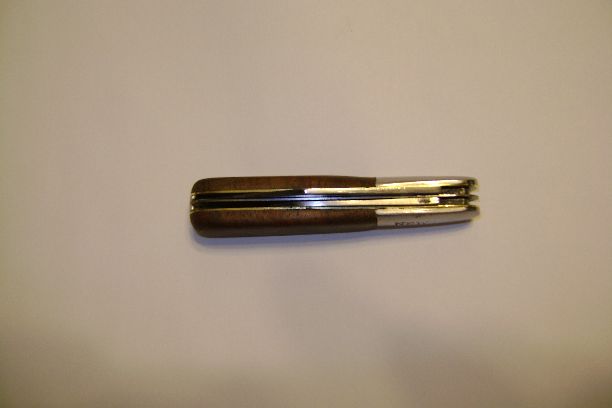

Two more views!

It looks good Ferguson!
Far better than before you started on it.
Just curious; but why did you decide to put it together without any pins?

I cut off the pins and peened them, I wanted a smooth walnut scale on them with no pins showing. I'm going to try another one soon and try to pin it on, i'm starting out slowly and trying different things out as I go along, I might try a kit knife and see how I do. Thank you for your comments.
