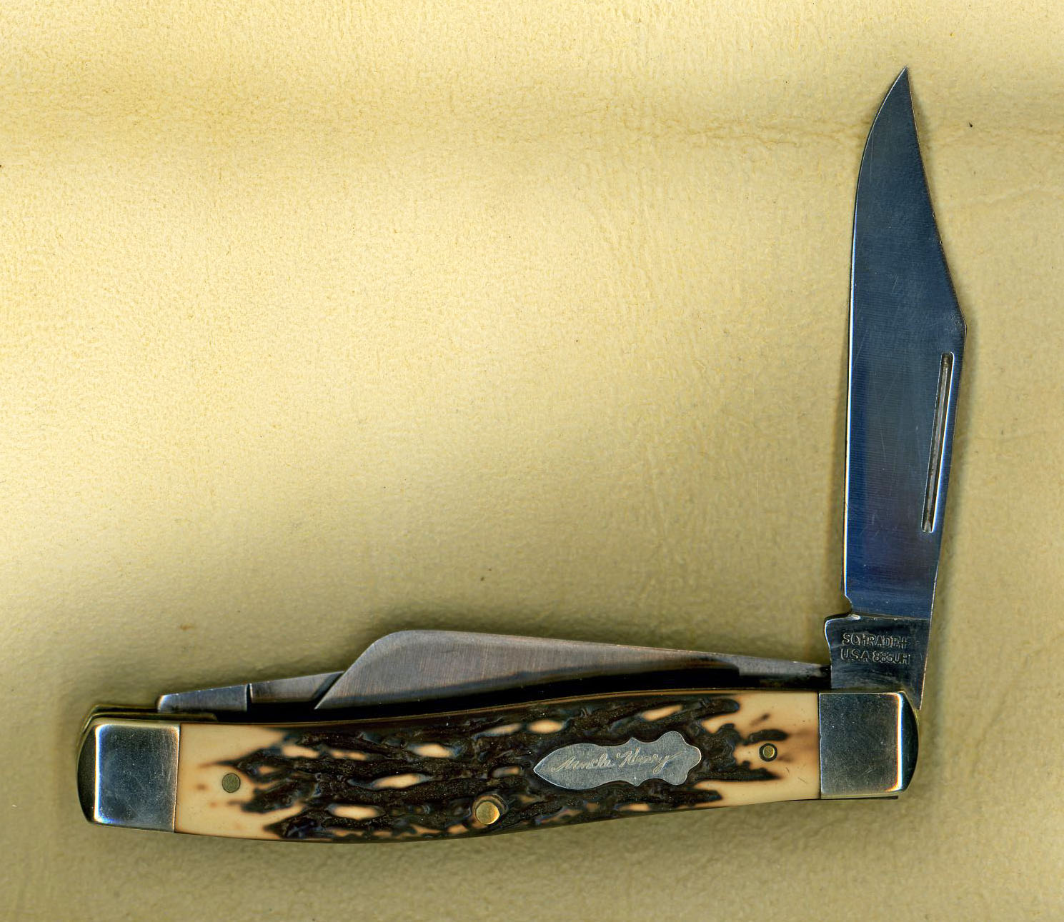

Sorry Ken,
I thought I posted a picture of the replacement blade.
As you can see, the blade is still in the doner knife.
