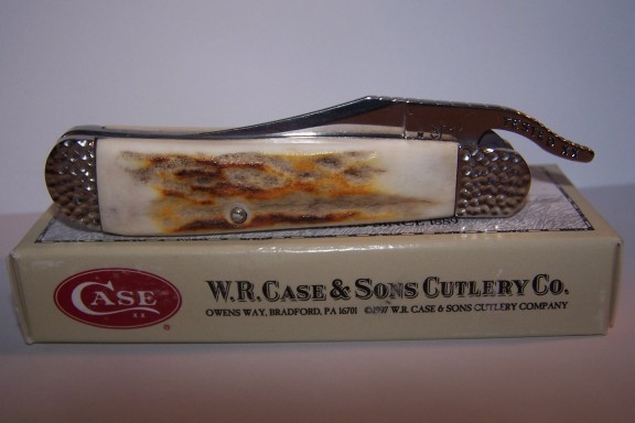

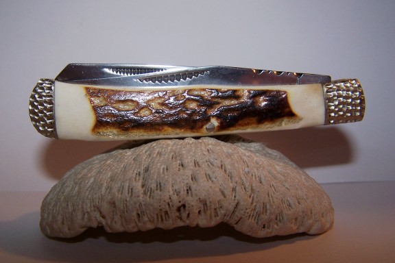

I usually just buff stag with Pink Scratchless rouge on my buffer. I use a medium speed and a loose muslin buff (Please familiarize yourself with the safety rules for buffing before attempting) This leaves a very nice shine. I then would soak it down with good ole WD-40 and clean off all the reside. Then I reccomend a good quality wax like Rennaissance wax or I have used Johnson's wood floor wax. I have used this method along with the flame treatment on very weathered elk horn with good results. This antler was hanging on a barn for years and faded completely white.
JMHO

hairstonjg,
As you can see, Jeff knows his stuff and does great work. So if you have a buffer, there are some good hints.
My method is for mechanically lacking/challenged folks, like me. :roll: :oops:
Nice work there Jeff. ::tu:: ::tu::
