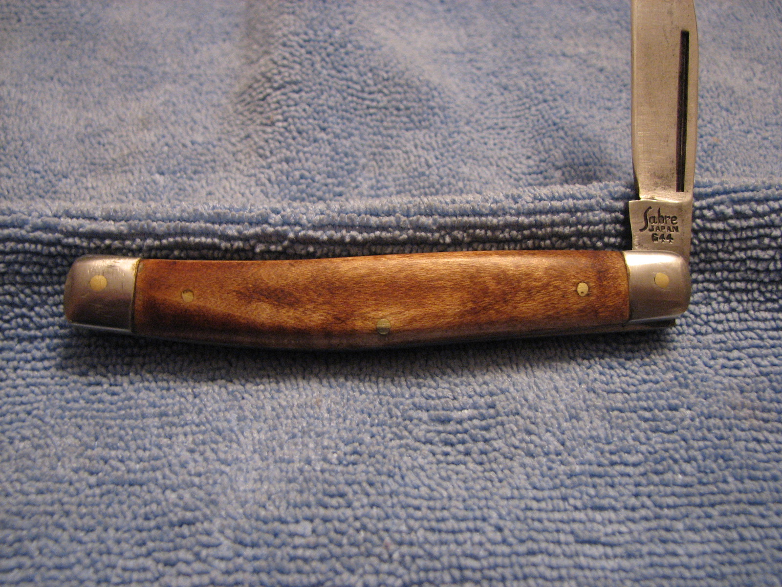

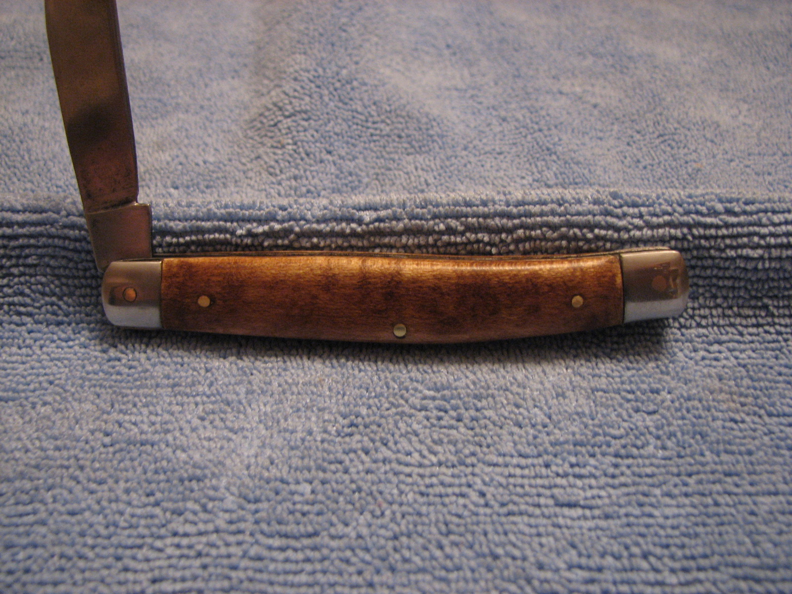

He is my firs attempt to post a picture on this forum. These are a couple of photos of the completed knife. I should have taken a couple of before pictures. I literally pulled this out of the trash and it looked like it belonged there. It laid in a draw of my tool box for a couple of years. I am fairly satisfied with how it turned out. I learned a lot. The curly maple scales are quite figured but it really doesn't show in the pictures. I skipped using poly and went with a sanding sealer and wax finish. [The blade is tight with no noticeable play. I have it shaving sharp. I plan to put it int to my EDC rotation an see how it holds up.

Nice work! Now you have the bug, you will be looking at knives, thinking how you can make them over. thanks for sharing.
Glenn

nice job, now no broken knife is safe. haha

Thanks for the kind works. I managed to get the bolsters and blade cleaned up quit a bit better. I'll be keeping my eye out for potential project knives.

Great start! Now get busy and show us what else you can whip up! Watch out yard sales - here comes a Cutler!..
