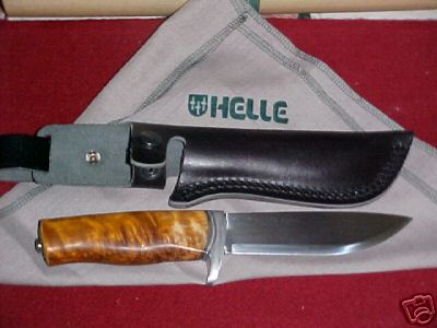

Here is one 3 layered blade I have. I think she answers all you want in a knife like you asked.
Many of Helle knives are made this way.
Helle Safari HE 35 Curly Birch 3 layers SS Norway 9 1/2

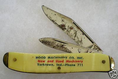

I saw this on the bay.
I just want to show you all what a chrome plated blade would look like after mother nature gets to her....
If you look close you can see stuff flacking off the blade.
