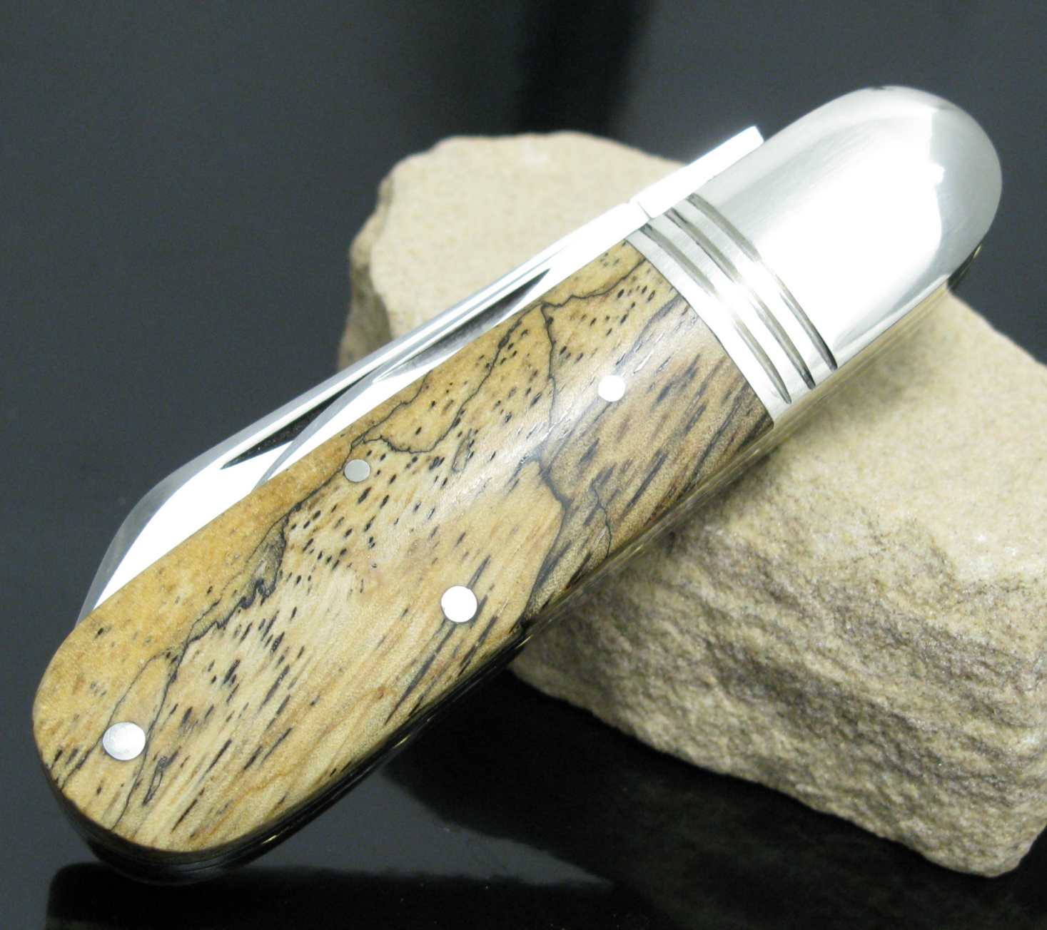

My favorite pattern in the world (should be obvious by now :P) the Gec #25
Tidioute barlow model w/pen blade, done up in Stabilized mango with liner filework

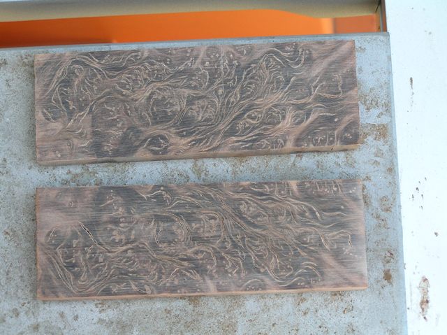

I like both of those - A LOT! I really like both woods and have a bunch of both stabilized. I think I can help with the eyes in the Redwood - since I have a lot of that stabilized Redwood on hand.
1.) You can use Zap A Gap, its a cyanoacrylate glue that fills in gaps that would otherwise fill in with gunk from a buffer.

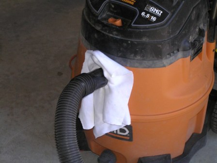

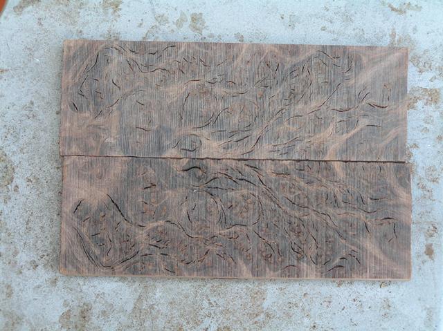

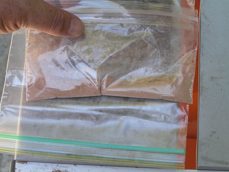

2.) Here is a picture of my sawdust capturing method and the results - a baggie of sawdust from stabilized redwood scraps. This is the WORST PIECE OF REDWOOD I HAD as far as cracks and inclusions. I still need to put it on a knife. ::doh:: The last picture is of how it looked before any fill. You can see all the eyes in the last picture - they will pop out A LOT once I finish the wood on a knife and it should be real nice - like yours I hope.
I filled the voids with the Redwood sawdust I made and collected from stabilized scraps from pieces I cut from the ends of these 2 scales (bookmatched). I then used a cyanoacrylate glue that's thin and penetrates to solidify the sawdust. Once dried I sanded the scales flat again. You can see that there is still a void or 2, but those can wait until I have the scales on a knife - as I shape the wood the voids will likely decrease in size.
I apologize for my lengthy post - I don't mean to detract from the beautiful work you have done - again! I hope to be of help with handling voids and cracks in the handle material.
Once again - you have done a beautiful job on BOTH KNIVES. Thanks for sharing! ::tu:: ::tu::

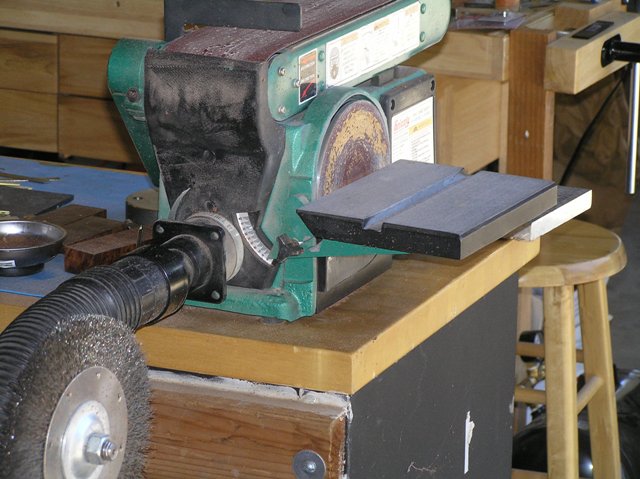

well, I said I was gonna revisit the EO jack, and I did. Sadly, I let myself get frustrated, and I put a huge gouge in the bolster with a file. See what happens when your not in the right mindset?
Anyways, I'm not one to let something like that sit in the spares bin, so I did something I've not done before. I took some 410 stainless sheet I had lying around, and some black G10 composite and gave her the ol' shadow treatment. New liners, new scales, used a stainless washer to peen my pivot onto, and was able to sharpen up the filework a bit. My usual pictures didn't seem to fit the style, so I brought my mac into the shot. Somehow I think the end product is a bit more "high tech" than GEC envisioned.
I'll get to work with that redwood again, I have a tiny bit left, another knife, another day :)
