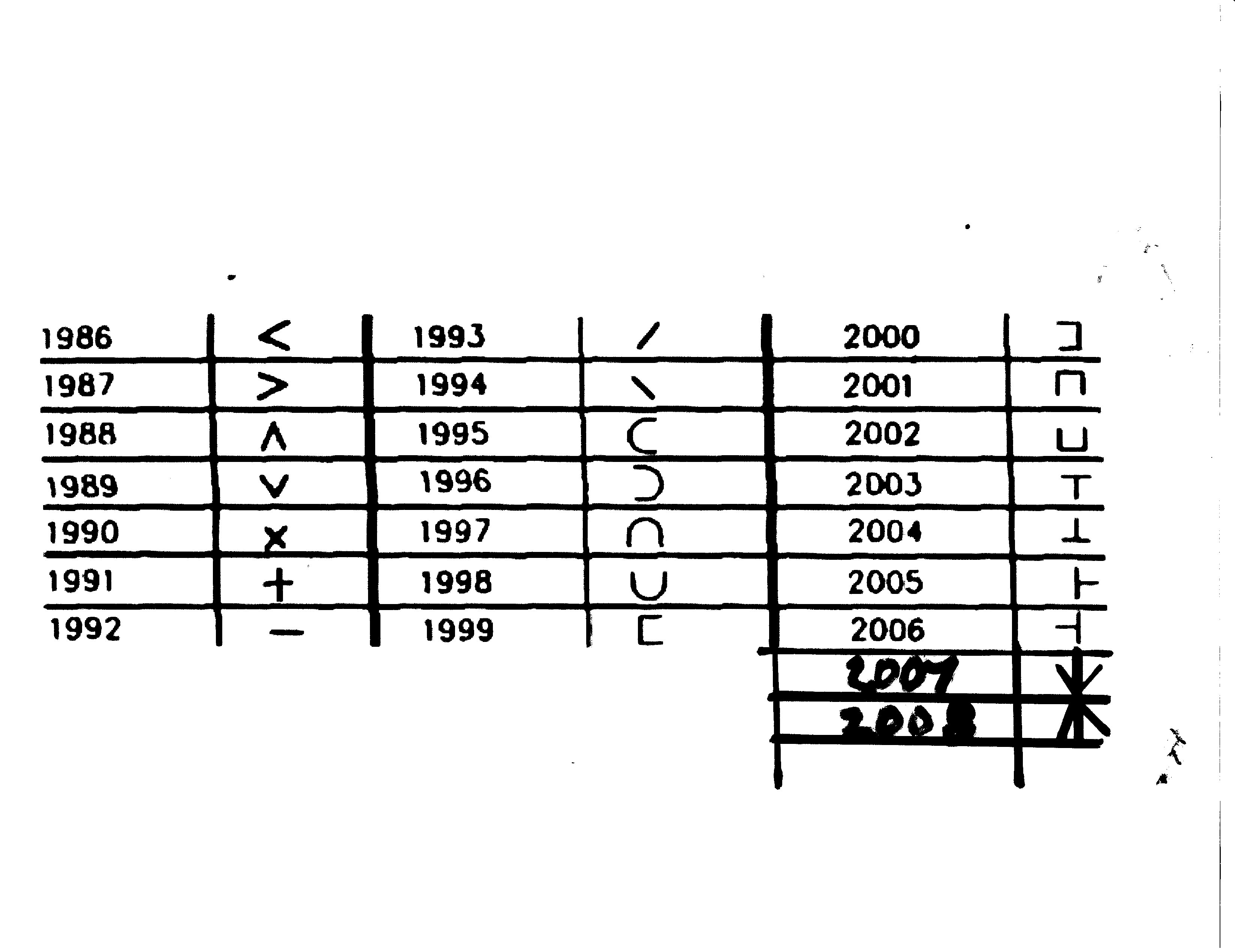

buck date chart
updated

2002's mark was changed to an anvil to commemorate Buck's 100 year anniversary, and the 2005 mark was changed to an outline of the state of Idaho to commemorate our move north.
I am not positive if there are "some" knives out there with the original marks for those 2 years, but it is possible.

thanks joe, maybe i can add those to the chart.

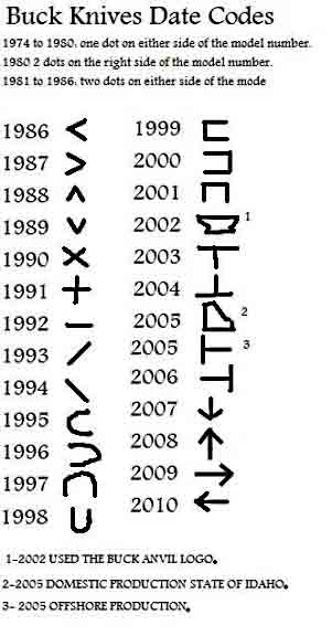

Date code chart to 2010......THE DOT SYSTEM INFORMATION APPLIES ONLY TO THE 110/111/112 MODELS. ALL OTHERS ARE DATED BY WAY THEY ARE MADE OR AFTER 1985 THE SYMBOL DATE CODE SYSTEM.

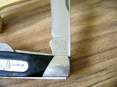

I have a 301X. So the X means it was made in 1990? All this time I thought it was a model number. I learn something new from this forum almost daily.

No date code indicates pre-1986. The info at the top of the chart about the dots applies to the 110 and 112.

ATTENTION, ATTENTION, ATTENTION, ATTENTION
The dot date code system for Buck does not apply except for the
110/111/112 family of knives. Everything else is either dated by differences of manuf. or after 85 the date code symbol chart.
Please do not think you have a knife older than 74 because it has no dots......in truth it probably is a 1990s knife......
The small print on top of one date chart can fool you, that info is just for 110/11/112s.

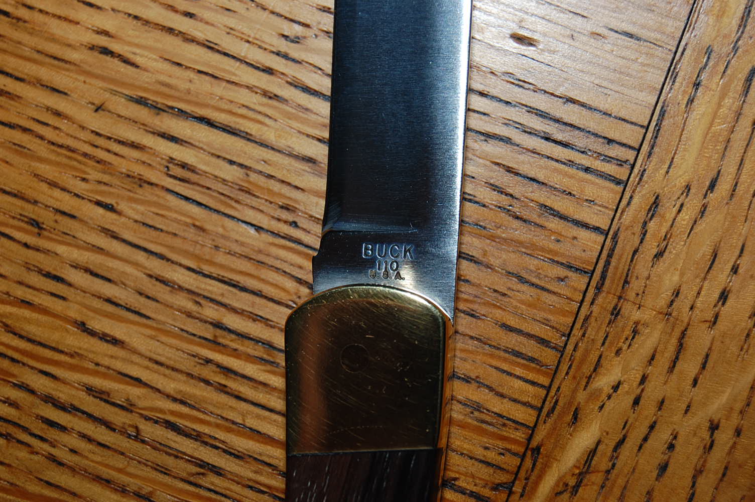

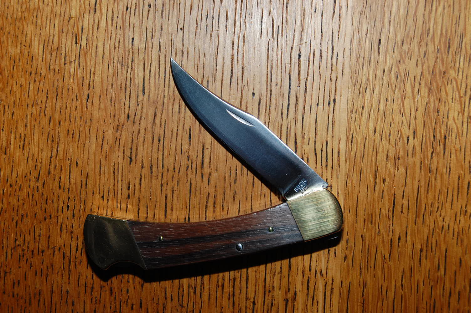

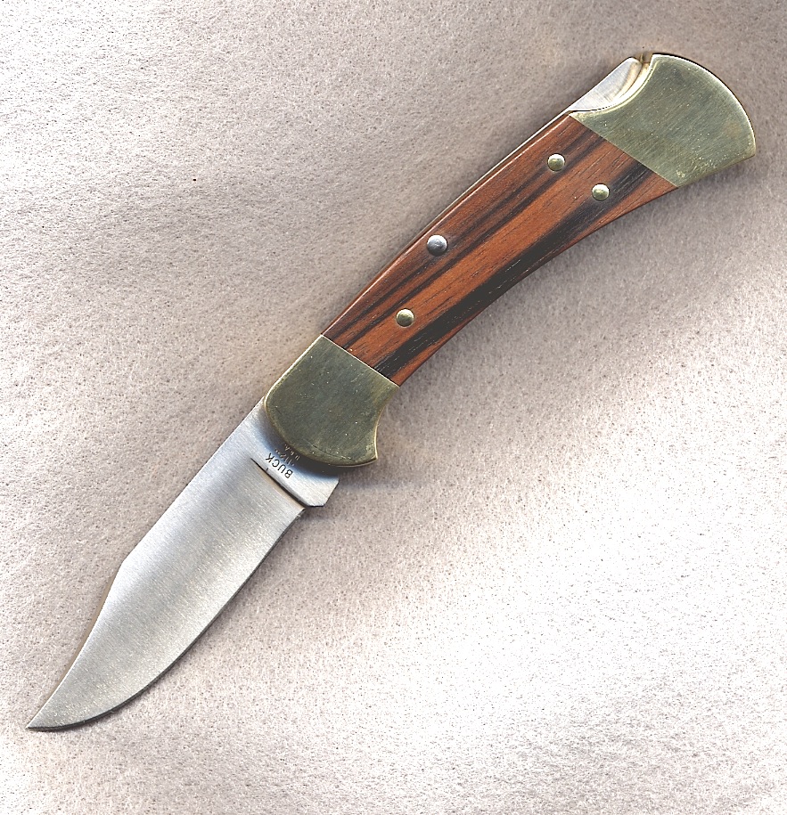

Speaking of no dots, The photos of my 110 that was given to me by my Mother-in-Law Christmas 1966 does not have any dots or other marks. It only has BUCK over 110 over U.S.A.
Think she gave it to me hoping I would fall on it.
In case anyone is wondering my avatar is a 2008 Buck 309 USA custom I picked up in SouthEast New Mexico late last year.

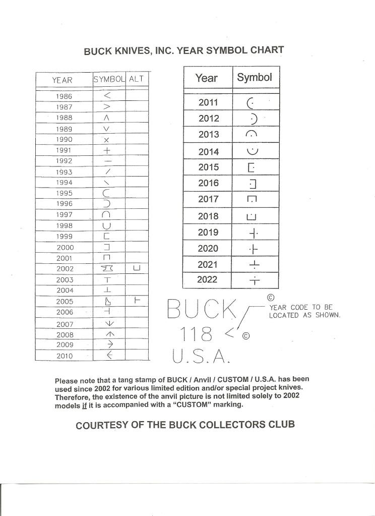

Here's the year date codes from Buck for Buck knives. Hope this helps.orvet wrote:Has anyone found out yet what the date code is for 2011?
