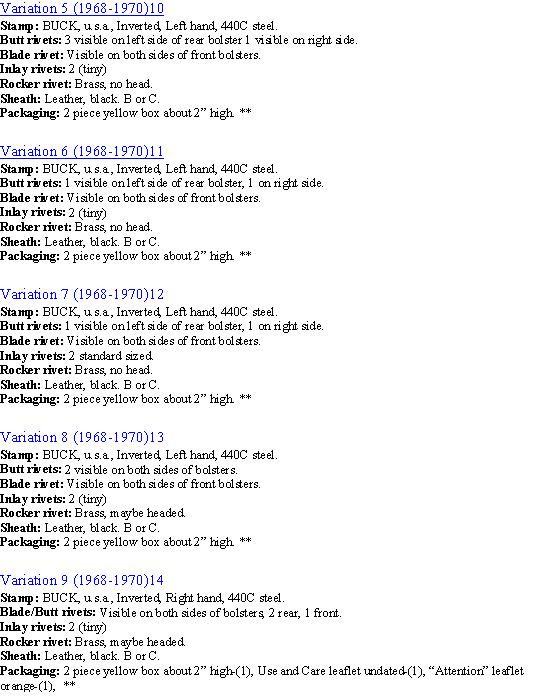

Here is the updated Buck 110 Data Sheet from Joe Houser.
I am it posting as a sticky so everyone everyone can find it easily.
AAPK Moderator

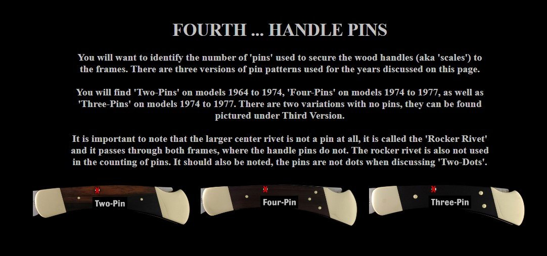

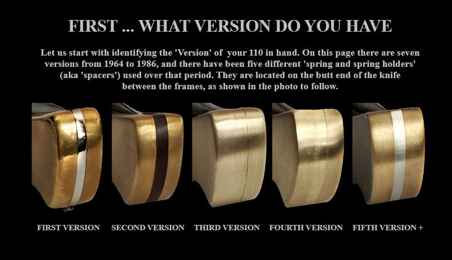

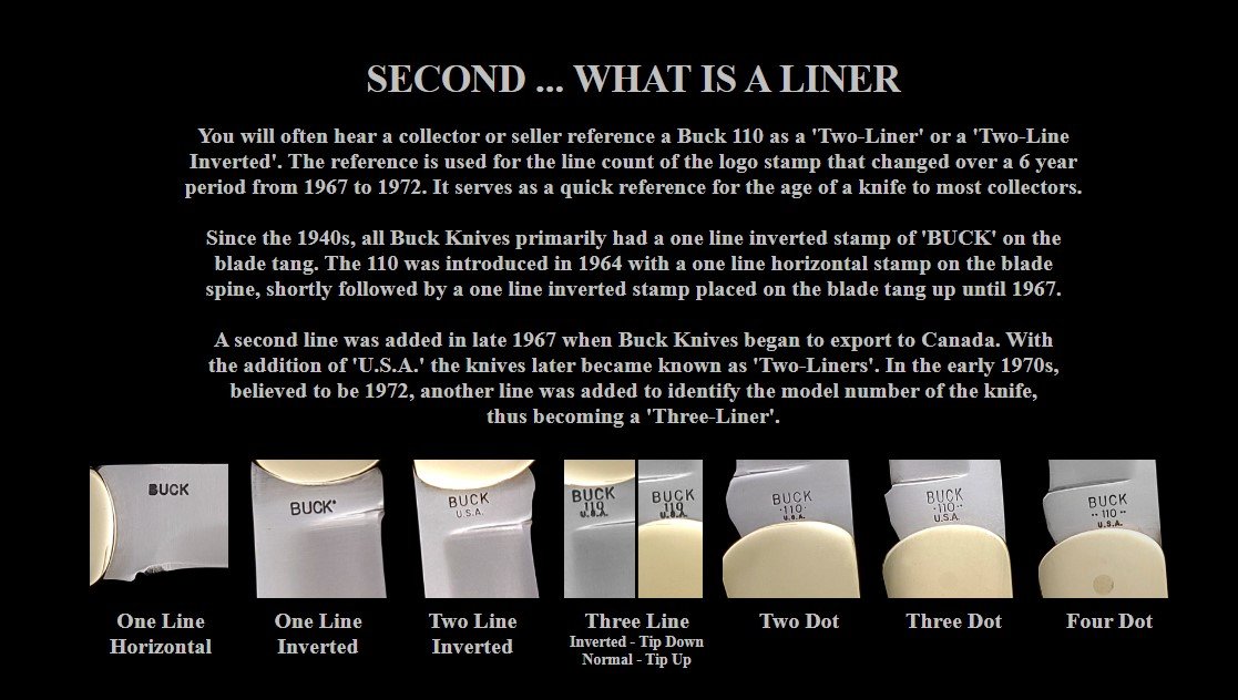

Buck 110 -1.JPG (96.99 KiB) Viewed 47482 times
Buck 110 -3.JPG (81.04 KiB) Viewed 47481 times
Buck 110 -4.JPG (89.58 KiB) Viewed 47479 times

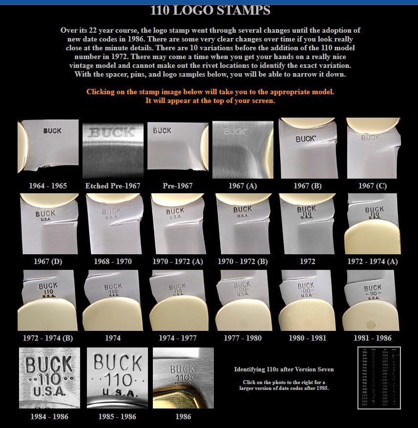

I've been following the posts but can't recall any mention of the 'small' u.s.a. tang mark. For example, I have a 110 with finger grooves tang marked BUCK/110^(inverted 'V')/u.s.a.(half the size of the standard U.S.A. Am I correct to assume that this model (came with a brown 110 sheath with brass button) is older than 1990? Thanks.
markbrower
Posts: 63
Joined: Sun Jan 03, 2010 4:04 pm
Location: Nebraska
Re: Buck 'small' u.s.a.
Post by markbrower »
scagel wrote:I've been following the posts but can't recall any mention of the 'small' u.s.a. tang mark. For example, I have a 110 with finger grooves tang marked BUCK/110^(inverted 'V')/u.s.a.(half the size of the standard U.S.A. Am I correct to assume that this model (came with a brown 110 sheath with brass button) is older than 1990? Thanks.
1988?
Hukk
Posts: 4546
Joined: Mon Mar 06, 2006 4:04 am
Re: Updated 110 Data Sheet
Post by Hukk »
1988 is correct. ^ is the date code tang marking for 1988. You can find the chart for tang markings at http://www.allaboutpocketknives.com/kni ... 53&t=11920 It's in the thread after this one called buck date code and has the years for the different symbols. I think most of the Updated 110 Data Sheet is pre 1986. Actually most of them are pre 1981 and are 440C steel. In 1981 they changed from 440C to 425M as the blade steel. 1994 I think it was they changed blade steel to 420 HC stainless. The 440C knives do get a better price.

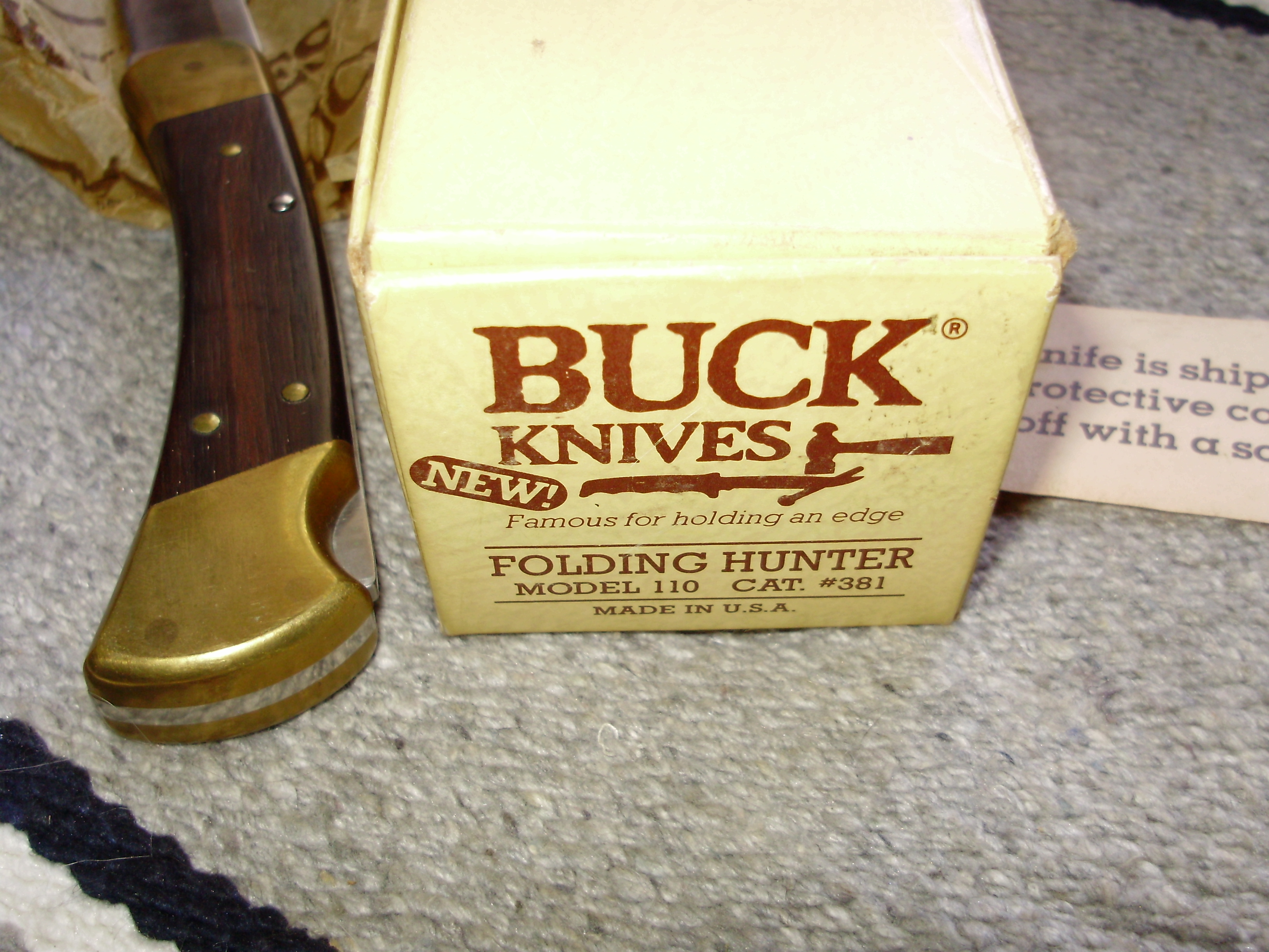

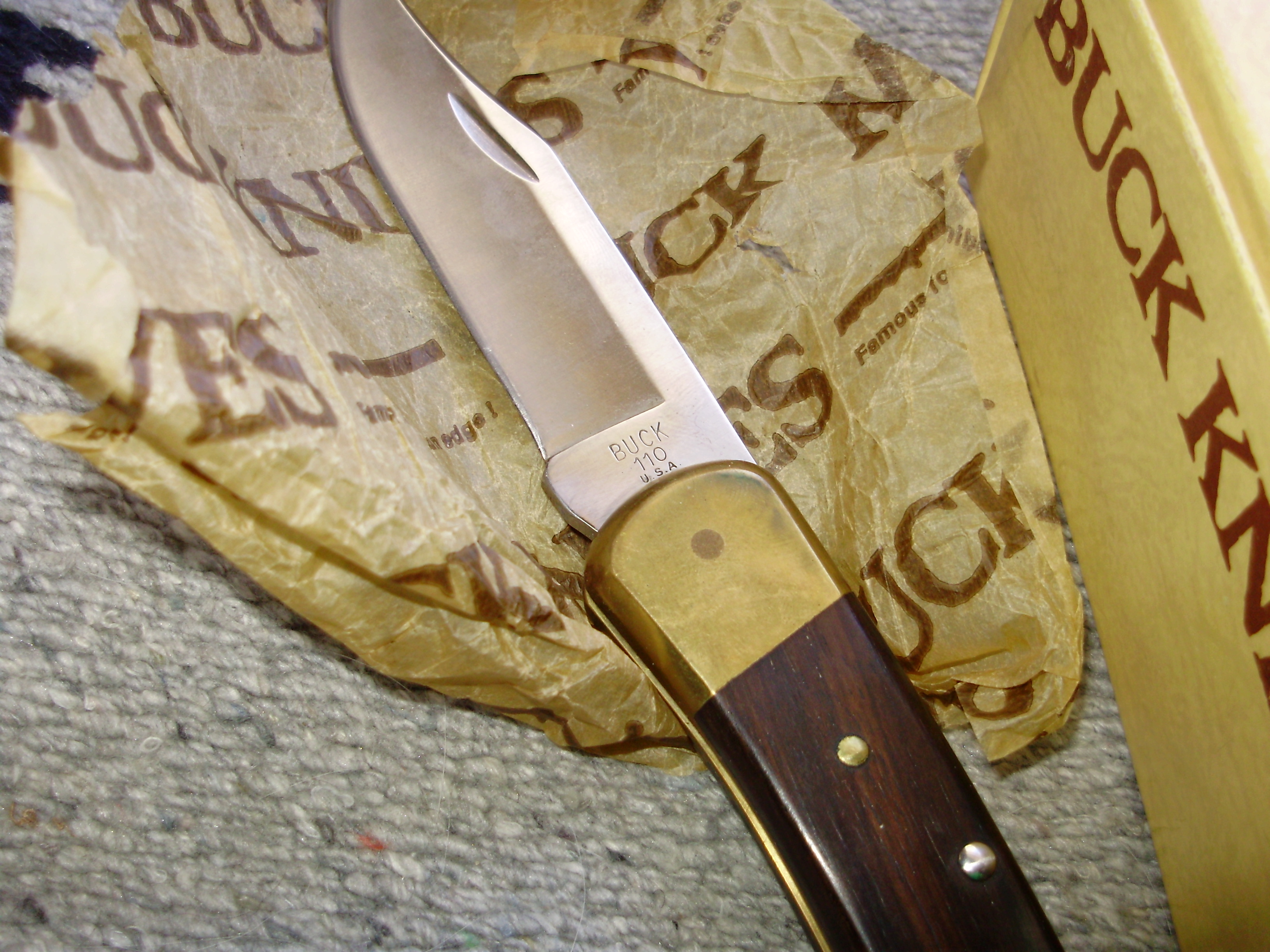

someone wanna date mine and see if im right

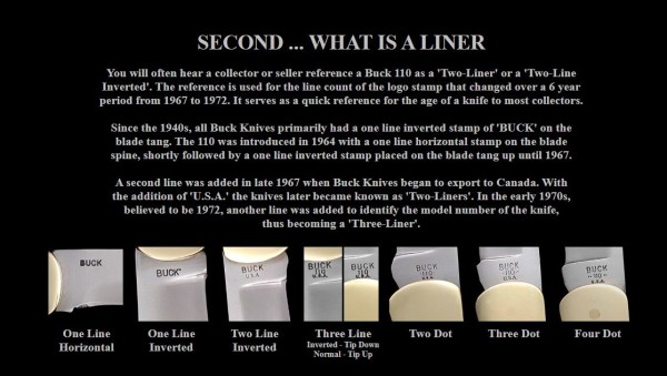

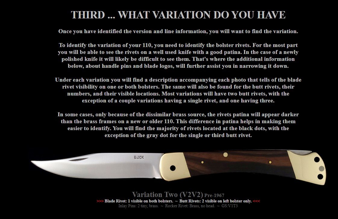

Post by kennedy knives »

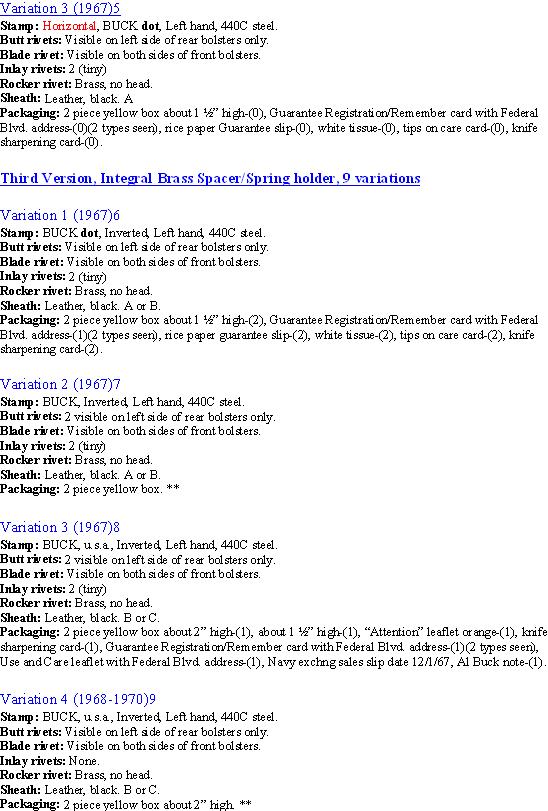

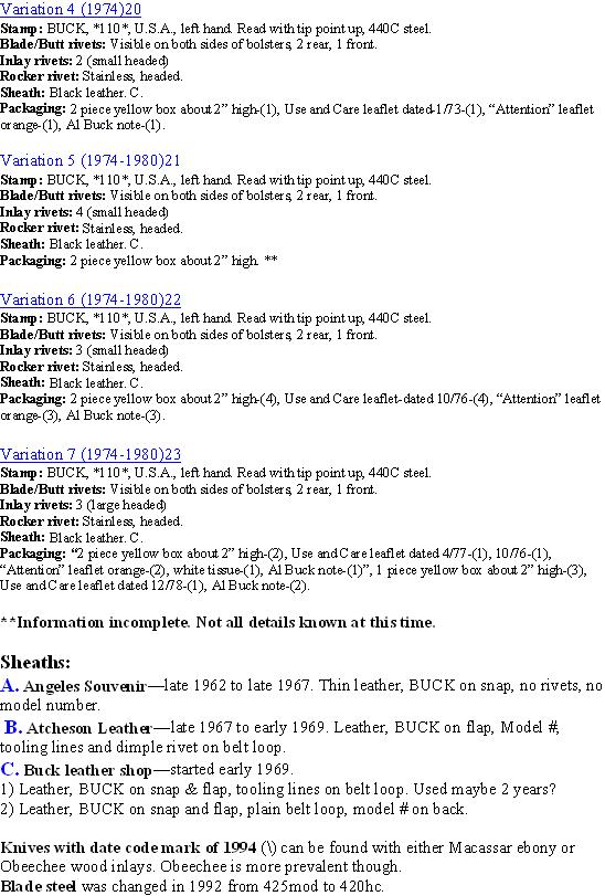

This was sent to me By My Good Buddy Mel
