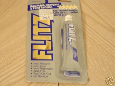

Some times I use my wifeys old nail file with a old t-shirt around it.
I use it with some FLITZ METAL POLISH.
Makes the brass shin up real good.
UP DATE --------
OLD wifey too
UP DATE --------
OLD wifey too
- Attachments
- FLITZ METAL POLISH.JPG (55.92 KiB) Viewed 8002 times
