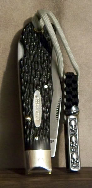

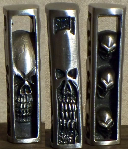

Like I said have fun with this and try variations. Here is on I made using a long bead at the bottom of the weave, the bead has a different design on all sides. To attach I simply knotted in the bead opening and melted to lock it, it is not loosening at all after a week of EDC but I may flow a good two part epoxy into the remaining gap just for good measure.

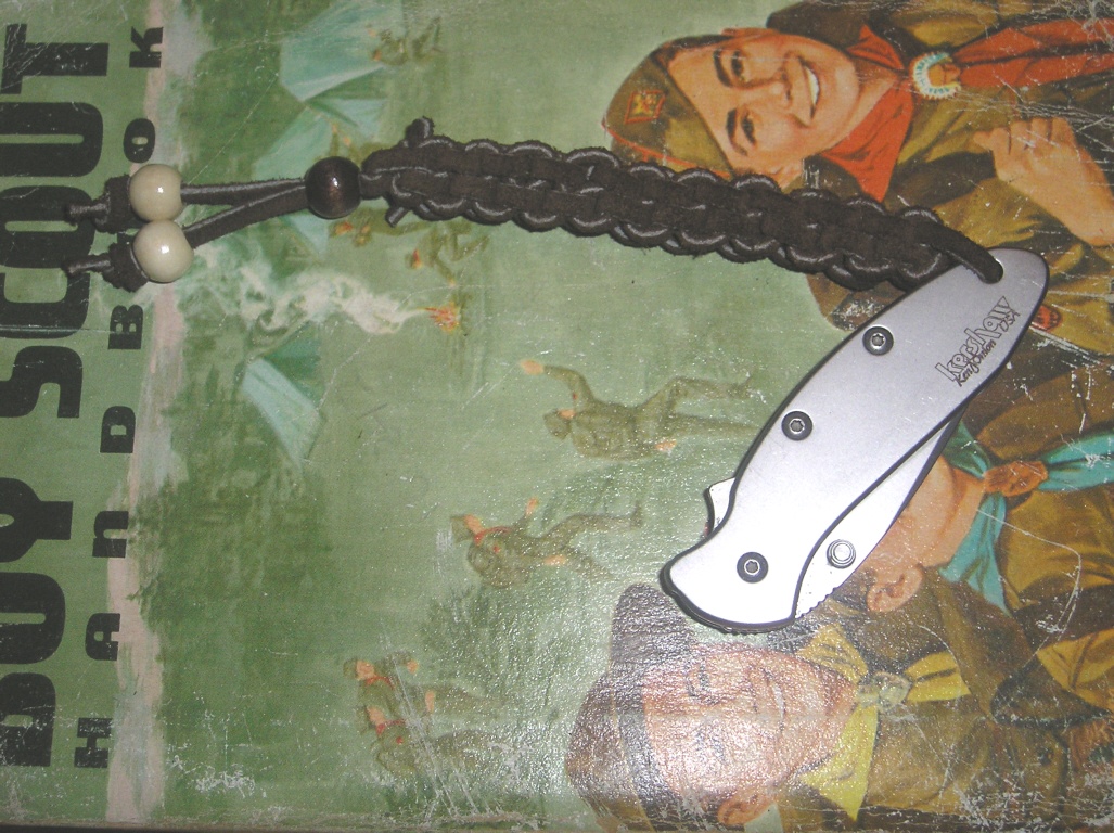

Woo hoo, I done it! ::ds::
Thanks again absintheur for a fine tutorial. I used brown leather cause I'm having a tough time finding paracord in this hick town. ::disgust::

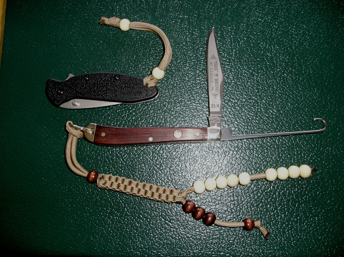

It's addictive. I just made this one with pacing beads using some genuine paracord that Junebug sent.
Nows I can keep track of how many birds I shoot and how far I had to walk to find 'em! ::nod::

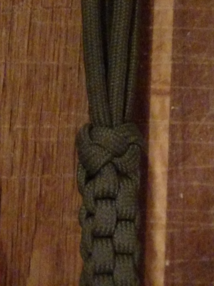

Awesome tutorial! With great pictures. To take it to the next level:
When you reach the end, tuck each end of the cord back into the knot and come out of the middle. Work your way around to the right with all four ends. It makes a Turks head and makes the ends hang straight instead of out the sides.
