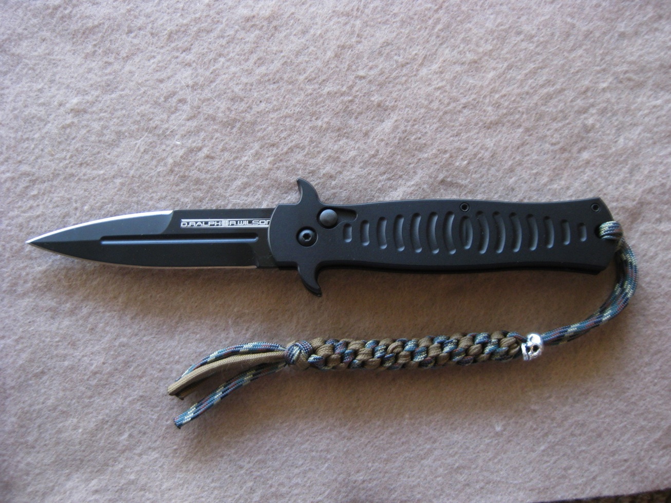

Point in case....I recently bought this auto which is a Darrel Ralph/Ryan Wilson Tactical Elite (high quality) from a member who has a AAPK store....on receiving it the spring was very weak.
I took it apart and totally redone the blade ...and snipped about an 1/8 of an inch off the coil spring and re-bent it to fit....now it works as if it were new.
How do I know it works as if new?......cause I have another...the harder to find total blacked out version...which I have always stored in the open position.
But I do agree with Bill....if its going to break...then its gonna break no matter what position you store it in.
