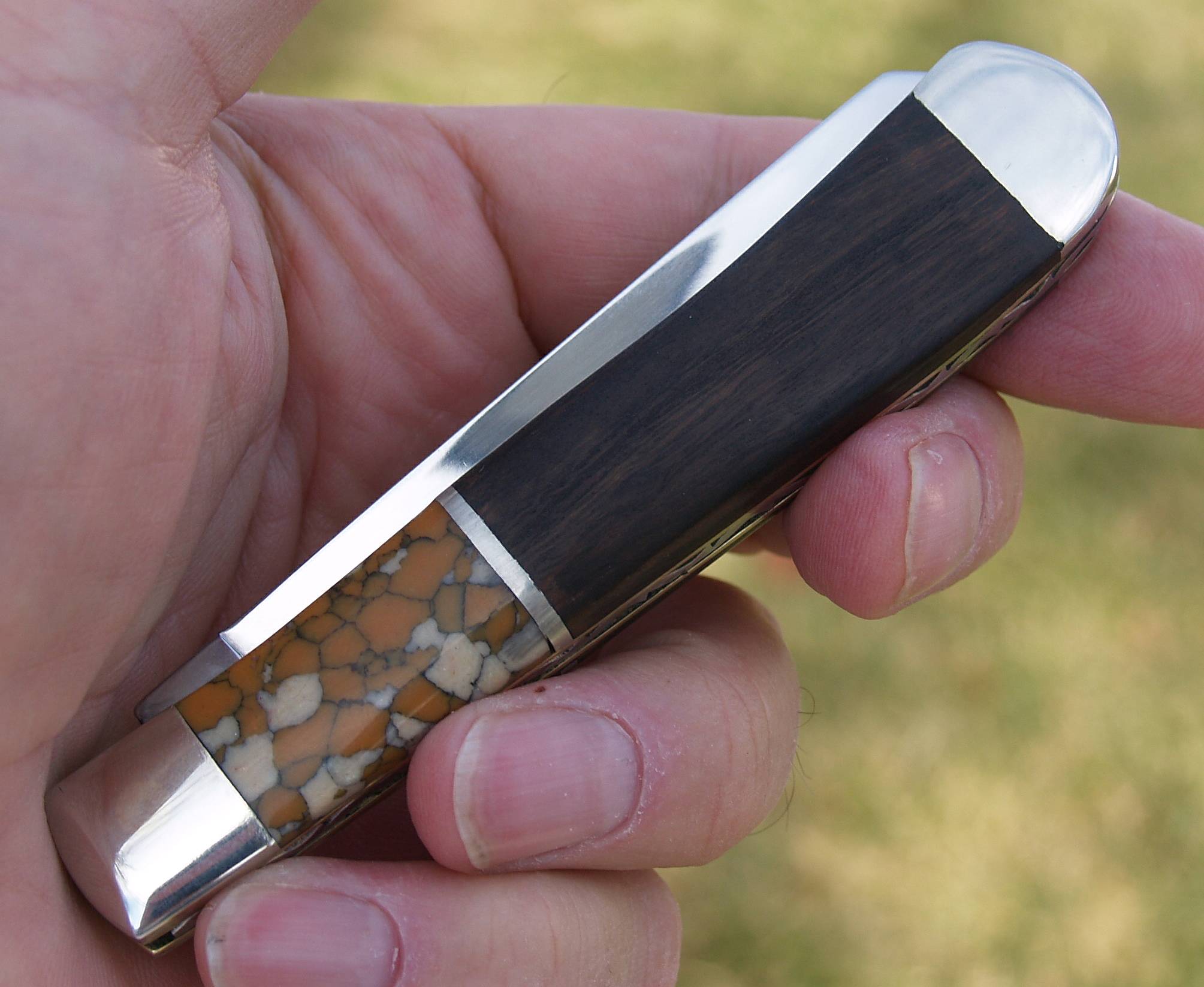

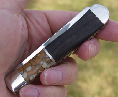

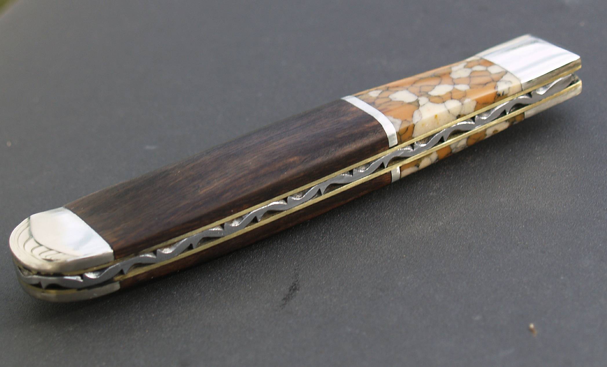

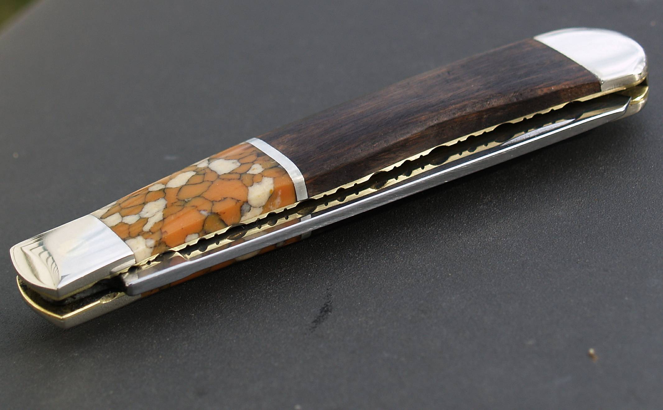

The scales I installed previously cracked so I had to tear it all off and make new. Decided to try some leopard skin recon and see what it looked like. Sanded all down w/2000 grit, buffer, and simi polish, slick but no knock out.

Phil, don't really know what I had in mind when I thought of that title but,,, YOU CAN do it! Gotta start somewhere and when you do you will be hooked to keep on doing a little bit more difficult projects. This project was NOT very bad, just cutting pieces to fit. First I figured out what part I wanted to cover with wood, cut those and temp glued in place with a small drop of super glue, then cut the nickle silver pieces to fit, glued them in place temporarily, then all I had to do was fill the gap with a couple of pieces of recon to fit the holes that were left. After they were all cut out, break them all loose (super glue has enormous peel strength but very little shear strength) and epoxy the hell out of them, clamp, and wipe off all excess epoxy with alcohol soaked swabs. I'd say the toughest job was to file and fit the mass to the frame and clean it all up. Always use enough visual magnification to see exactly what is going on and go slow. MY biggest problem was when I first started my patience would only allow me to work at this degree of intensity for about 15 mins. Now I work for about an hour then take a break. Let me know if I can help in any way as all of the guys here would. Don't be afraid to make a mistake, I just learn from them all. Sometimes I learn from them lots of times. ::tu::

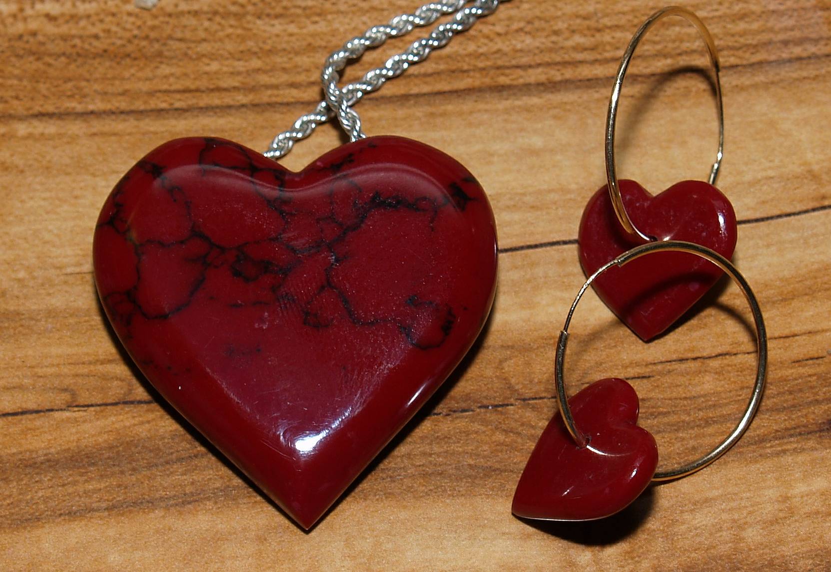

By the way, I bought some recon stone recently and got the wrong stuff. Called the company and they told me to just throw it away. Showed it to my daughter and she suggested a pendant made of the stuff and maybe some earrings and maybe a ring... Guess what? Now I have a way to give some of my efforts to girls.. All my crafstmanship has been selfishly devoted to guy stuff and now I can give something to the girls in my family. Just bought some Bloody Basin Jasper and made a Heart shaped pendant and a couple of smaller hearts for earrings which I know don't exactly fit into the knife profile of this site but gives us all a way to give to the girls. Would like to include pics but maybe not the thing to do here????? Waiting for the earring and ring mounts but have the stones cut and polished. they seem to be VERY well received by the ladies. The heart of bloody basin jasper is just beautiful and was not so hard to do. If moderators allow I will add pics to show off.
love to learn, live to learn

Attached see a pic of the pendant and earrings
