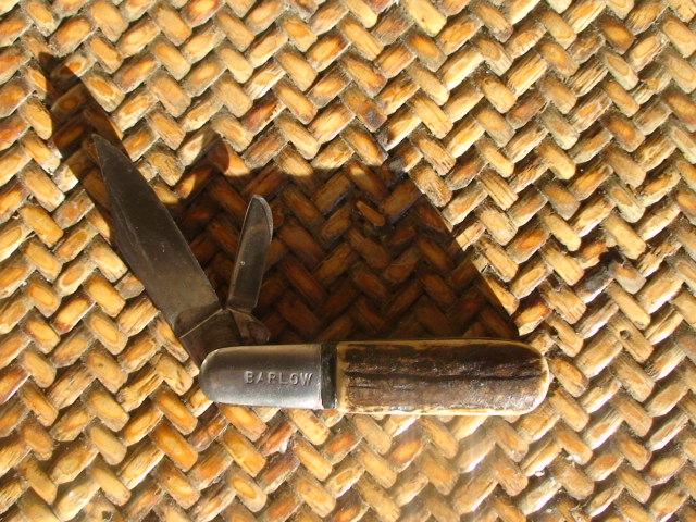

OH AND YES PIVOT PIN-here is the knife im working on. i put a pic up of it with one side some what finished. i left a piece of the origianl handle between the bolster and stag.the stag is now off again and finishe alot better.the spring im putting back in has been filed.
kutmaster barlow 2 blades. i broke a blade.the smaller of the two.
so this is also my first time trying to turn a double into a single.
later ill pic the bolster so you can see.
john i do know what your saying. pins that arent pins but made to look like.this is definetly a pin.

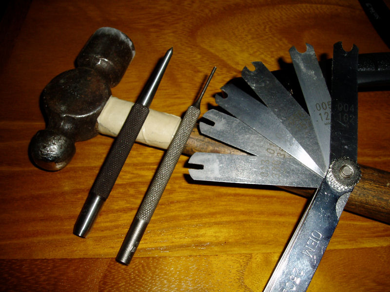

Johnnie was onto it. I figured if it wasn't the pivot that was giving you issues, it was the Tommy pin, which is basically the big plug that secures the bolster to the frame. As far as tools go, here's my re-pinning tools. I have an absurdly old ball-peen hammer (never knew what that meant until I started hanging out here :P) that used to hang in my granddad's garage. it's, I believe, an 6-8oz hammer. I used to play with it when I was little, now I play with it more :mrgreen: both the flat and the ball have been smoothed and polished, so not to leave marks.
On top of it sits a point punch (useful for marking holes, or big, really stubborn pins), and a 3/32 pin punch. Next to that is a set of cheap feeler gauges, with notches cut in them. Those you put in between the knife blade and the frame, around the pin (hence the notch) when you peen that together. the reasoning is, if you didn't use such an animal, a good tight peen would leave the blades unable to move. Using a "slackener" does just that. gives you some slack. Everyone has their own preference, depending on the knife I use anywhere from .006 to .014.
