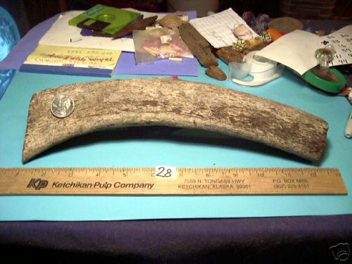

What about a pressure cooker with the dye of a strong YELLOW.
I have a bone I could send you. You cut it for some scales. Place it in the pressure cooker.
Now you know I love lemmone YELLOW.

That Stellar Sea Cow bone is well over 250 years old. They went extinct in the late 1700's just about 30 years after they were first discovered. Dying with Rit dye is tricky - you don't always get the color you start out with. So you need a supply of the same bone to experiment with.
