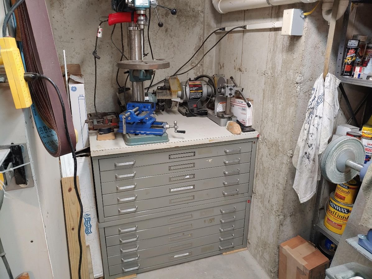

Due to the excessively hot weekend here, I planned some indoor basement projects. One of them was reworking an area in my shop where I have my drill press. It was sitting on a random bench with metal legs, and was just a gathering spot for junk.
I happened on these plan drawer units which were being tossed from our work. I took the table top from the old bench to put on the units.
The drill press sits a bit higher than I would like, but it's still usable. I now have all my handle materials and some other misc. knife stuff sorted in the drawers, with the bottom unit still left to fill with "stuff".
I would have rather used these for knife collection storage, but I won't do that in my basement, and these are too large to put anywhere else in the house.

I had a chance to get some of those a few months ago. I didn't have a place for them at the time but you are right....
They sure would make a great knife storage.
The ones I passed on were for 24" x 36" drawings. With some dividers in them, they would have been NICE.
Oh well......
Oh well......

WOW Glenn, I love those plan drawer units! I think I could get most of my new parts and a lot of the used parts in the unit, that's outstanding.
I'm trying to do a refurbish in my shop also, I bought a double door metal storage unit that I can put a lot of stuff in. I just have to rearrange all the junk in my shop so I can get it in their. I have to get my table saw out of the knife shop and put it in the shed, and make some room. I have a antique jigsaw that belonged to a great uncle from the 1930s, it has a huge cast iron base and must weigh at least 200 pounds. He also wants a lathe that my dad gave me, but I have no place to use it. I'm really anxious for my brother to get all of this stuff so I can get things in my shop rearranged so the space is better utilized.
I love that plan drawer, you can put so much stuff in that would take up so much room otherwise! Nice snag!

Thanks! That's the problem in my shop also, it's not just a knife shop. It's a catch-all for any of my hobbies. I have small tool chests in there, all my wood working and hand power tools, wire, cable, etc. The list goes on and on. I do temporarily have my table saw moved to the shed, as I was using it on my kitchen reno project. Amazing the extra space I have with that not being there!orvet wrote: ↑Mon Jul 20, 2020 4:06 pm WOW Glenn, I love those plan drawer units! I think I could get most of my new parts and a lot of the used parts in the unit, that's outstanding.
I love that plan drawer, you can put so much stuff in that would take up so much room otherwise! Nice snag!![]()
I also have a blanket chest in my shop that I have been building for the last 15 or so years, LOL. I'm really not too far from completing it, just need to shift gears to work on it (sometime)
