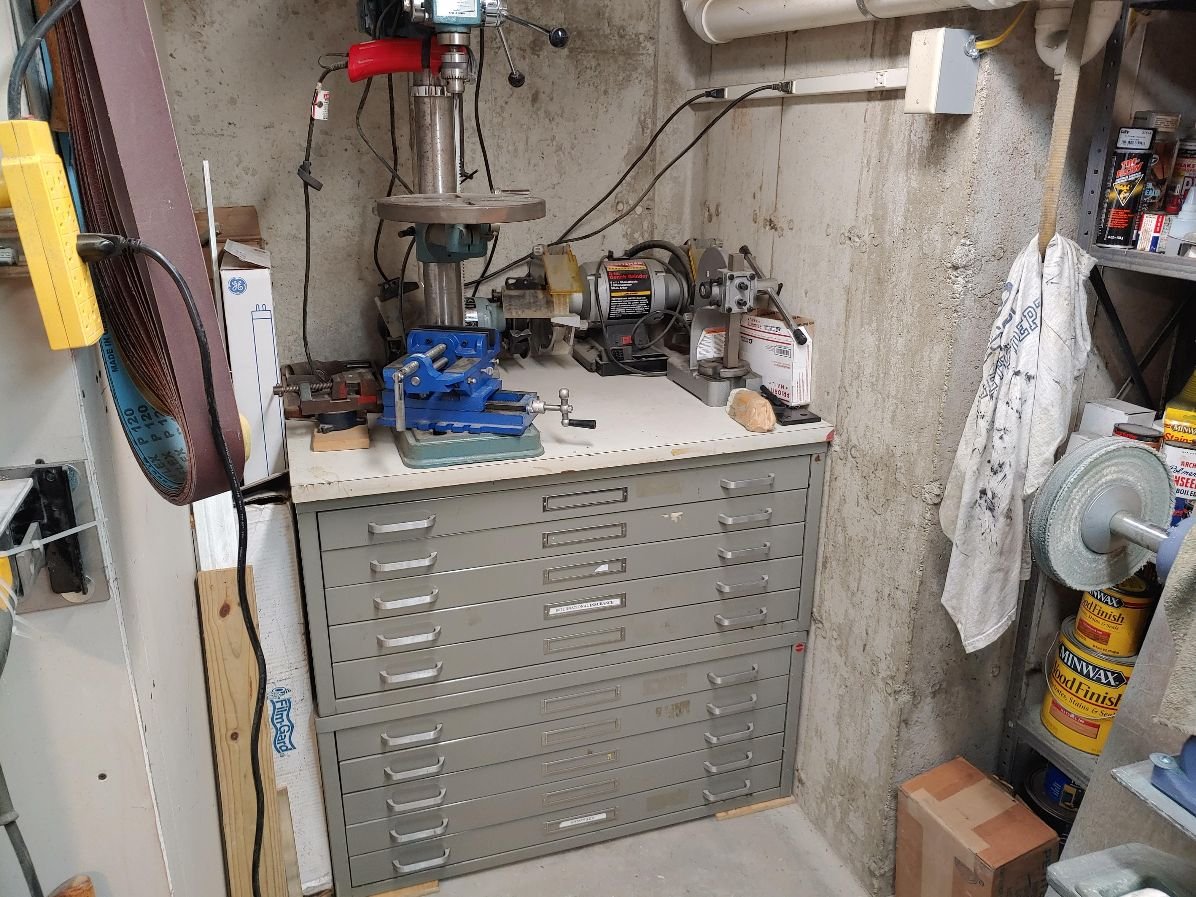

Due to the excessively hot weekend here, I planned some indoor basement projects. One of them was reworking an area in my shop where I have my drill press. It was sitting on a random bench with metal legs, and was just a gathering spot for junk.
I happened on these plan drawer units which were being tossed from our work. I took the table top from the old bench to put on the units.
The drill press sits a bit higher than I would like, but it's still usable. I now have all my handle materials and some other misc. knife stuff sorted in the drawers, with the bottom unit still left to fill with "stuff".
I would have rather used these for knife collection storage, but I won't do that in my basement, and these are too large to put anywhere else in the house.

I had a chance to get some of those a few months ago. I didn't have a place for them at the time but you are right....
They sure would make a great knife storage.
The ones I passed on were for 24" x 36" drawings. With some dividers in them, they would have been NICE.
Oh well......
::doh::

WOW Glenn, I love those plan drawer units! I think I could get most of my new parts and a lot of the used parts in the unit, that's outstanding.
I'm trying to do a refurbish in my shop also, I bought a double door metal storage unit that I can put a lot of stuff in. I just have to rearrange all the junk in my shop so I can get it in their. I have to get my table saw out of the knife shop and put it in the shed, and make some room. I have a antique jigsaw that belonged to a great uncle from the 1930s, it has a huge cast iron base and must weigh at least 200 pounds. He also wants a lathe that my dad gave me, but I have no place to use it. I'm really anxious for my brother to get all of this stuff so I can get things in my shop rearranged so the space is better utilized.
I love that plan drawer, you can put so much stuff in that would take up so much room otherwise! Nice snag! ::tu::

orvet wrote: Mon Jul 20, 2020 4:06 pm WOW Glenn, I love those plan drawer units! I think I could get most of my new parts and a lot of the used parts in the unit, that's outstanding.
Thanks! That's the problem in my shop also, it's not just a knife shop. It's a catch-all for any of my hobbies. I have small tool chests in there, all my wood working and hand power tools, wire, cable, etc. The list goes on and on. I do temporarily have my table saw moved to the shed, as I was using it on my kitchen reno project. Amazing the extra space I have with that not being there!
I also have a blanket chest in my shop that I have been building for the last 15 or so years, LOL. I'm really not too far from completing it, just need to shift gears to work on it (sometime)
