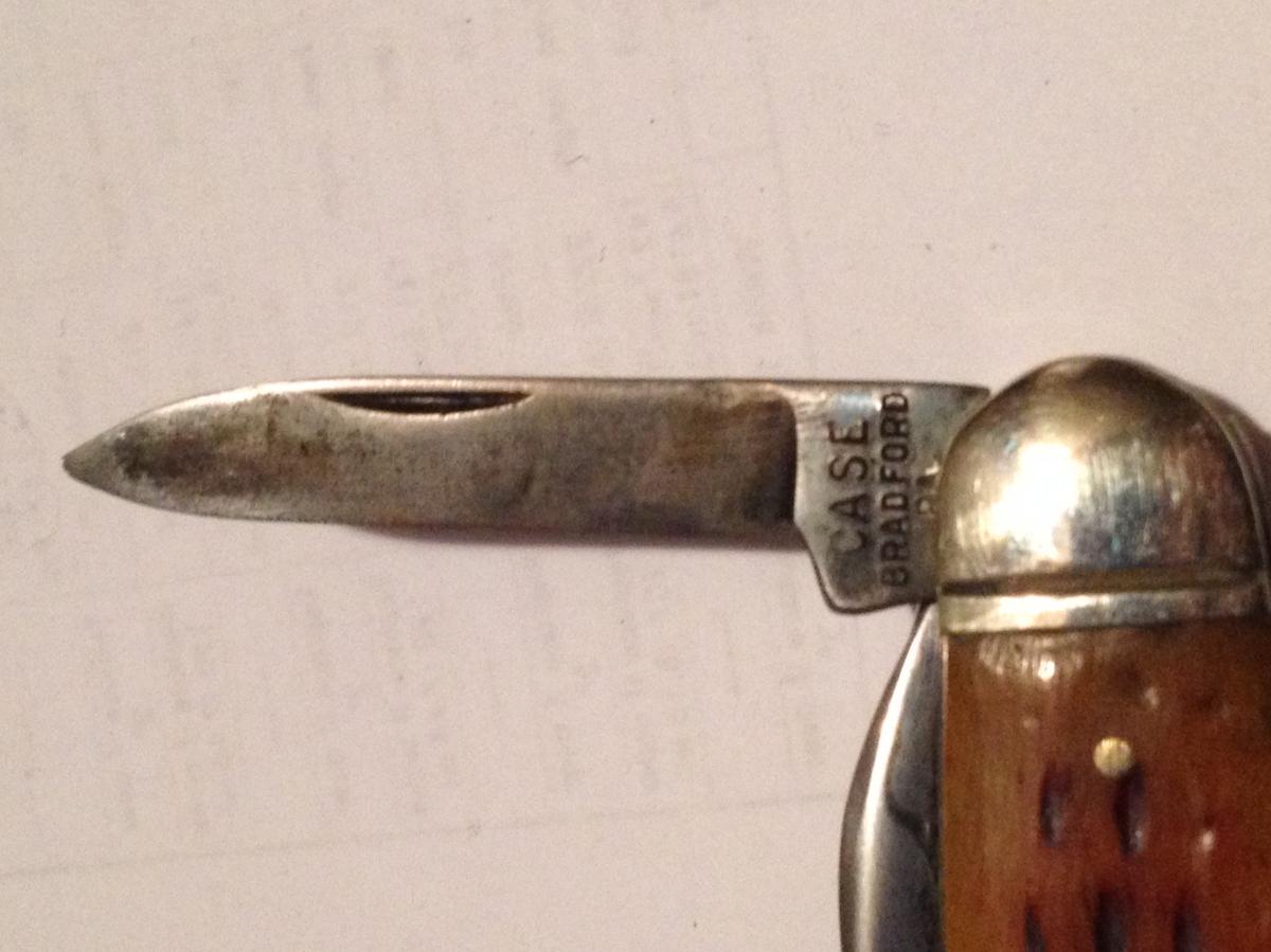

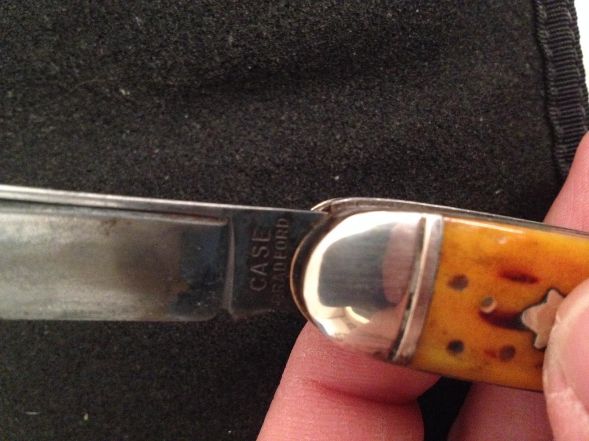

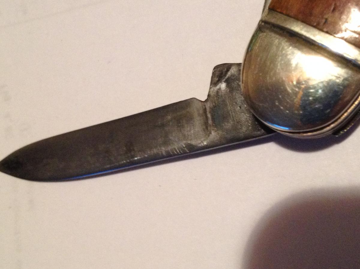

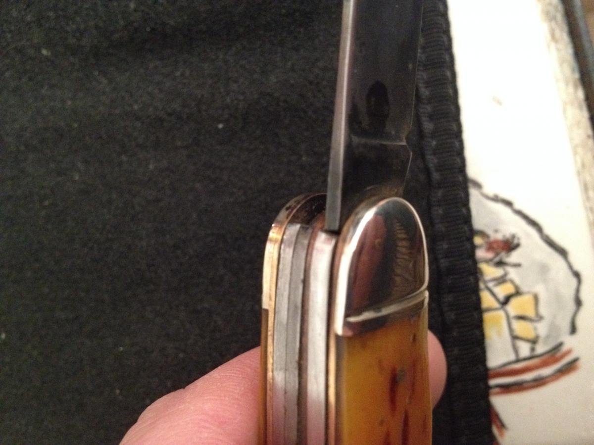

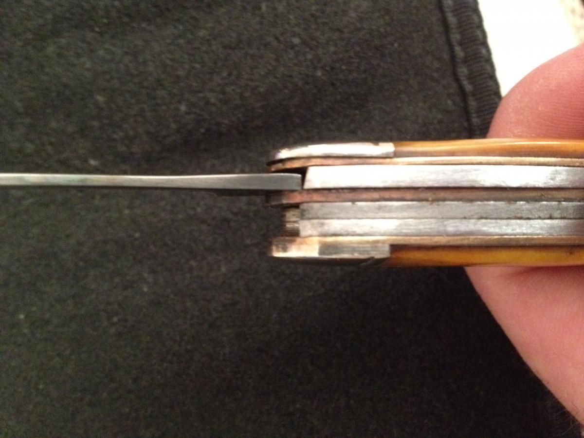

Phil,the Blade when open it is setting at an odd angle.Also it appears to set well above the backspring when open.Got to go the preacher is getting ready to stoke the coals.

These are the clearest and closest shots of the main blade spring joint. It has an angle to it where all the other joints are flat. I was up late last night looking at any example of these I could find, but they were all the valley forge versions. I never could find an actual Case Bradford Pa stamped version. I found different blade styles and combinations, but again it was all VF versions.

The latest pics don't look good from an authenticity and "original" standpoint. Tang thickness should be same as backspring among other things in relation to the pictured joint. Angle, overall fit, spring raised when fully open, etc all indicate that knife has been apart to me and blade or spring not original or altered. No expert but observed and own quite a few old CASE. Not convinced that is worn CASE bone or worn shield either.
Not trying to be dark cloud, just my opinion.

A good case to learn to read the knife and not what the stamp says.Blade has been changed and a poor job of it.Another thing that stands out is the master blade is very full compared to the wear of the rest of the knife.

No worries guys. I'm actually happy to be better educated. Maybe it stings less because I ended up getting it in an insane deal where I came out way ahead on the rest of the batch. Maybe it will save me (and possibly someone else) some future heartache on another deal. I do still enjoy the knife very much, so it still feels like a win to me.
Thanks for the information. I didn't come across much doing my own research on the web that was definitive, and I don't own any knife books to reference, so it's nice to have people in the know to turn to.

I think the OP or following stated both blades were stamped the same.
Can we see pics of the smaller blade, please?
It's my understanding that Case did offer this pattern, although I seem to recall some controversy over that some years ago.
If Case did make or market such knives and the pattern number on the other posted above indicates that is so, then just because the master on the OP knife has been replaced (and I agree that it has), doesn't necessarily mean the knife is not a Case product.

I will snap some close up shots of the small blade and get them on here. I do want to say though, that I've dug around on this site on occasion for months now, and the reason I decided to join was the way that people carry themselves on here. It's the only forum that I have ever visited where people treated others as if they were still people, and not like they do on other sites where they act like there are no consequences due to the anonymity of the internet. I appreciate that about this site, and the people on it. We all stick our foot in our mouth on occasion, but it shouldn't keep us from sharing the information that we do know. I for one don't mind being redirected towards what is true as long as it's done respectfully.

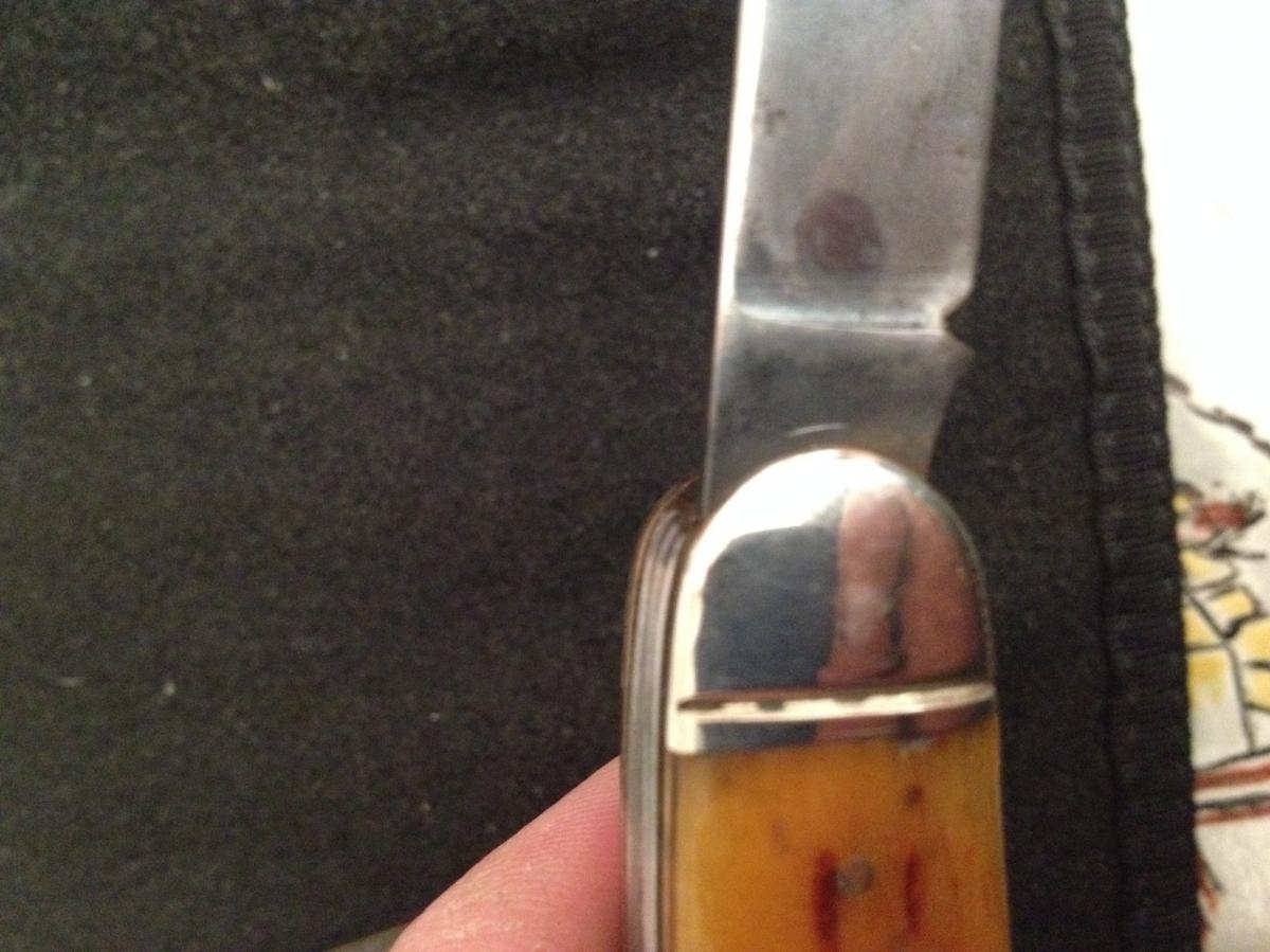

These are close up on both sides of the small blade. The back doesn't seem to have any type of model stamping or mark.

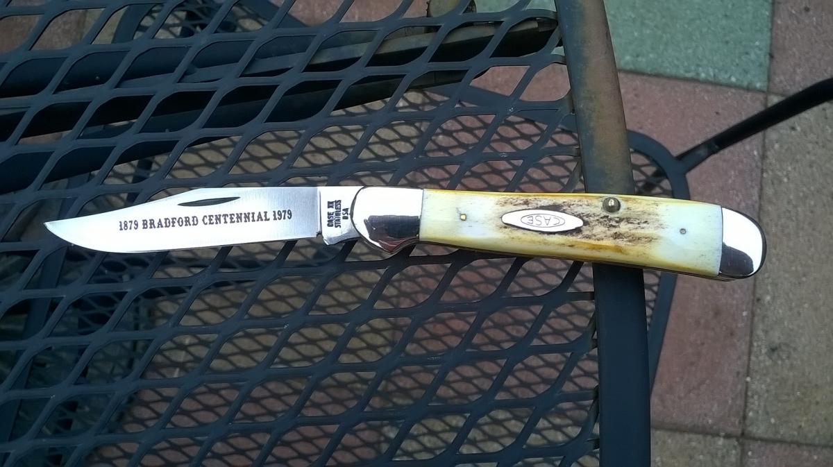

Re: VINTAGE CASE FOLDING KNIVES

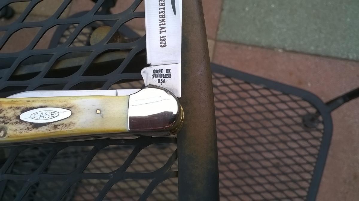

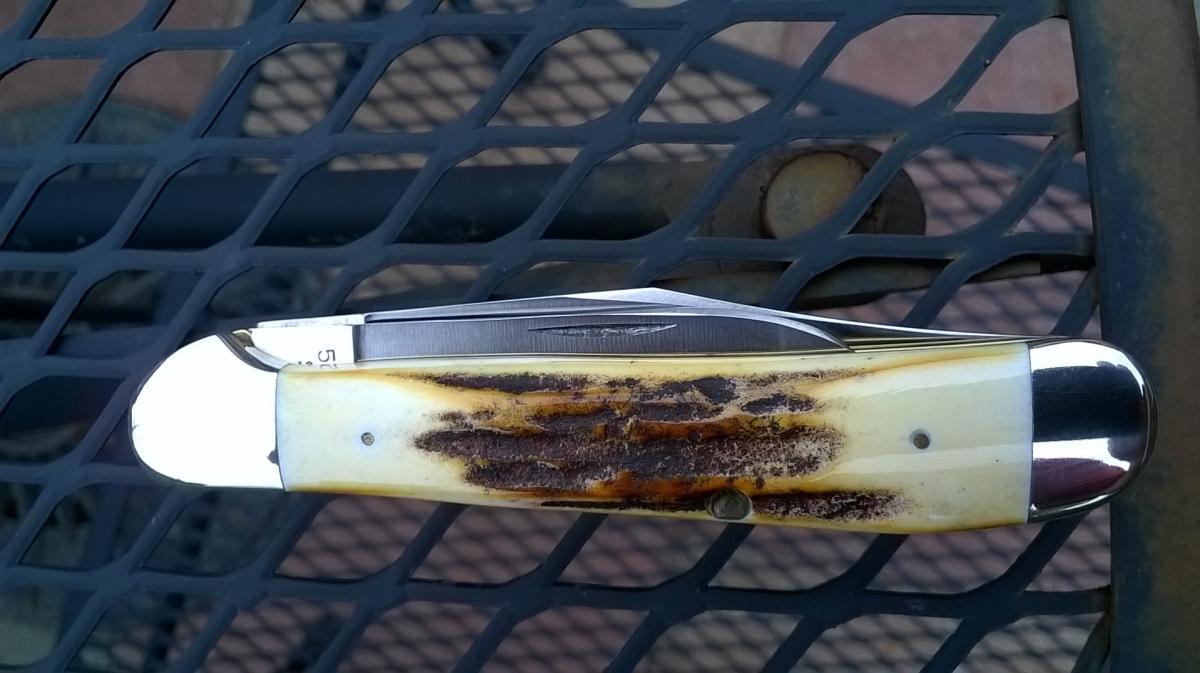

1979 Copperhead hundredth anniversary. Sweet everything, especially looks, action, fit, finish, transitions, flush, snap, blade configuration, feel, heft, antler.............
timgreene48
- Posts: 621
- Joined: Tue Nov 29, 2011 6:28 pm
Ivoryman that is a beautiful copperhead!!
Ivoryman
- Posts: 9551
- Joined: Tue Jun 02, 2015 4:20 am
- Location: Seattle, WA
Thanks timgreene, it's a really sweet knife all around, and beautiful, but really bigger, wider and heavier than I thought it would be. Not the most pocket friendly, but great knife shelf material.

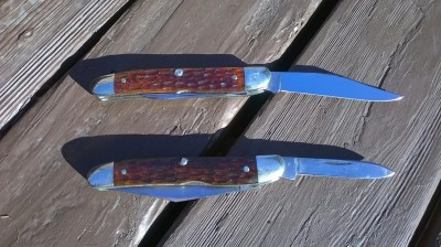

Been carrying Beer Scouts, Whittlers, Viper, Barlows, and bigger stuff lately. Picked this '40-64 Serpentine Jack yesterday and was amazed how light and unnoticed in the pocket compared to all those. Two blades too. Lighter than a lot of my single blade folders. Love these oldies.

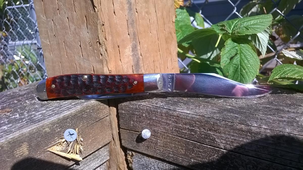

'64-69 Case Swell End. Sixties were great for some things.

In regards to Dradian's Case pliers knife:
Maybe a dumb question, but, any chance the blade is original and a broken backspring has been poorly replaced? The angled (not square) end of the backspring, where it meets the main blade, does not look to me like something Case would have let go?

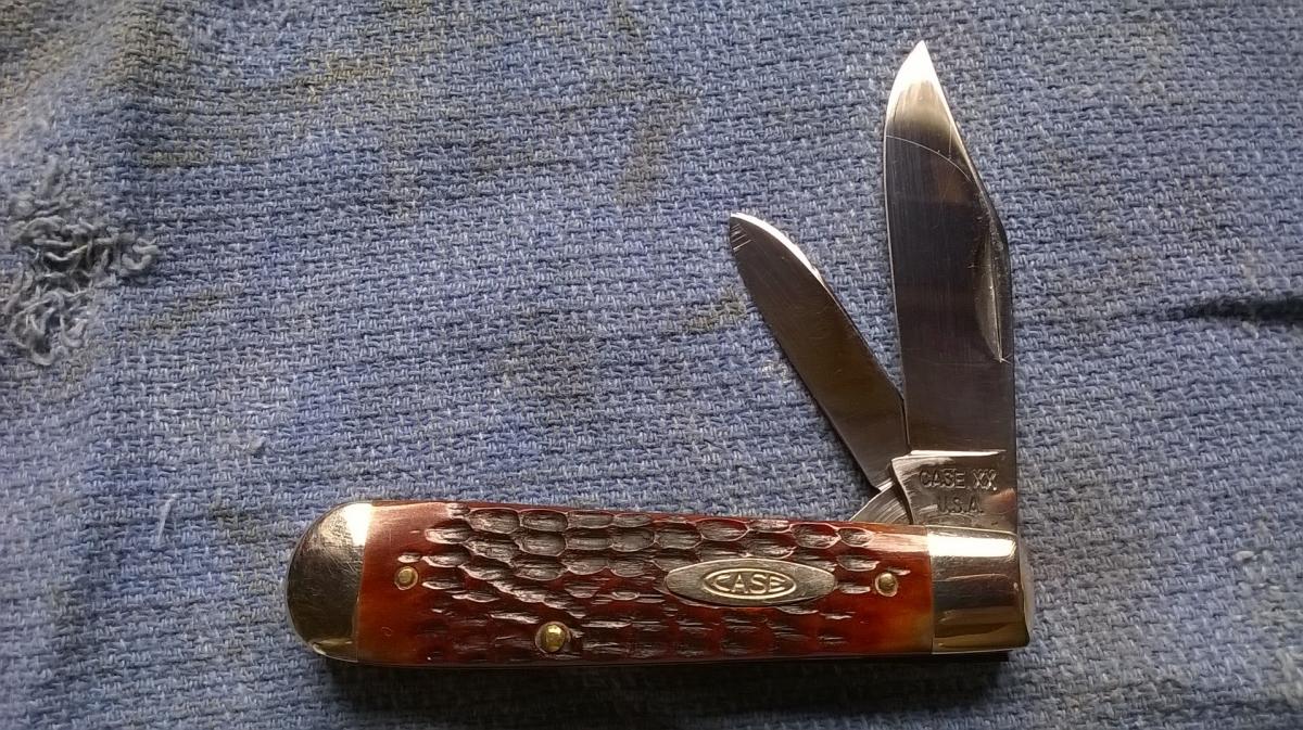

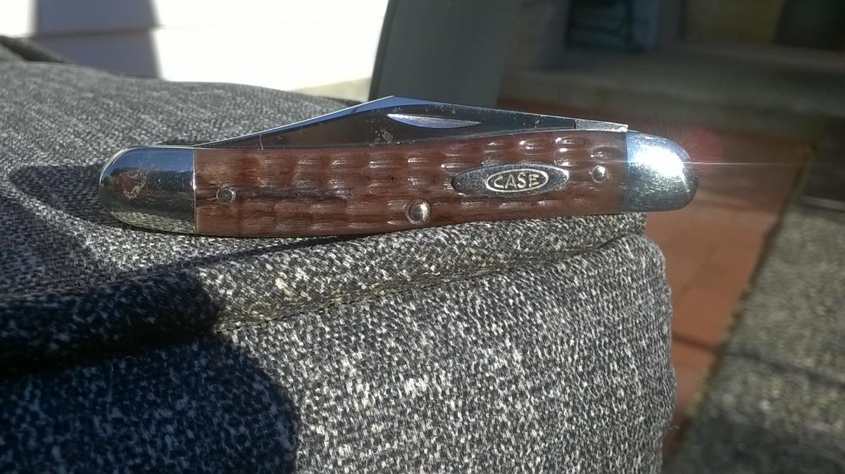

Ivoryman nice knives

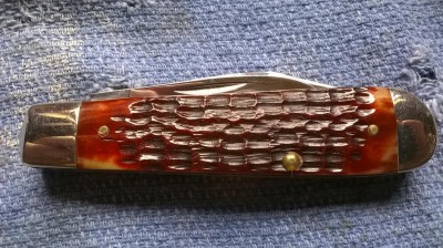

I like this little red bone Case knife.

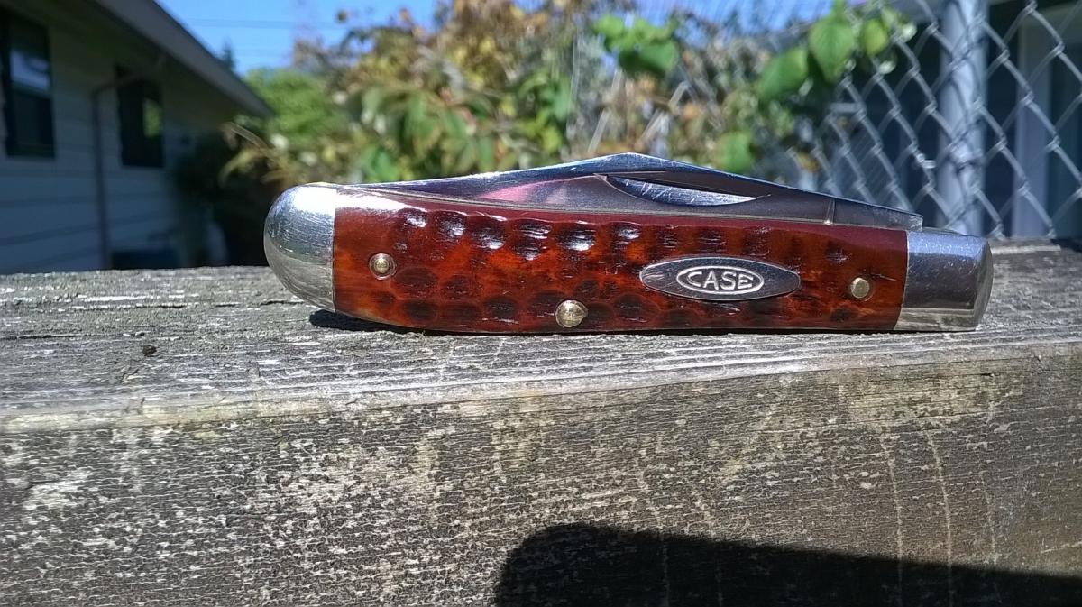

Re: Vintage CASE Folding Knives
'65-69 Case Mini T red bone Clip/pen
- steve99f
- Posts: 2852
- Joined: Mon Sep 16, 2013 9:49 pm
- Location: Eastern PA
That 35 is a beaut! Really good coloring in that bone. Some great old knives in this thread. Thanks for sharing guys.
