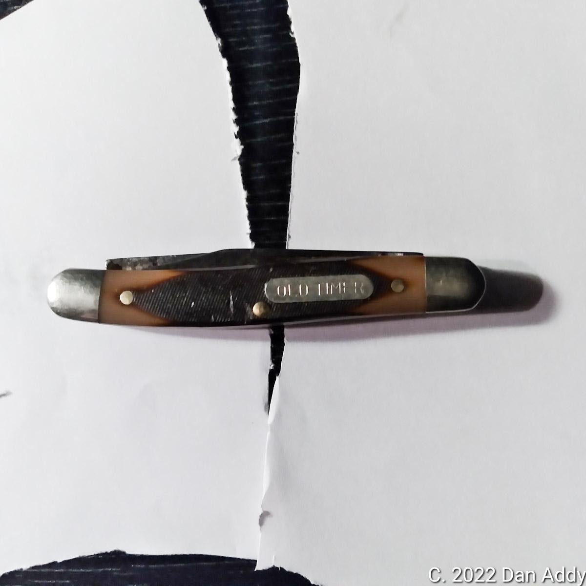

After many whacks across both stone and strop, here's where the 104OT stands:
One side of the blade has a better edge that the other. My guess is that I still need to develop the required muscle memory. Seems the 104OT wouldn't have really benefitted from being dragged across the coarse stone. Though I did notice that the coarse stone absorbs oil very quickly; why, I don't know.

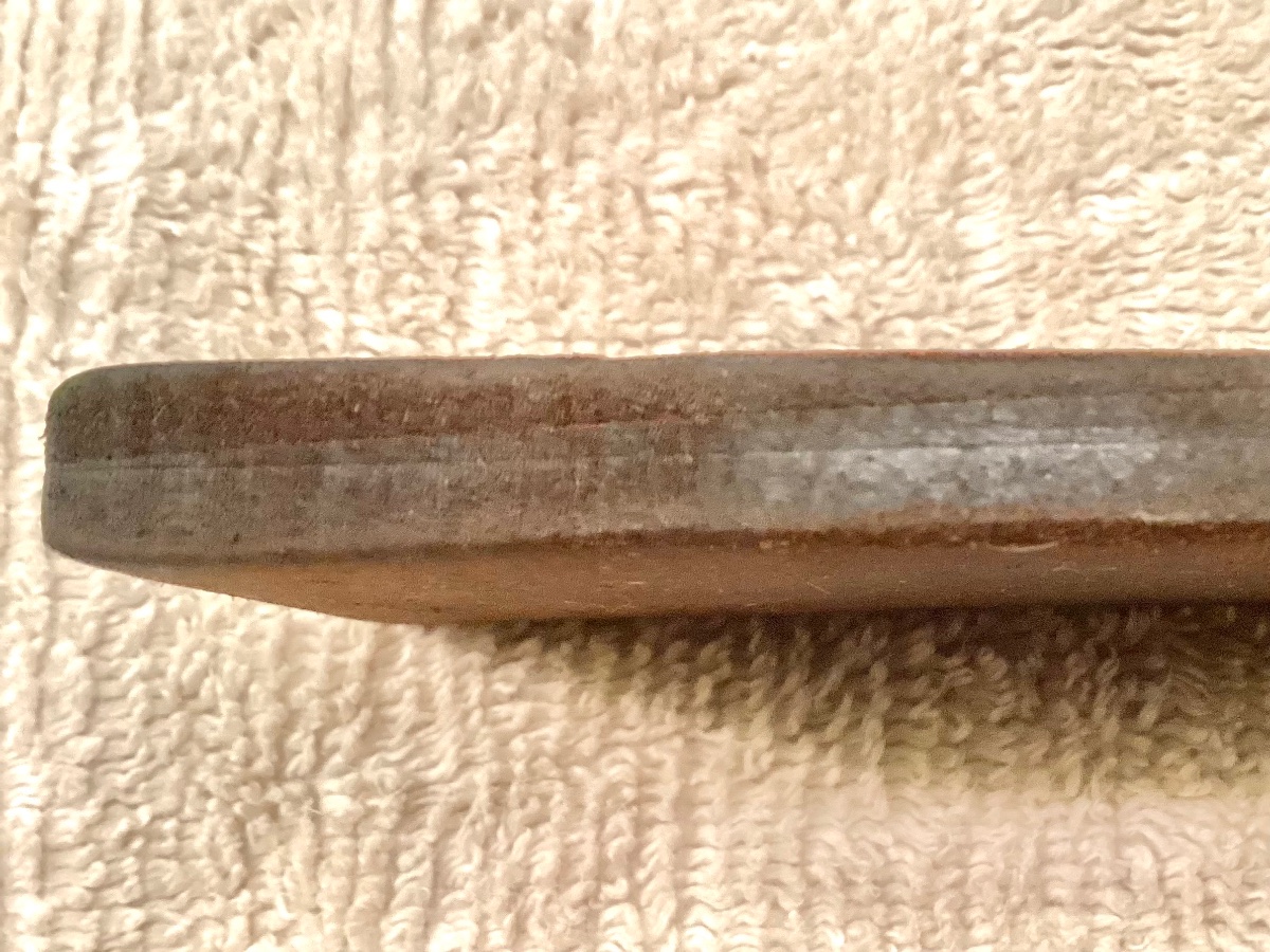

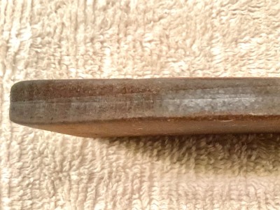

The coarser stone is more porous - hence the larger grit, so it is more absorbent.
I’ve not heard that about stones before. You and cudgee are giving me an education! All of mine are carborundum, or natural (Arkansas). When I changed to water I just scrubbed them thoroughly with a stiff brush in hot soapy water as when cleaning them. Rinse well and start using them with water. If it makes any difference I’m ignorant of it (along with many other things)! :lol: I have a few older stones that have never been used with anything other than oil though. I just don’t use them any longer, or never did use them much to begin with. Sorta like knives and holsters - got more than I need. ::doh:: Although they do sell them I’ve never owned a “water stone” specifically made for use with water.

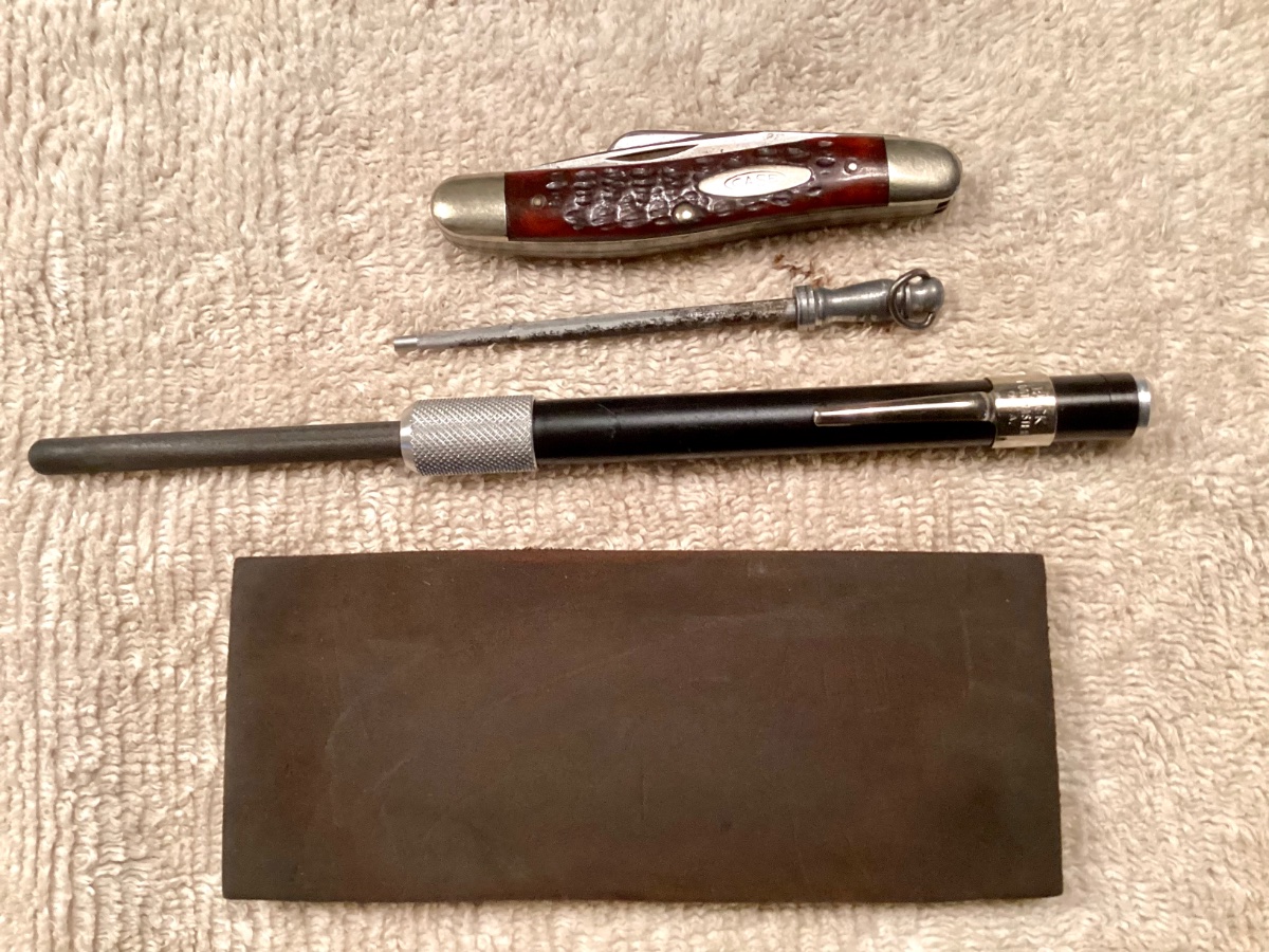

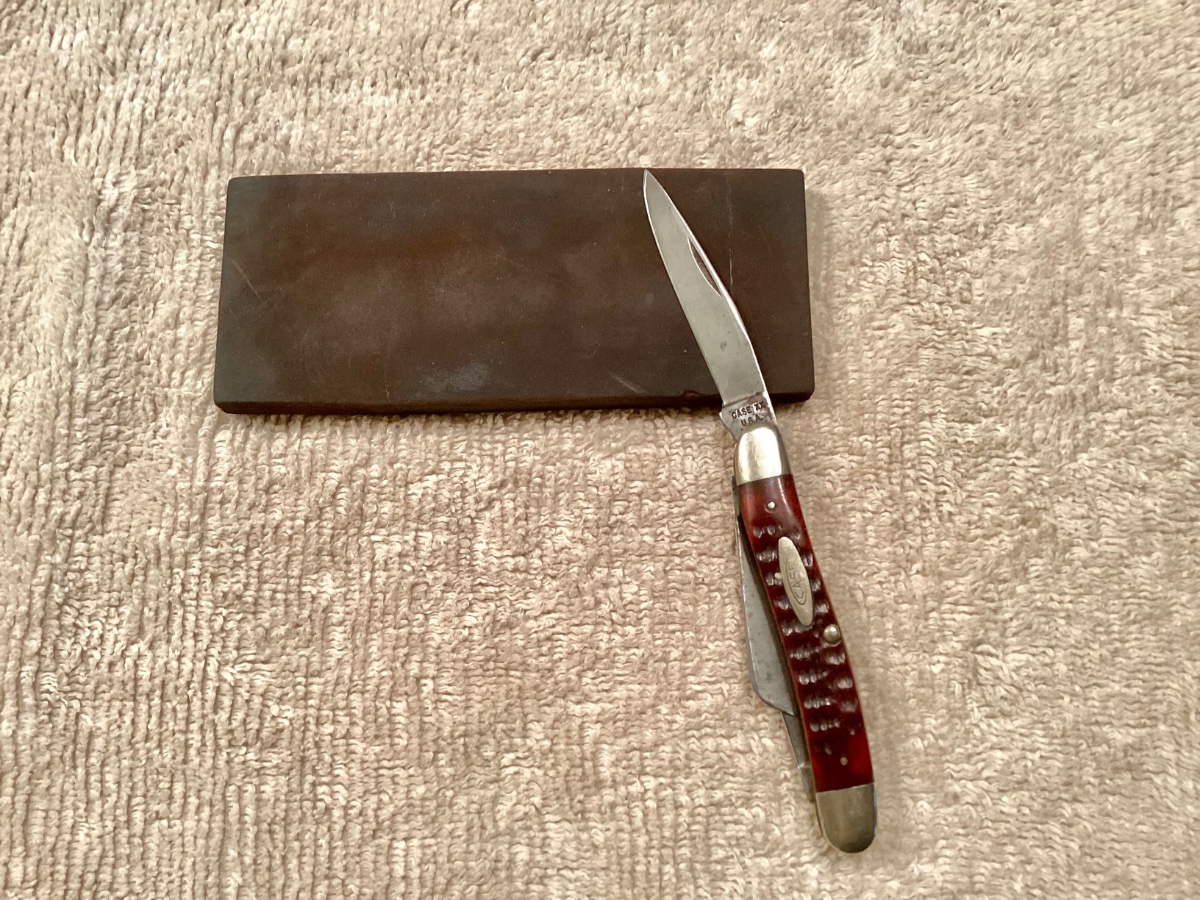

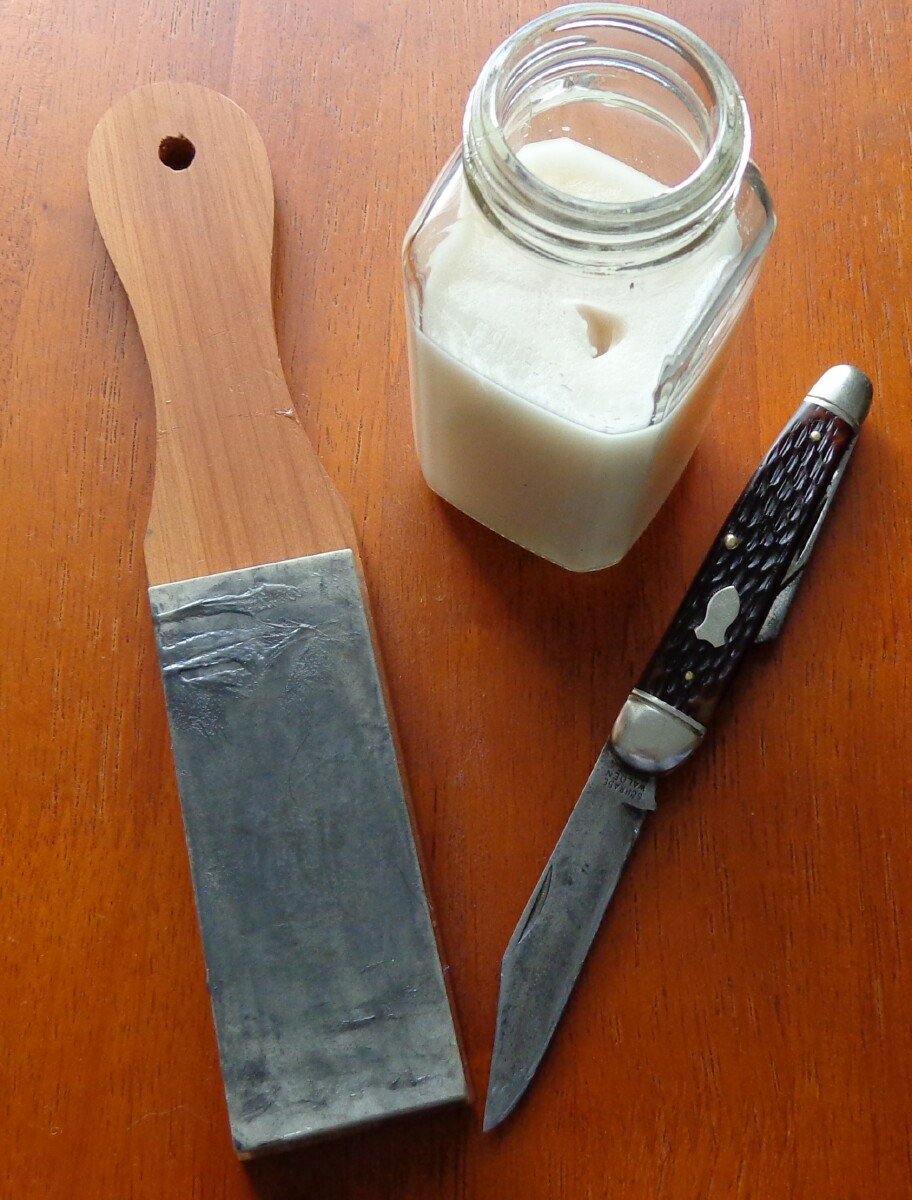

Okay folks, since you asked here are some pictures of the leather “strop” piece made from an old conveyor belt. I took a picture of the edge also, hope you can see how it is laminated from multiple thin pieces of leather. It’s about 3/8ths of an inch thick total. I don’t use any compound with it, but it does have some kind of natural “oil” that comes to the surface with use. It doesn’t puddle there but you can see moisture on the surface as you’re stropping. Maybe from years of use either in the mine (I suspect they used some kind of treatment to keep it limber) or from sharpening. ::shrug:: I’ve had it since my grandfather’s passing, in 1968. The Case 6318 is for size perspective.
Also included a picture of some other miscellaneous sharpening pieces that live in the same bag with the leather piece. The black one is stamped “Buck” on the chromed metal pocket clip, the knurled piece can be turned/loosened to allow the rod to be extended or retracted into the handle. The other smaller one is some kind of hardened steel with a striated surface. Sort of a small version of a chef’s steel.

That old strop is great, and the 6318 is a real beauty!

Mumbleypeg wrote: Tue May 24, 2022 3:25 pm Okay folks, since you asked here are some pictures of the leather “strop” piece made from an old conveyor belt. I took a picture of the edge also, hope you can see how it is laminated from multiple thin pieces of leather. It’s about 3/8ths of an inch thick total. I don’t use any compound with it, but it does have some kind of natural “oil” that comes to the surface with use. It doesn’t puddle there but you can see moisture on the surface as you’re stropping. Maybe from years of use either in the mine (I suspect they used some kind of treatment to keep it limber) or from sharpening. ::shrug:: I’ve had it since my grandfather’s passing, in 1968. The Case 6318 is for size perspective.
Ken thanks for the photos, i can see why it would be great stropping leather. May be able to help you with the " oil " that comes to the surface. There are some leathers that are better for strops, they contain more silicates than others, i suspect you have this sort of leather. The best strop leather for plain stropping, eg. no compounds, is achieved by a process called boning. This process is the leather being pulled through heavy rollers to bring all the silicates to the surface, this helps the surface of the leather in the stropping process. I suspect that your piece of leather have being used on a conveyor belt was put under extreme pressure similar to the rolling process in boning. The fact that there are layers of leather that may have some affect in bringing these silicates to the surface and it appears as oil. This is only speculation on my part as i have never heard of it happening before, but i have never heard of conveyor belt leather being used as a strop before, there has to be reason and i suspect this is it. Whatever, you may have the best piece of leather available for a leather strop, i reckon you have. But the actual process is called boning. Hope this helps with what may be happening with your brilliant strop. ::tu::

Thanks for the comments. And for the education about leather cudgee. Whatever it has, and however it got it, it does make a good stropping leather. My grandfather was a deep shaft coal miner. Unfortunately I don’t know much of the story behind how he came to have the piece of leather, other than that it was part of a conveyer belt in a mine. ::shrug:: Wish I had a bigger piece of it, and a couple more pieces to pass on to my sons.
An old boot top of oiled leather tightly laced around a piece of wood makes a good strop, It’s interesting what can be used to “polish” an edge to shaving sharp. While sitting around a campfire I’ve used the “upper” of a leather boot (while wearing it), newsprint, the canvas of a tent, and the palm of my hand. Some materials take longer than others but it’s interesting to try what you have at hand and see if it will work, especially if you’re not in a hurry.
Just thought i would let you know. I really liked the idea of your grandfathers strop, they were so inventive and creative back then and made use of what was available. Have just ordered 2 pieces of leather on the Bay, i am going to glue them together to make a easy to carry strop like your Grandfathers. Enjoy the rest of your weekend. ::handshake::
Ken, just a question. Are the surfaces of your Grandfathers strop smooth or are they the the rougher untreated surfaces, or one of each. ???
Mumbleypeg
Posts: 15682
Location: Republic of Texas
Re: I'm still bad with sharpening...but why?
Post by Mumbleypeg »
cudgee wrote: Sat Jul 02, 2022 1:40 am
Smooth on both sides. They are identical.
