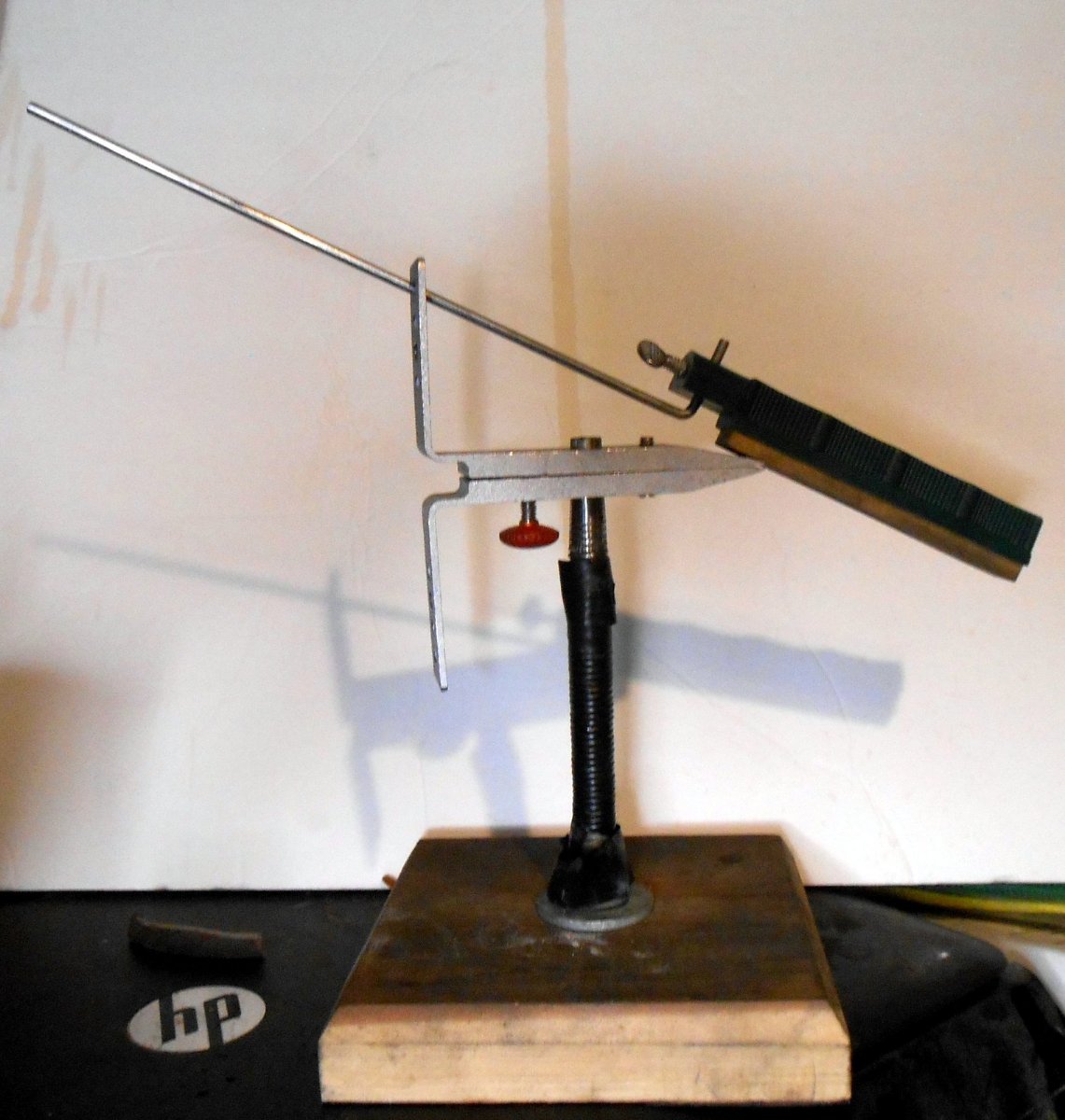

Now I use a Lansky Turnbox D2-C2.
Drop the rods into the 20 degree holes for pocket knives, 25 degree holes for kitchen knives.
I keep the knife straight and let the rods worry about the angle.

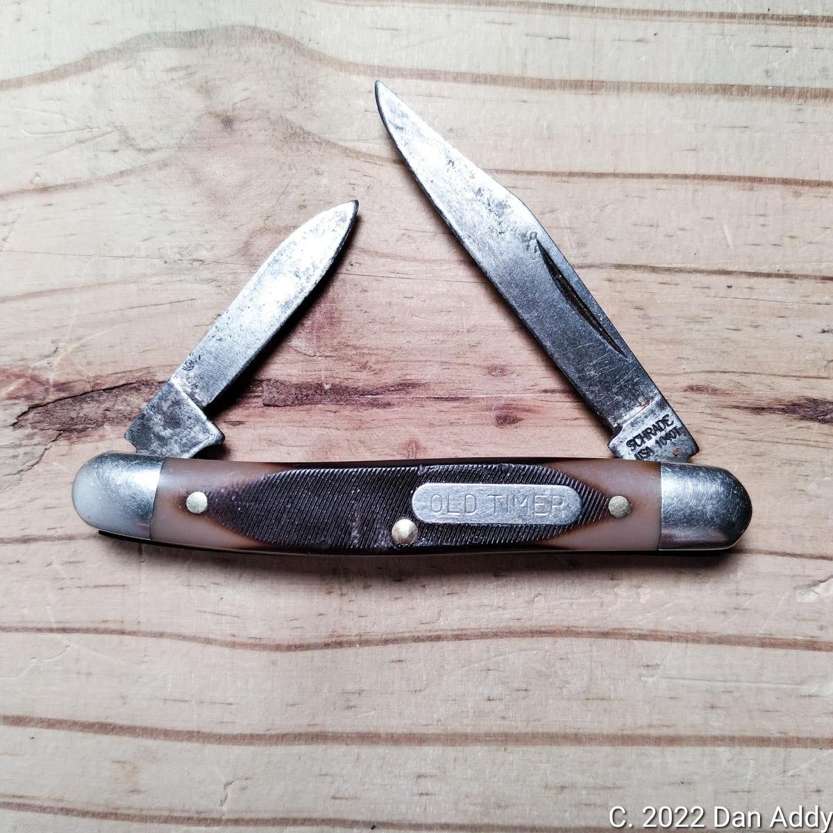

I can now say with a little more certainty why I was so bad: the poor little Victorinox Rally had its goose cooked the instant I took it to the pull-through sharpener. Never again! It may be useful for setting angles, but not actual sharpening. I will be ordering up a Lansky Turnbox as well, primarily because I believe it's better suited for kitchen cutlery than an oil stone would be.
And no need to find some Imperials to practice on. I remembered that I have two 104OTs. Both have obvious signs of wear, so I gave the less attractive of the two a quick test. It could use some work, and I won't feel too guilty about using it as a test mule. And it's starting somewhere in Arizona and only trying to get to San Antonio. :mrgreen:

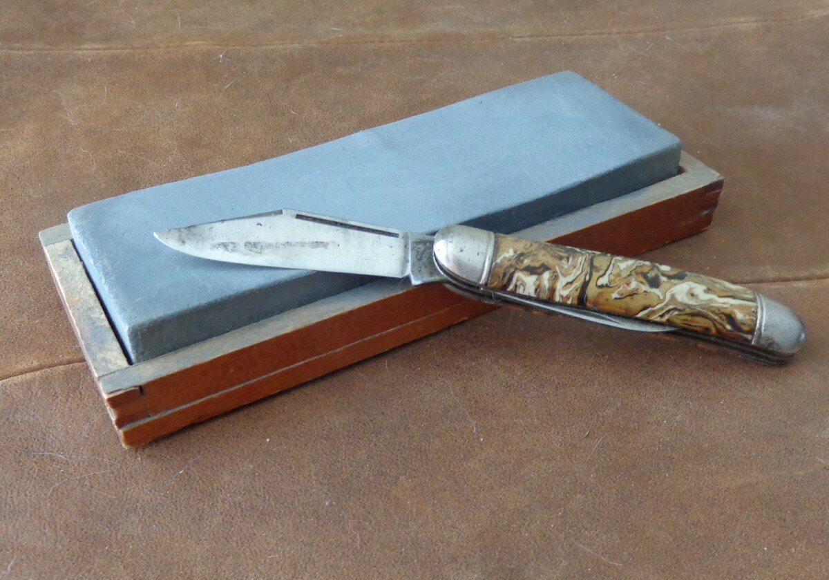

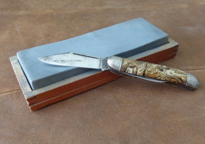

I use the circles method with the stone in my left hand. Because that is the way my father taught me over sixty years ago, not because I think it is better. If I am sharpening long blades like kitchen knives I tend to use the slice method.
I like a six inch stone in a box: the box gives me a bit more space to keep my finger tips out of the edge zone.
stone
stone
