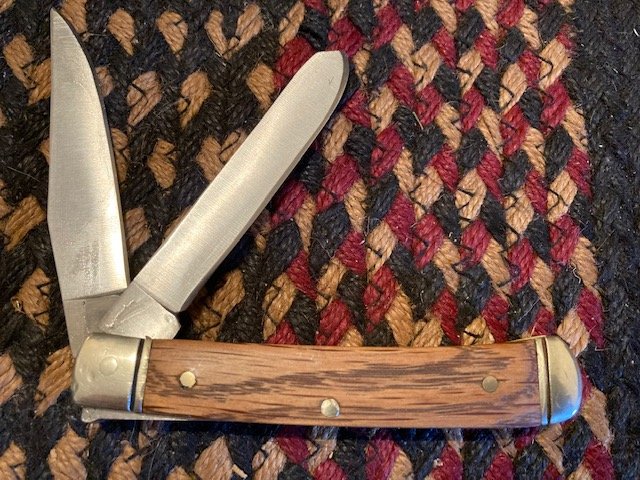

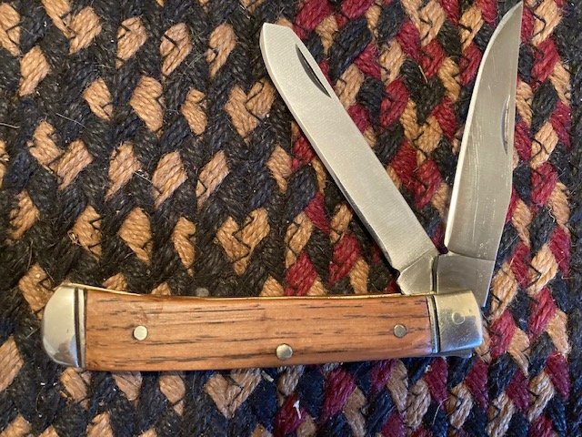

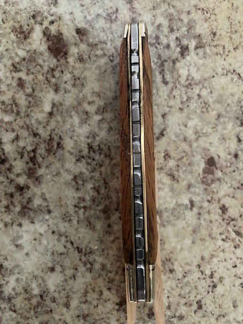

Jeff,
I tried the advice Glen and you offeredon my 3rd build. I liked the oak look so I made my own scales again. This time the pins look better and the bolster pins are almost hidden. Here are some pictures.

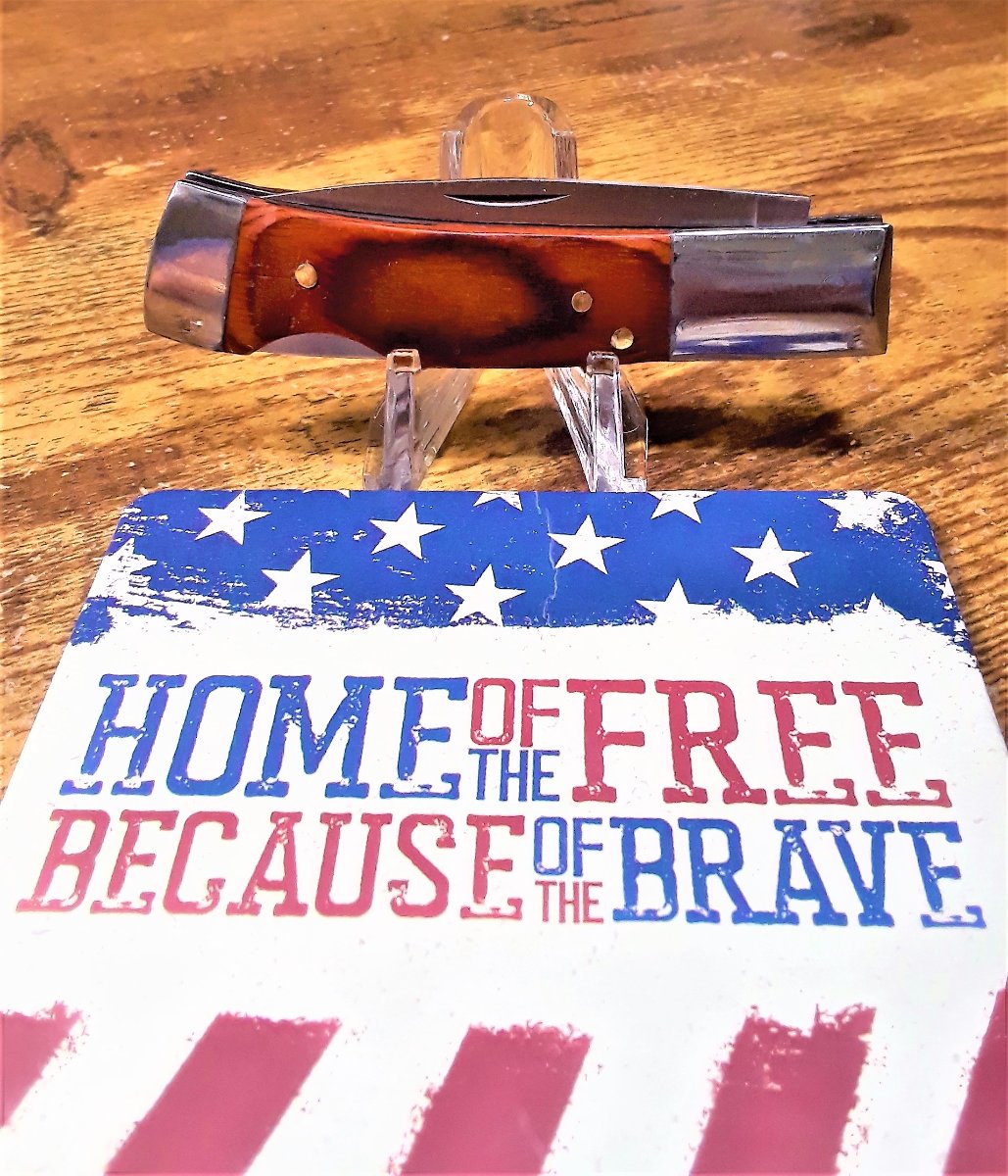

Here is one that I did.
David Roberts

Very Nice!! Great Job ::tu:: I Like the way your pins look. I will have to try one.

Looking good!
The more you do them the better you’ll be at it. Nice job on the hand made scales.
Jeff

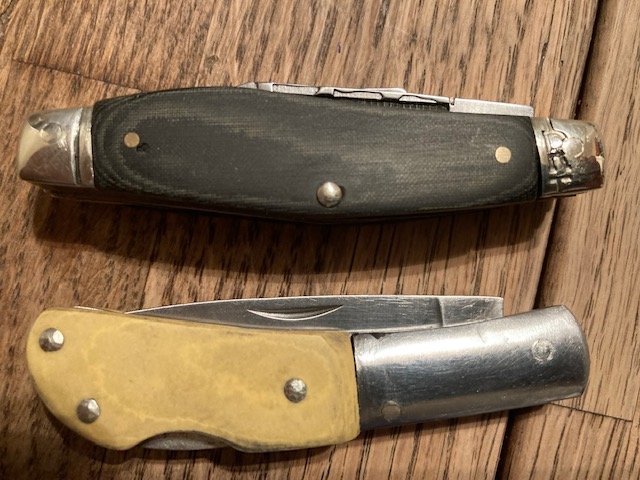

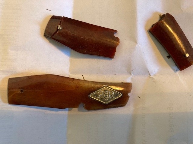

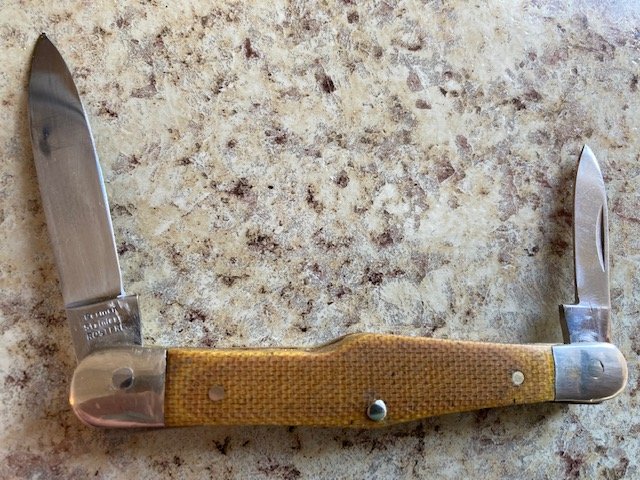

My 1st actual repairof a knife. I saw a friend over the weekend and showed him the knife kit I put together. He told me he had a knife that fell into the engine compartment of a vehicle he was working on and was going to throw out. I told him I would like to try to repair it. I started to look it over and found that not only were the scales broken the coping blade had no snap. I disassembled the knife and bent the backspring on the coping blade. Then I replaced the scales with some micarta I purchased from Jantz supply. I am gradually learning with the help of the members on this forum. ::tu::
I also have a picture of a rough ryder lockback kit I just did with white micarta scales. It appears white miarta absorbs you grimy finger prints. Maybe I should have sealed the scales before working on them. ::dang::
Just wanted to share with everybody.
Regards
Nev 52
Madmarco
Posts: 12039
Re: Giving knife repair a try.
Post by Madmarco »
Nev52 wrote: Mon Jan 10, 2022 4:58 pm My 1st actual repairof a knife. I saw a friend over the weekend and showed him the knife kit I put together. He told me he had a knife that fell into the engine compartment of a vehicle he was working on and was going to throw out. I told him I would like to try to repair it. I started to look it over and found that not only were the scales broken the coping blade had no snap. I disassembled the knife and bent the backspring on the coping blade. Then I replaced the scales with some micarta I purchased from Jantz supply. I am gradually learning with the help of the members on this forum. ::tu::
Regards
Nev 52
Great work Nev! ::tu:: Your friend now has his knife back in perfect condition and it should last him a lifetime. Your new kit knife also looks very good. I think the smudged white micarta gives the covers a kindda bone appearance rather than micarta. For future reference, if you apply and then wipe off your micarta pieces with Ren/Walker wax before working with it the fingerprints will be at a minimum if any at all. Nice job, keep up the good work! 8)

Looks good! And that micarta should be much more durable, and last him a lifetime!

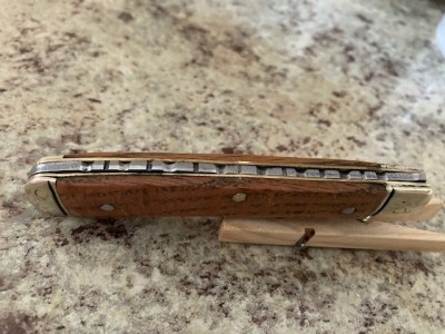

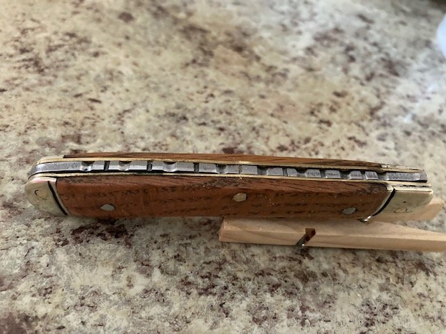

I decided to add some flash to the single blade trapper I built. I dissembled the knife and filed the back spring. Not really the look I had anticipated but the knife still works. :oops:
Madmarco
Posts: 12039
Post by Madmarco »
Nev52 wrote: Thu Jan 13, 2022 1:30 pm I decided to add some flash to the single blade trapper I built. I dissembled the knife and filed the back spring. Not really the look I had anticipated but the knife still works. :oops:
Looks excellent for your 1st try Nev! ::tu:: Wow, if you keep this up we're gonna be treated to some very cool builds, I can hardly wait! ::ds:: With each kit/knife that you assemble/build you will spot previous mistakes and not make them again, as well as coming up with new ideas for designs and features. Thanks for sharing your work with us! ::handshake:: 8)
8)

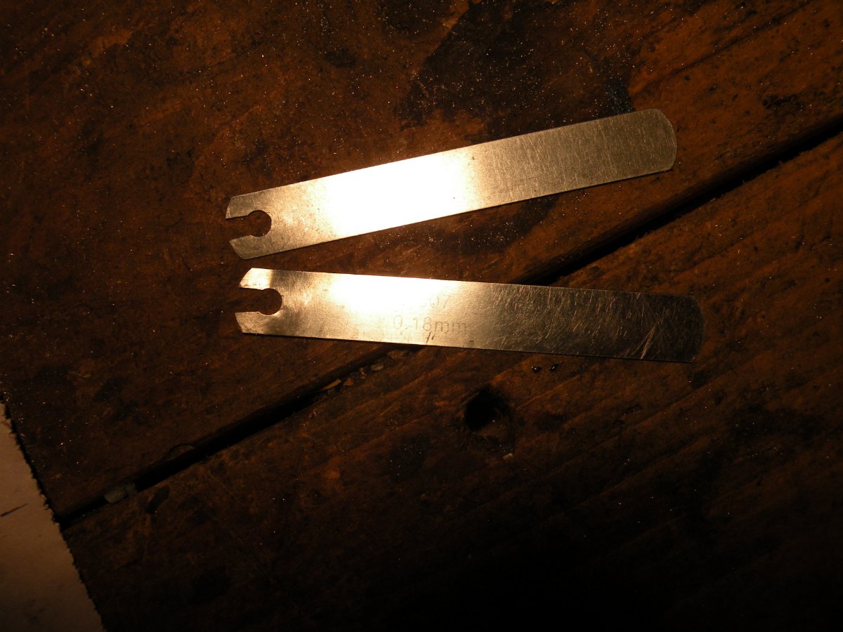

Hi Nev. I use a 7mm slackener (feeler gauge) on one side and an 8mm on the other side for most 2-blade knives. That way, I can do all the peening I want, the pin heads will be expanded in the bolster as much as possible, and the blades won't be too tight. Then after I remove the slackeners, there is always just a small amount of blade wobble. Just a tiny tap or 2 without the slackeners in place should remove any wobble. If not, repeat until wobble is gone. Go slow, and don't overtighten. I use modified feeler gauges, so that I can slide them all the way in between the tang and the liner (pic attached). I use tin snips to make these and cheap feeler gauges. For larger knives, I use larger slackeners, but the same process. Sometimes, you do your best, but unexpectedly, the pin heads still show in the bolsters. Just before I assemble everything, I always ream the pin holes in the bolsters so that they are properly tapered and have clean, fresh metal exposed and I lightly sand the pin stock so that you have clean metal on clean metal. Maybe this makes a difference and maybe it doesn't. Just something that someone shared with me a long time ago. :D

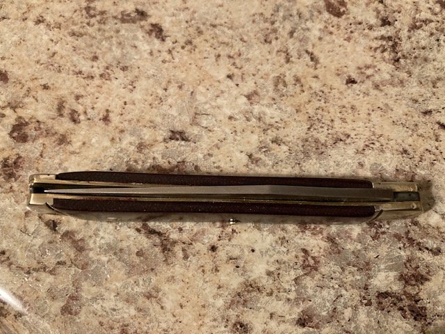

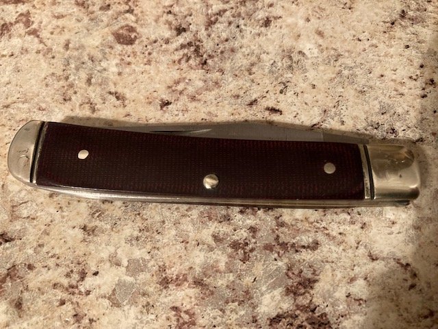

My last build for now I am out of kits.
I made one more single blade trapper. I think my pinning is starting to improve. I have one issue that I don't like on this build. The blade is not centered. ::dang:: Other than that I think it looks ok.

I like the handles on this one, Nev52. Your skills are definitely improving.
The blade being off-center can be caused by the holes in the liners not lined up properly, either drilled in the wrong place, pins too small, or a pin is bent. (There may be more, but these are all things that I have done!). Everything should be drilled and sized correctly on a kit knife, but still can be off.
I HATE taking one apart that I have just finished, but I do learn from my mistakes when I do.
