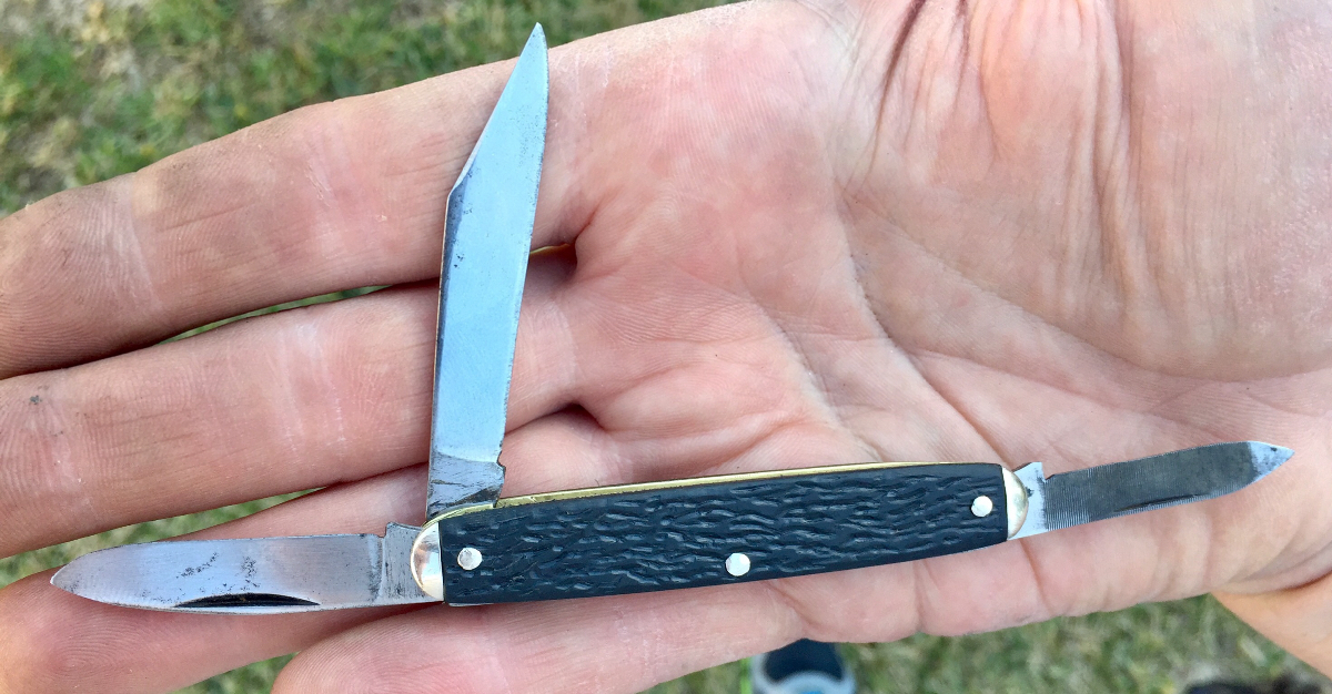

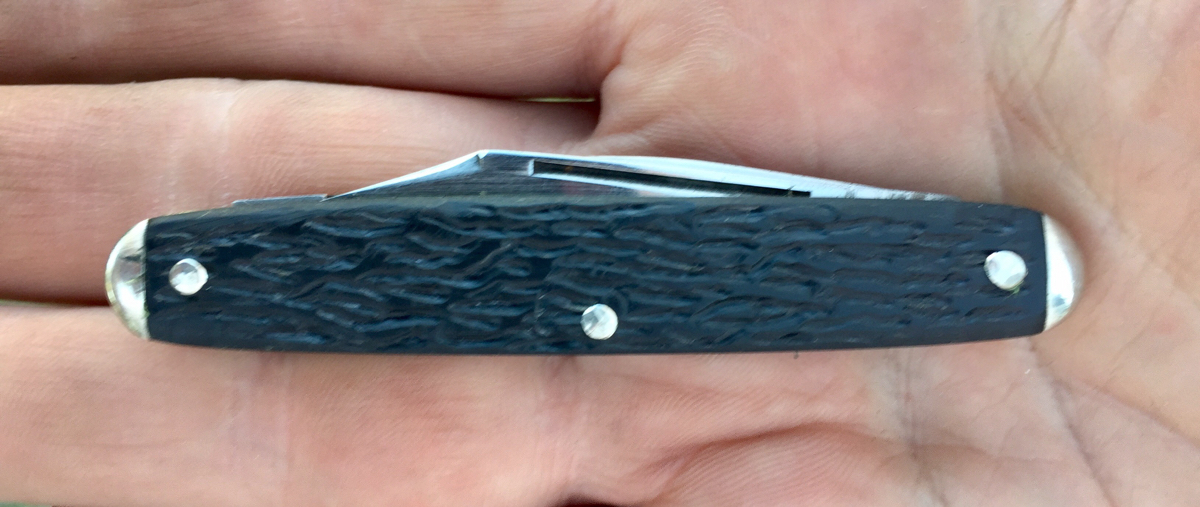

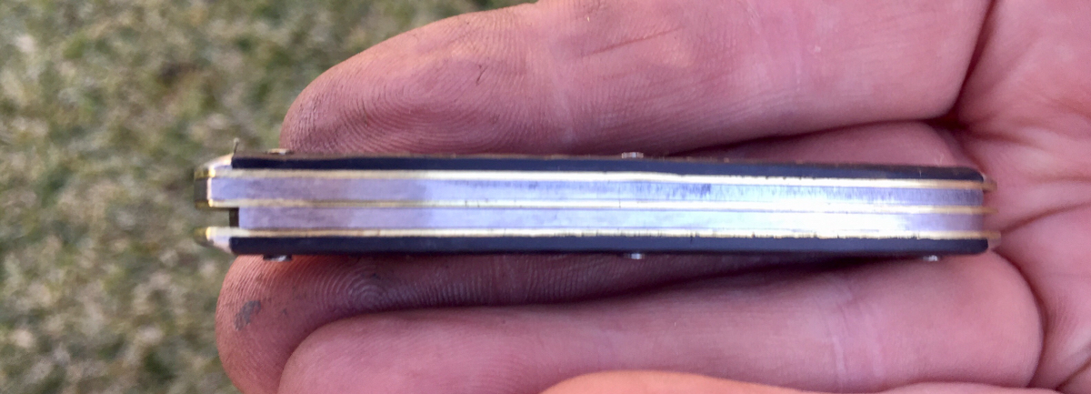

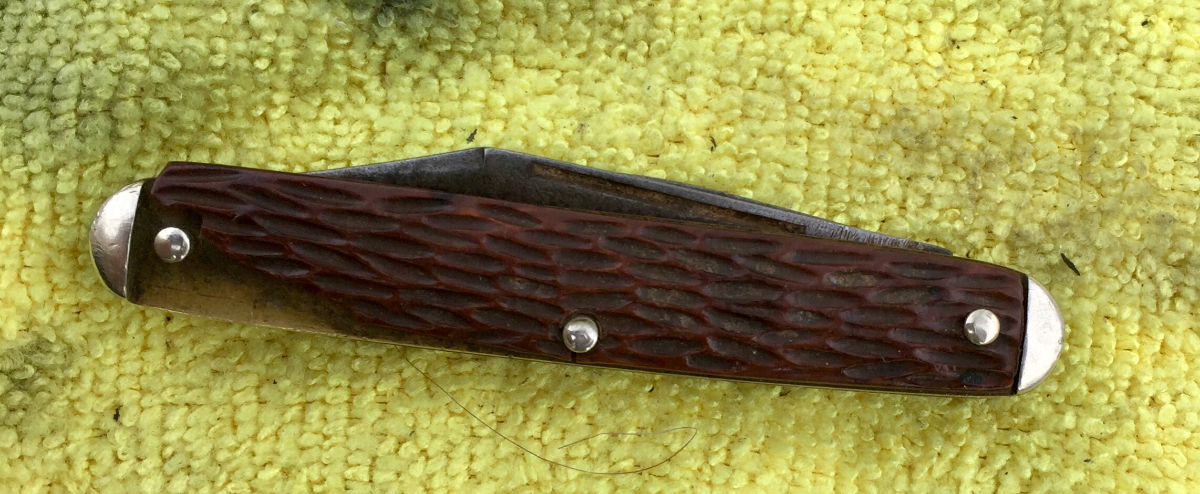

Here it is all together. Minus the sharpening. I hand pein the pins. So they are a bit choppy looking. When peining it together I use a .007 shim between a blade and liner. When it is tight, I remove the shin and check for wobble. It usually takes several light taps to get it nice.
All blades have nice strong snap and no wobble.

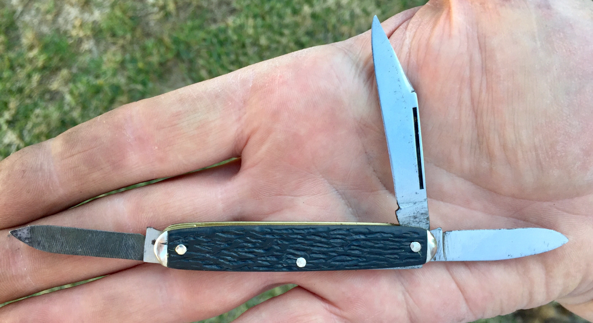

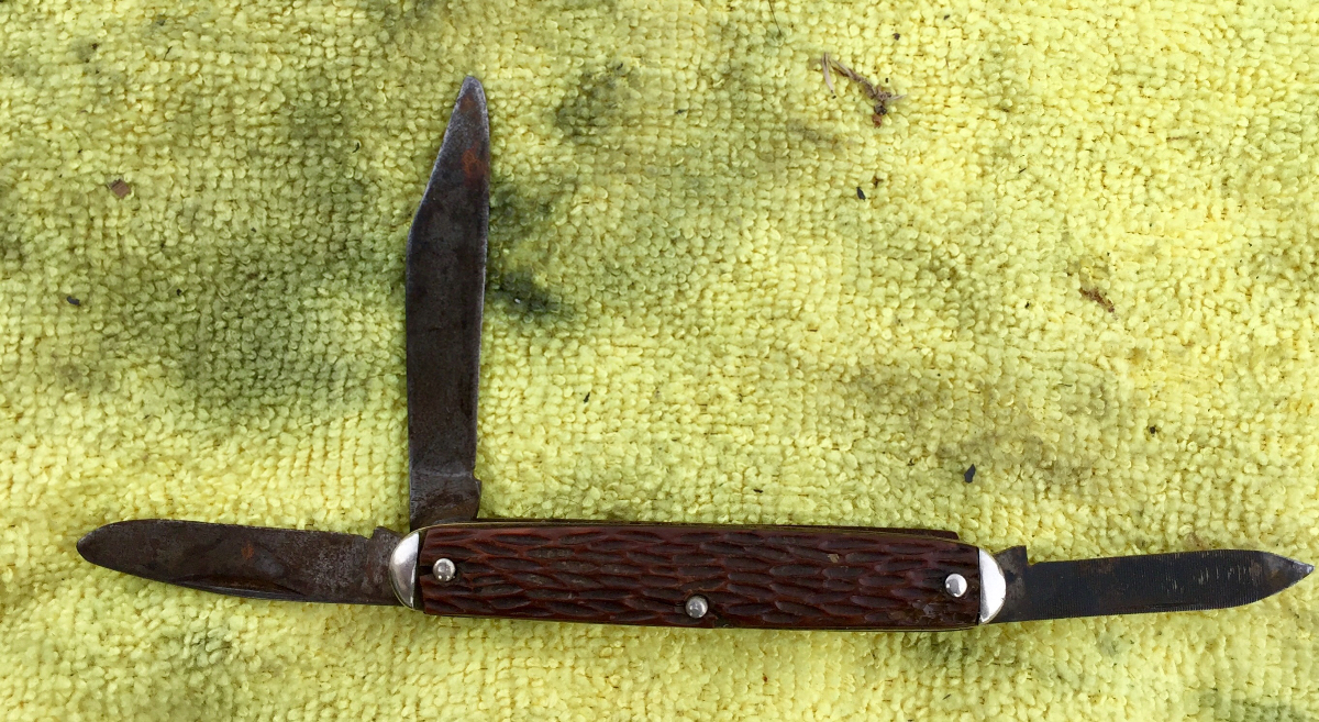

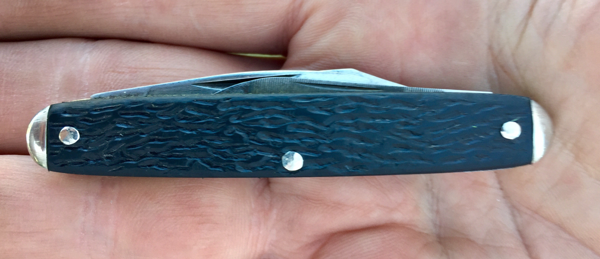

Before and after.

Twhite, you should be proud. That looks very good. I'm proud for you. ::nod:: ::tu::

doglegg wrote:Twhite, you should be proud. That looks very good. I'm proud for you. ::nod:: ::tu::
Thank you. I am proud of the results.

I am wondering how you managed to smooth down the Delrin after you jigged it, did you sand it?

Post by Twhite »
orvet wrote:Great looking job! ::tu::
The Side I jigged was factory smooth and polished. After each jigging, I ised a nylon type brush on my Drexel slowest speed and no pressure on the jigging. This removed the hair and lightly buffed the surface.
After I was done I took it to a cloth polishing wheel on my mill. And very lightly buffed it to smooth things out. I could try polishing with Flitz by hand to get a better sheen. As this is just a beater practice knife I felt no need to do so..
ON a side note. The knife took a wicked edge. It seems to be a nice hard steel. I wish I knew who manifactured it.
