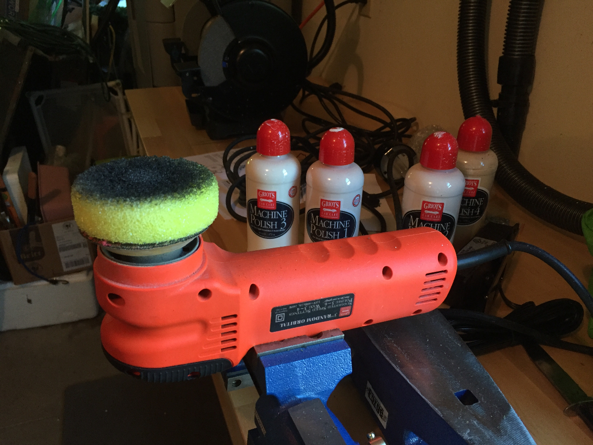

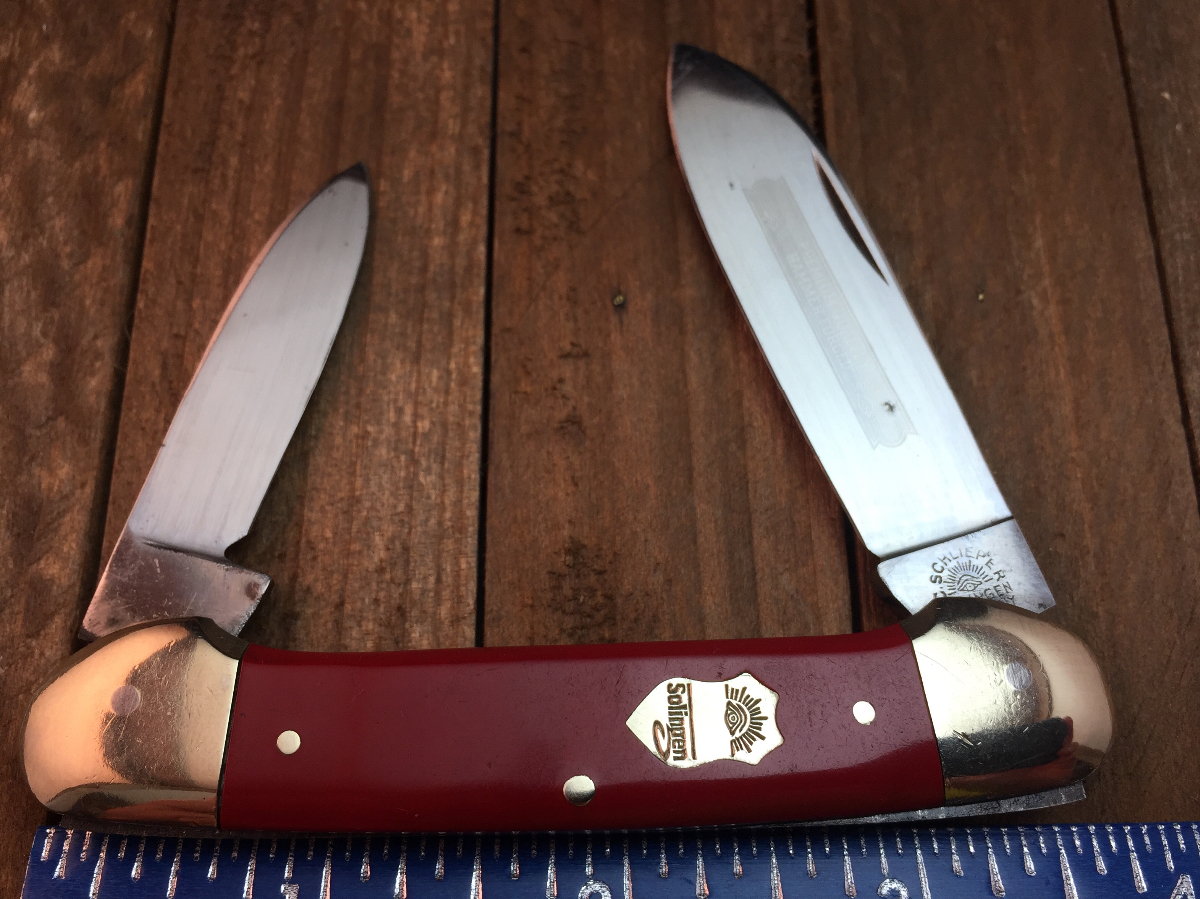

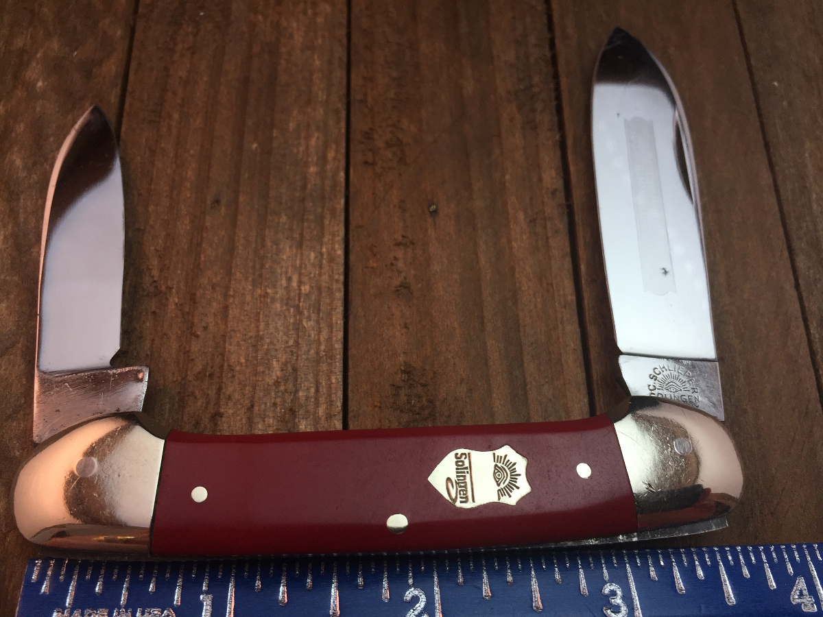

Hey I know this is an old thread, so you have probably moved on by now. But I have a suggestion that works wonders on this type of handle material. It’s so unconventional some might think I am nuts, but it works. I have a ton of Griot’s Garage products in my garage. I have their 4 inch detailing machine and all the pads they sell plus all the polishing compounds that they have as well. Numbers 1 through 4. This set up is designed for clear coat on cars. Their 4 inch detailer is guaranteed not to burn through paint, so you will not overwork the surface w/ this. I start out w/ the 1 which is for fine scratches and work up to the more aggressive stuff if the number 1 doesn’t work. Amazing results. I will include a picture of my set up and some before and after pics. It even works on bolsters. Although the bolsters tend to make the pads dirty quicker, but they polish up nicely too. This isn’t my best example on this Carl Schlieper, I had already worked it a bit on the before photo and decided to work it some more. I keep forgetting to take pics of the before. I have a lot of knives to get ready for sale.
SSk Mark
