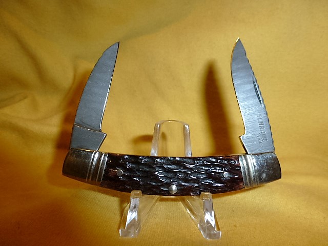

Now THAT'S a beaut!KnifeSlinger#81 wrote:I may be wrong but I may have seen somewhere that case gets their damascus (or at least some of it) from Devin Thomas. I only have one case with damascus, but it seems to perform better than their cv and ss, plus it looks way better.

KnifeSlinger#81, Your Case knife sure looks like Devin Thomas Damascus. I have used that same pattern before, excellent material in my opinion. I am surprised he could supply a factory with a lot of it however. TerryKnifeSlinger#81 wrote:I may be wrong but I may have seen somewhere that case gets their damascus (or at least some of it) from Devin Thomas. I only have one case with damascus, but it seems to perform better than their cv and ss, plus it looks way better.

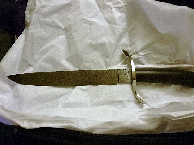

This is an early knife by the formidable Jerry Fisk. He was declared a National Living Treasure by the University of North Carolina. He has traveled the world teaching others the art of knife making. His blades are among the most sought after by the "high rollers." My acquisition was a fluke and produced a grail knife I did not think was achievable.

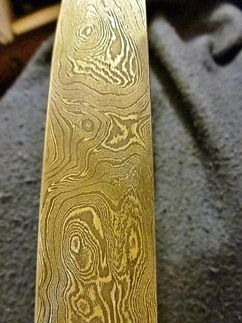

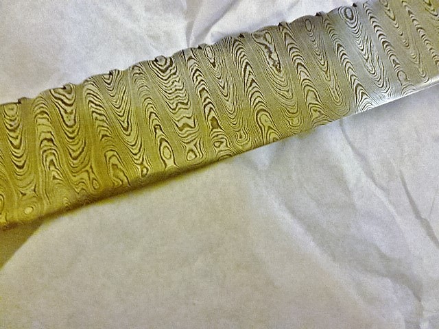

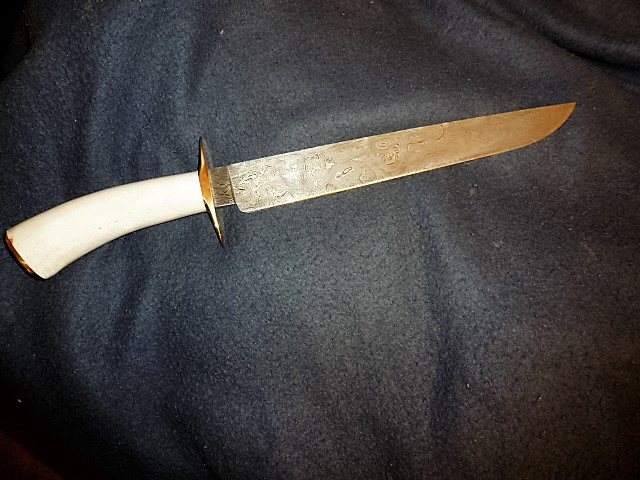

Some more Damascus blades.

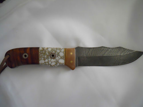

Nothing is cooler than being in the timber dressing a deer and having another hunter come up to ya and ask " hey, whats that knife you're using (pattern welded blade)....... awhere didja get it? Its a pattern welded blade and came outta my shop.
