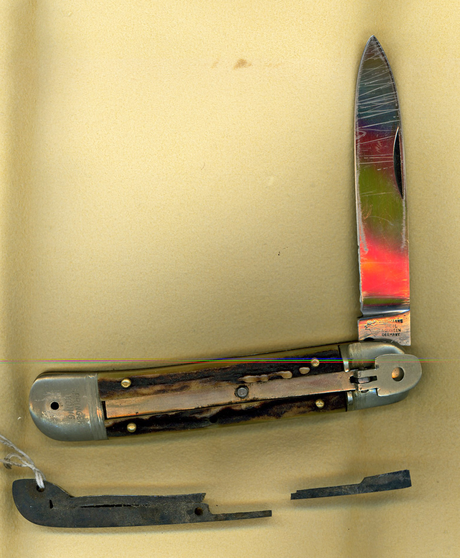

I have an old Weidmannsheil leverlock someone sent me for a repair that has a broken kicker and a broken backspring.
The whole setup looks like the one Kaleb just posted.
I am thinking I might be able to make a new backspring out of 1095 and use one of the Hubie 11 cm springs for the kicker spring.
Has anyone else done this or know if it is possible?

orvet wrote:I have an old Weidmannsheil leverlock someone sent me for a repair that has a broken kicker and a broken backspring.
Sounds feasible to me Dale. post some pics if you get a chance or better yet, shoot me some dimensions I have a few backsprings stuffed away in a box out in the shop somewhere. Is it a conventional springer or a shellpuller?

Here is a pic. It is a conventional, not a shell puller.
I had another complete assembly with a 10.5 cm kicker spring. The backspring was about .5 cm short.
The length of the backspring is 11 cm.
Thanks Kaleb, I appreciate the help.

Here are pics of the disassembled knife.
The verdigris is easily scraped off with a fingernail. The spring has a 45
degree angle at the end that fits into a similar angle in the pocket. I had to
tap it out sideways with a pin punch. It was very tight. The spring is only
2x3mm but Stephen thinks a Hubertus will fit. I am skeptical but will give it a
try anyway. Have to order it now.
