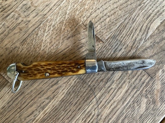

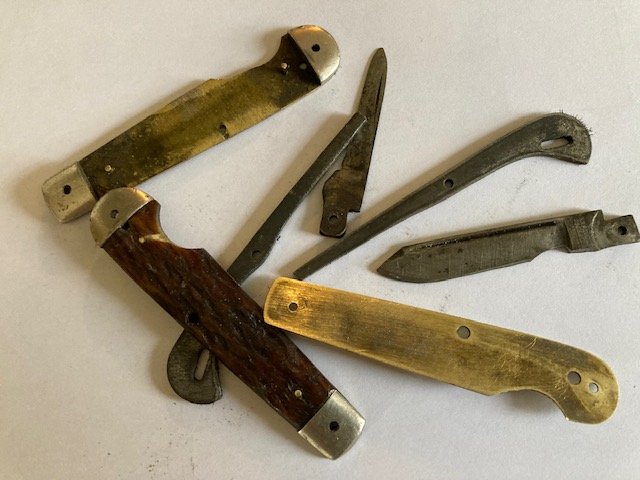

As some of you know (Jeffinn ) sent me a box of beater knives to experiment on to build my knife repair skills. It had a Camillus Jack knife in the box that had a cracked scale and junk blades. I found a doner and made a knife from both. Not a collector's piece but a good user. It took me 4 tries to get everything right with fixing the angle back of the blade to adding tension to the springs. It's not perfect but she is a good user. Just thought I would share a picture of the knife.

Wow, that’s a great user now!
Nicely done.

WOW.... great job!
That is a nice looker for sure!!

...and your pin work looks really good!

Good on Jeff and great job by you. Lovely bone.

Excellent job, looks like factory bones and beauties at that. Great work and keep them coming. The world needs more knife mechanics. Thanks for showing.

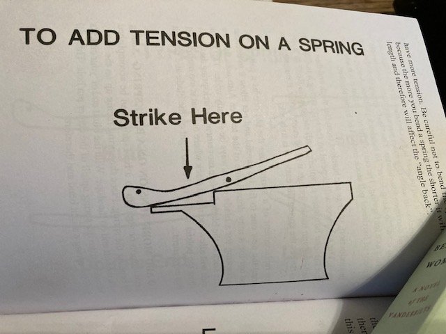

Nice knife!! Curious how you add tension to the springs???

Nice looking work Nev! ::tu:: ::tu:: I have the same question as Tom. How are you restoring tension to the springs? I have read about and seen pictures of a procedure known as "moving the hole", but I haven't tried it yet. I have had some success with welding steel onto a spring to fill in a "divot" or depression when one has been worn in the spring, but frequently I find that the problem is more due to metal loss from the blade tangs.

olderdogs1 wrote: Thu Feb 17, 2022 5:43 pm Nice knife!! Curious how you add tension to the springs???
Tom
Tom & Herb
This is out of the Knife repair & restoration By Adrian A. Harris
