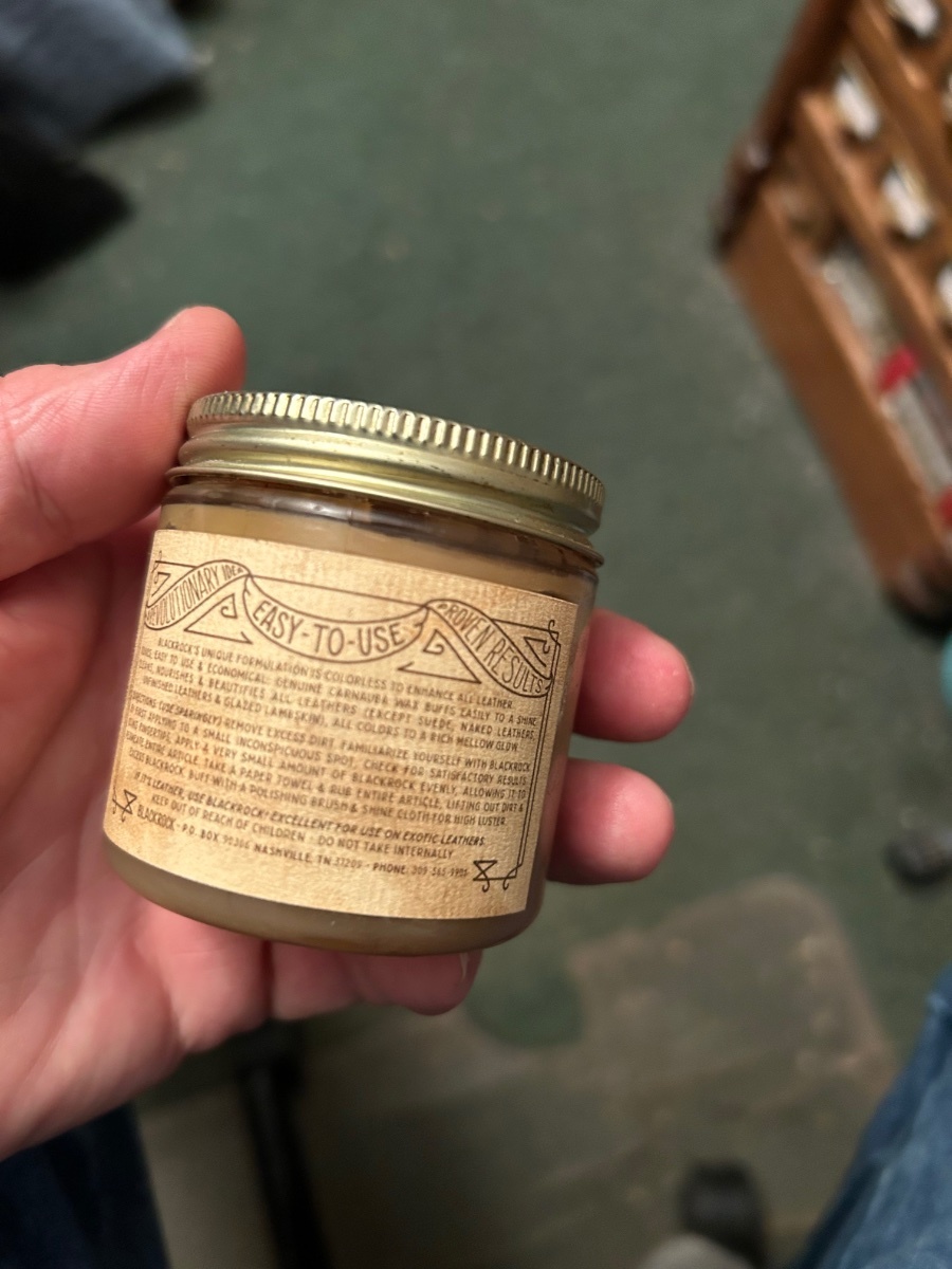

Post by Rockingkj »
I have had super results rejuvenating old leather with Black Rock leather conditioner. Best stuff I have ever used

Rockingkj wrote: Tue Jan 02, 2024 11:38 pm I have had super results rejuvenating old leather with Black Rock leather conditioner. Best stuff I have ever usedFD5A520B-88A0-40D8-A876-4860A18B1651.jpegA8A89089-1993-4A2C-9B23-23BEF235BED2.jpeg
I also like Black Rock. That said, it will darken light leathers. If that is an issue for you, use Cadillac Boot and Shoe Leather Lotion. It does NOT protect as well as Black Rock, but will not darken the leather.
