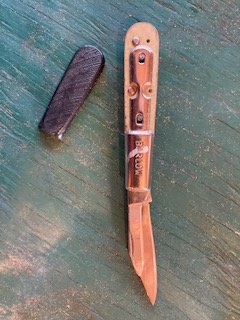

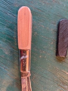

I am trying to replace the scales on this old Imperial barlow. I had some cherry wood so I figured what do I have to lose. After I shape it a little more I will expoxy them on.

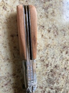

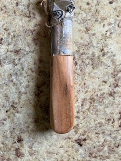

Update on knife.
Working at a snail's pace, Finely attached the scales. 4th set I made.
I will update when job completed.

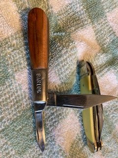

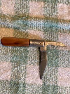

Completed Imperial barlow.
I know this is an elementary job for many. I think it turned out allright. Not up to some of the repairs I have viewed on here but I am trying.
Thanks for looking.
Thanks for looking.

I did not think replacing the handles on shell-handle knives was even possible without converting them to standard handle construction by removing the integral bolster/liner and replacing them with standard liners and separate bolsters.
Great job!
One of the about half-dozen Imperial Barlows I amassed in less than a year's time (ironically the first of that group) has the butt end of the scales broken (both of them), so I may attempt this.
Great job!

Re: Replacing scales on Imperial barlow
Cody6268,
I am glad I did not know that or I would not have tried. I don't know it it is correct way but so far it's working. After I pried off the plastic scales I traced the old scale to some cherry wood. Then used a dremel tool to remove the wood so I could install over the high parts on the inside cut scale. After 4 attempts the scales fit.
Then I expoxy on the outer scales. after that I shaped the scales on a belt sander and hand sanded to fit. I hope it holds up.

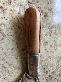

What did you use for a finish on the wood?Nev52 wrote: ↑Tue Dec 28, 2021 8:13 pm Cody6268,
I am glad I did not know that or I would not have tried. I don't know it it is correct way but so far it's working. After I pried off the plastic scales I traced the old scale to some cherry wood. Then used a dremel tool to remove the wood so I could install over the high parts on the inside cut scale. After 4 attempts the scales fit.Then I expoxy on the outer scales. after that I shaped the scales on a belt sander and hand sanded to fit. I hope it holds up.

Olde Cutler,
The finish is paste wax.
I enjoy small projects and this pocket knife repair seems to be somewhat addictive. I was thinking about buying some inexpensive china made knives to take apart and experiment on to refine my work. I think the hardest part is the intimidation of destroying a good knife. I guess once you break the ice that fear will diminish.
