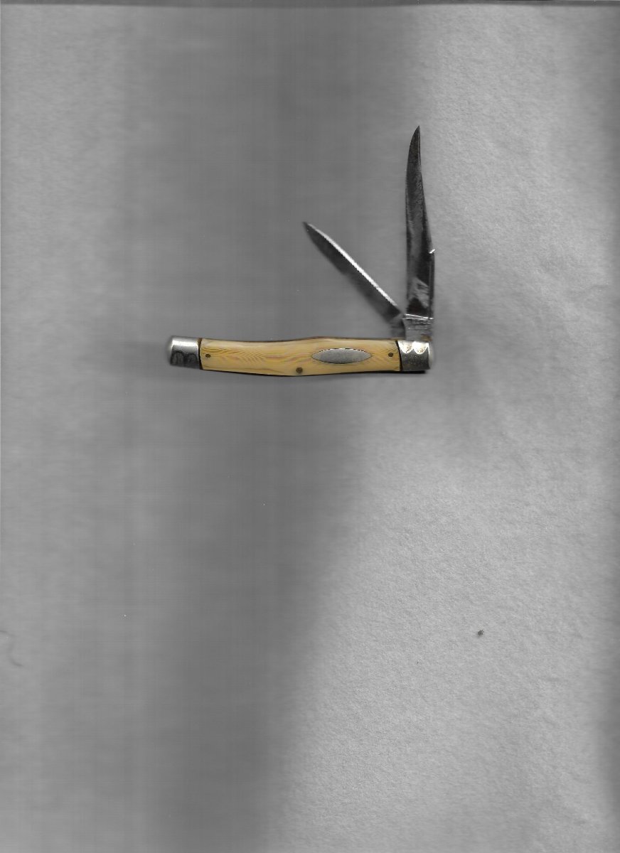

The knife is WR CASE/& SONS/ Bradford Pa 3 5/8" Pattern number B232. Would you PM a picture and price. This knife is not gasing but has shrinking.

Thanks Cody, I looked at this knife today and it is gasing, was not last time I looked. I need to do something!
