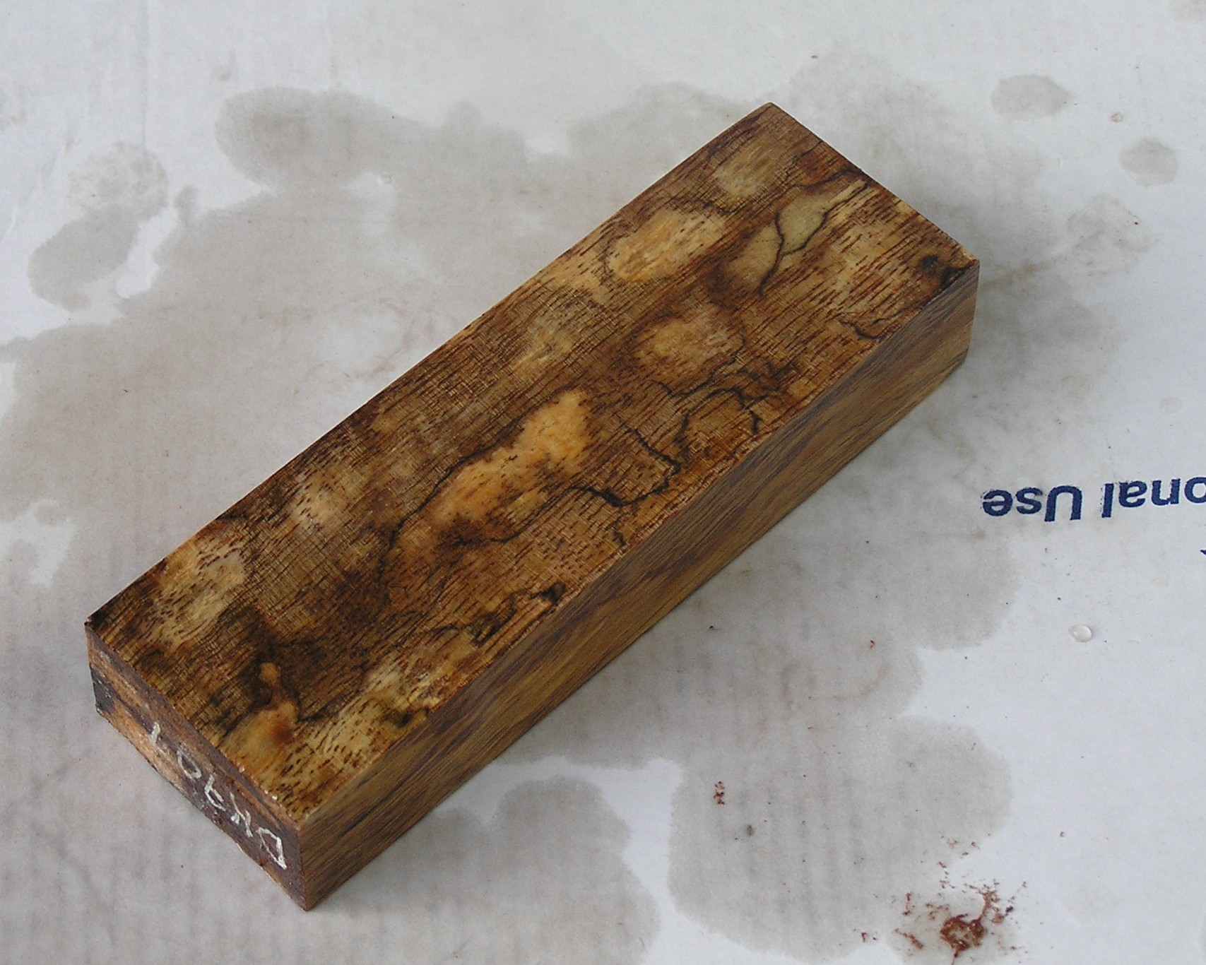

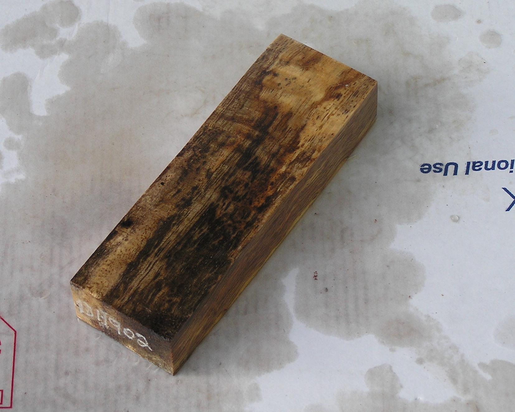

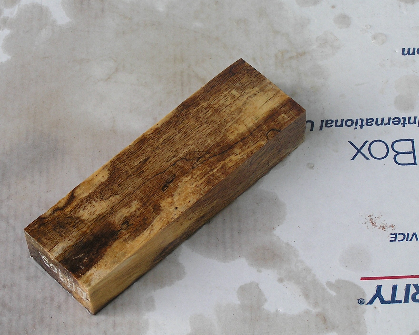

Some folks just dip wood in minwax and call it stabilized. I have some very nice spalted Mango that I sent to WSSI about 1 year ago - and it looks great. As far as I'm concerned only the polymer (more than one monomer) acrylic process used by WSSI and K&G qualify to be called stabilized. There are a few others that use this process.
Here is a couple blocks from WSSI - I have a box of it.
Your knives look great by the way! ::tu:: ::tu:: ::tu::
There are a couple sellers on eBay selling bad stabilized woods!
