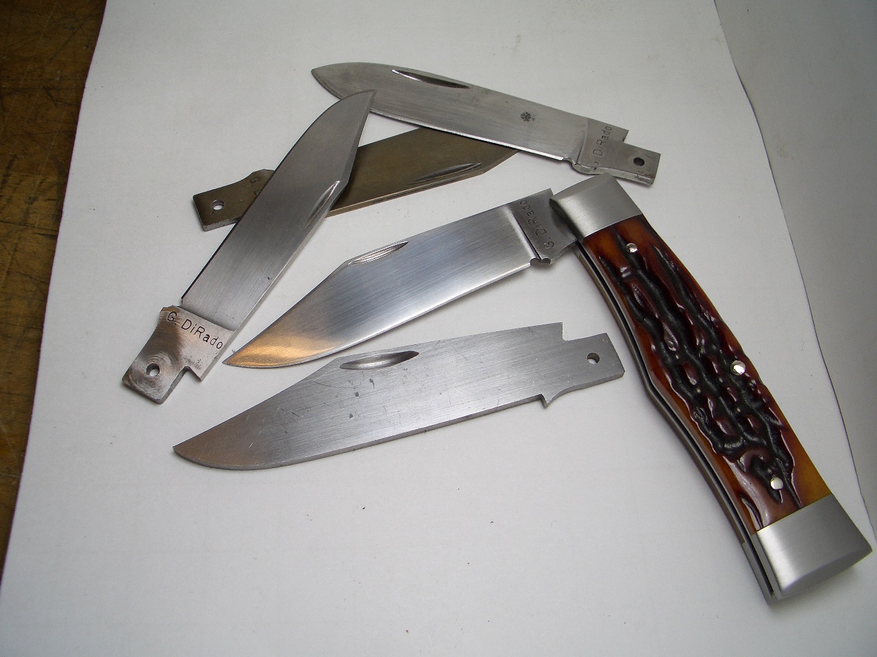

FOG wrote:That press is a good idea. Please post some pics id love to see them, and if you can some of the press and the die as well. Thanks,Bryce
I am not a pro knifemaker, just a hobbiest. This is how I do it.
This photo is some nail marks cut with various dremel type wheels. The one on the completed knife is good. The other four are failures and the blades were scrapped.
This photo shows stamped marks. The blank blade is soft steel and shows how the stamp looks before clean up straight from the arbor press. the finished knife has had the mark deepened by hand and is ground, hardened and tempered (of course).

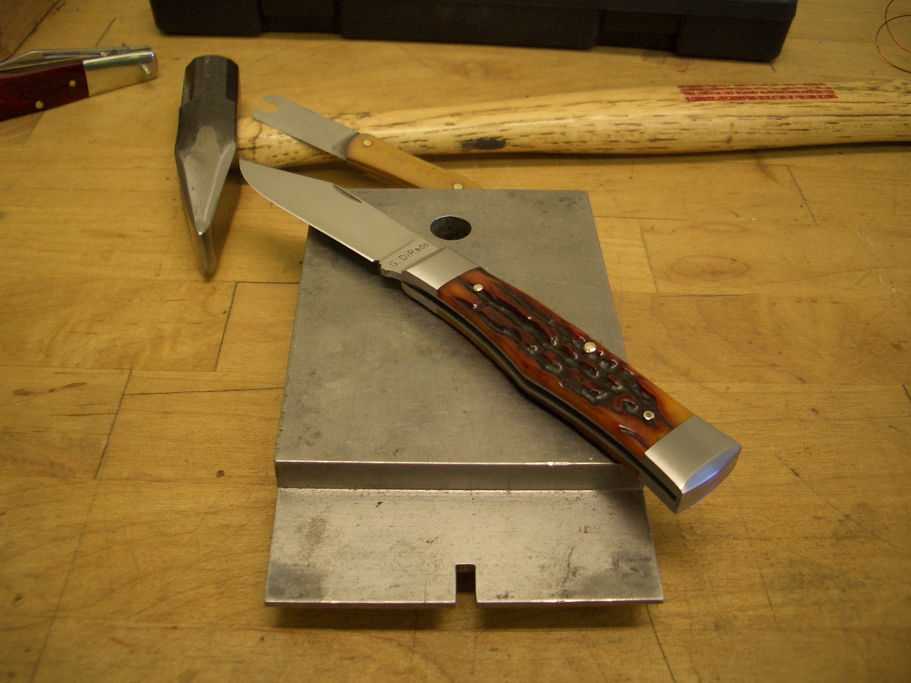

And since we are talking about shop made tooling I thought I would throw in a photo of this bench block steady. Made with the grinder and files, 3/4" thk x 3" wide x 5" 4140 Cr moly. Very resistant to dings and marring. I set my rivets and punch pins with it laying flat on the bench. When I need to work off the front I chock it up in the jaws of a horizontal vise

km 3, you are absolutely correct. Stamping the blade that close to the top displaces the metal and leaves a bump on the spine. Found that out the hard way. The way I get around it is;
scribe the layout leaving about 1/4" between the top of the pattern and the edge of the barstock and drill my hole in the tang.
stamp the nail mark.
profile the blank then surface grind.
Works out pretty good as you can see. A 1 ton press would work alot better but the 1/2 ton does a respectable job.
