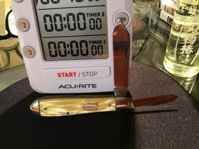

Here's the knife that's driving me crazy. Below is the clip from Goin's. There's nothing to indicate how long Shapleigh sold these brands or which ones. However, the part that stands out is that the tang stamp was only on one blade after 1940. Mine only had the tang stamped on the master blade. Keep in mind the ad I mentioned above shows Enterprise knives being sold by Shapleigh in 1929 so it's obvious they were being sold after 1915 - which contradicts Goin's date of 1900-1915 for the company. Could my knife be a post 1940 one since it's only marked on the master blade tang? For those who know their knives better than me, does the look of the knife help in any way to date it? I'd love to just say it's 1900-1915 like Goin's says, but this other information makes me have doubts. BTW, on another thread on AAPK I found this: "Enterprise Cutlery Co. Sold by Shapleigh. Whole salebrand? 1918 to 1920's.( Blades 7th Edition )"

tvic wrote: ↑Sat Aug 21, 2021 9:04 pm Here's the knife that's driving me crazy. Below is the clip from Goin's. There's nothing to indicate how long Shapleigh sold these brands or which ones. However, the part that stands out is that the tang stamp was only on one blade after 1940. Mine only had the tang stamped on the master blade. Keep in mind the ad I mentioned above shows Enterprise knives being sold by Shapleigh in 1929 so it's obvious they were being sold after 1915 - which contradicts Goin's date of 1900-1915 for the company. Could my knife be a post 1940 one since it's only marked on the master blade tang? For those who know their knives better than me, does the look of the knife help in any way to date it? I'd love to just say it's 1900-1915 like Goin's says, but this other information makes me have doubts. BTW, on another thread on AAPK I found this: "Enterprise Cutlery Co. Sold by Shapleigh. Whole salebrand? 1918 to 1920's.( Blades 7th Edition )"
From Goin's:
The knives produced for this firm were marked on all blades until the middle 1940's. After this, they were marked on the master blade only. Some of the markings sold by Shapleigh were: Berkshire, Bridge Cutlery Co., Enders Oak Leaf, Diamond Edge(1864-1960) Keen Kutter(1940-1960), Empire Knife Co., NorShap (c1902-1920), Norvell-Shapleigh(c1902-1920), S Norvell(c1902-1920), Norvell's Best(c1902-1920), G. W. Putman & Co. Germany, Enterprise Cutlery Co., Simmons Hardware Co.(c1940-1960), Simmons Sonny(c1940-1960), and J. Koester's Sons Germany."
None of the knife books or resources are 100% accurate, nor do they list 100% of the markings.
To me, your knife looks likes 1940s.

I believe that the knife posted in the photo was made by Imperial circa 1910 to 1940.
I have owned a few Enterprise Cutlery knives, and all of the ones that I have owned looked to be made by Imperial in that era, when they made solid bolster knives.

Just found something else to help. There is an entire 1936 Shapleigh Hardware catalog online. There are, indeed, Enterprise knives in the catalog, and the exact same knife I have is pictured in it, as well.
