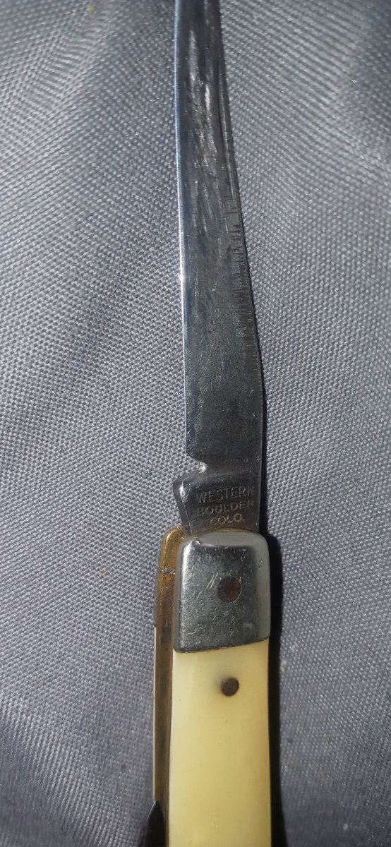

Over in the Knife Q&A subforum there’s a long-running thread called Tang Stamps. It’s a “sticky” thread at the top of the subforum. Here’s a post from there containing dates of use for various Western stamps. https://www.allaboutpocketknives.com/kn ... rn#p386214 Scroll down to find the charts for Western.

Looks like somewhere between 1951 and 1978. I'm not knowledgeable enough to narrow it down any further.

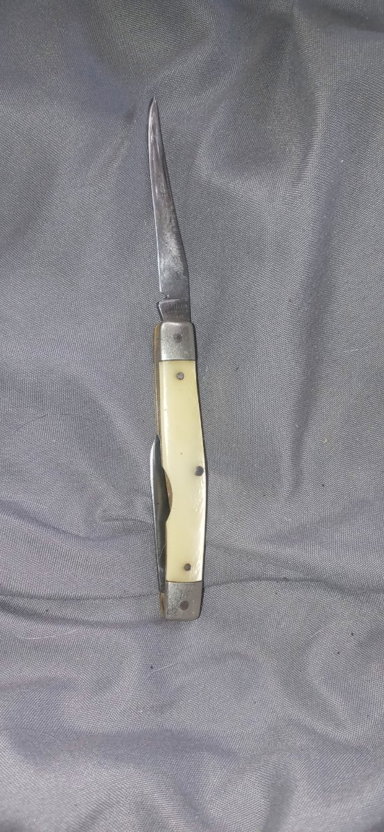

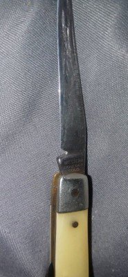

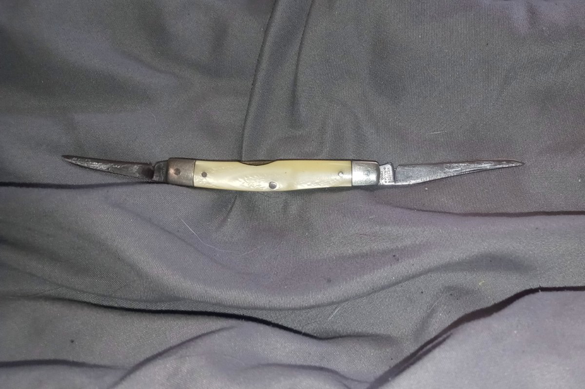

It's a model 241 "small 2 bladed pen knife". With no shield and squared off bolsters, it is from the 1959-1960 era based on the 1959-1960 catalog sheets. The same knife is listed in the 1968 catalog sheets, but has rounded bolsters.
It is NOT in the 1953 catalog sheets. So it was most likely made in 1959, or later, if there was a second run before the changes to the model in 1967 for the 1968 catalog offering.
If a Western, fixed or folder, references BOULDER COLO, it is 1972 or earlier. Starting in 1973, BOULDER COLO was replaced with a simple USA. The change was in anticipation of the complany building a new facility in nearby Longmont Colo. The company had bought 11 acres in the Longmont business park in 1972 or 1973. They broke ground on the new facility in the summer of 1977, moving in in 1978.
