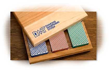

- Working Edge
- Posts: 159
- Joined: Fri Mar 19, 2021 3:49 am
Re: New knife won't sharpen??
I too, have a diamond stone kit, for those blade steels which just don't want to cooperate.
This DMT kit has four grits on two double-sided heavy aluminum plates, with a fitted wooden box.
I prefer the uninterrupted style of diamond surface, and at less than $90.00 before tax and shipping, this kit is a solid value.
Here's a link to the kit page at Sharpening Supplies:
https://www.sharpeningsupplies.com/DMT- ... -P404.aspx
Hope this helps..!!
Mark

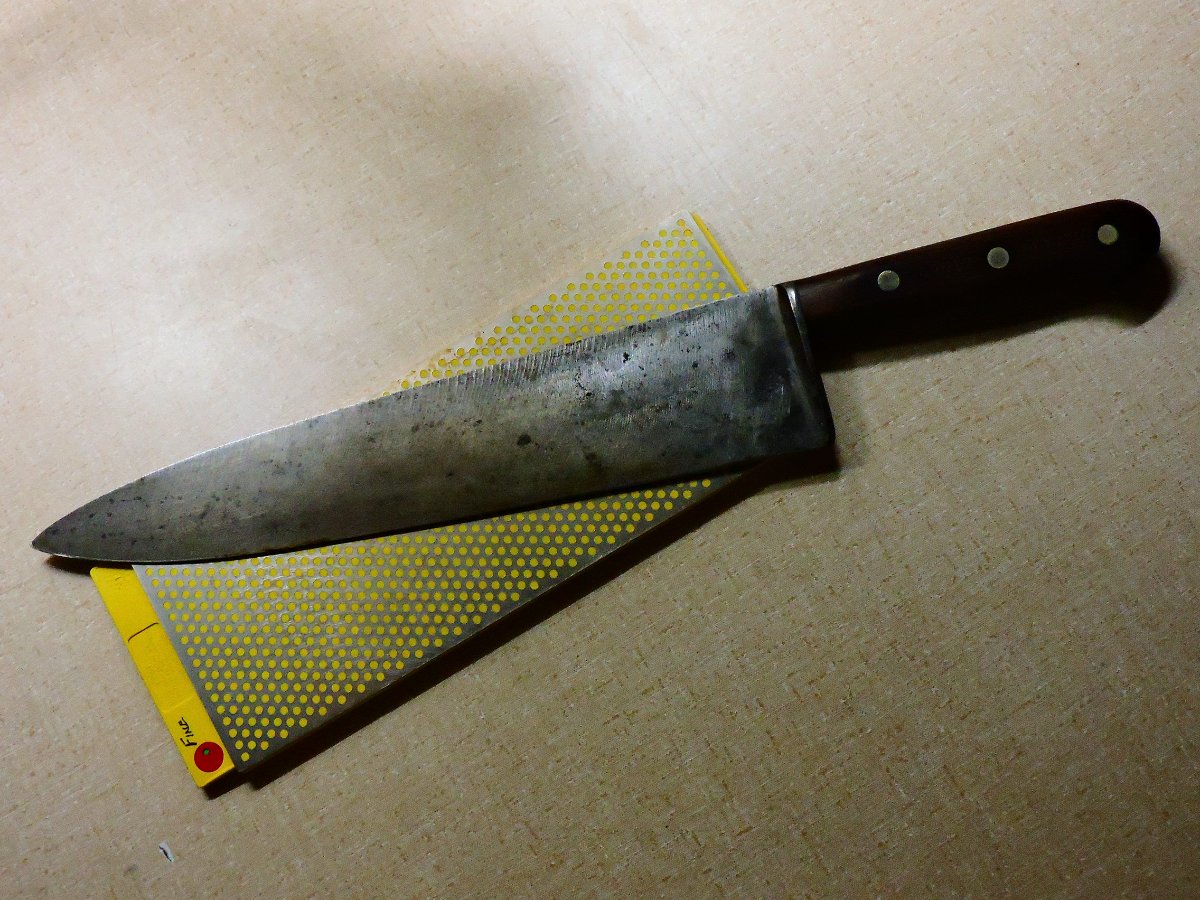

- FRJ
- Posts: 17130
- Location: Ct.
Where have I been.
Lost in the prejudices of sharpening paraphernalia.
And now I'm found ----- no, wait ----- now I have found the stone to fill in the gap of my sharpening arsenal.
For now.
This Diamond Stone is pretty nifty. I bought the 10 inch fine/extra fine model. Didn't want to go too course.
I don't think the steel is particularly hard in my Dexter chef knives but it is decent steel. This stone sharpens them to a very acceptable edge. At least it satisfies me.
Always learning.
