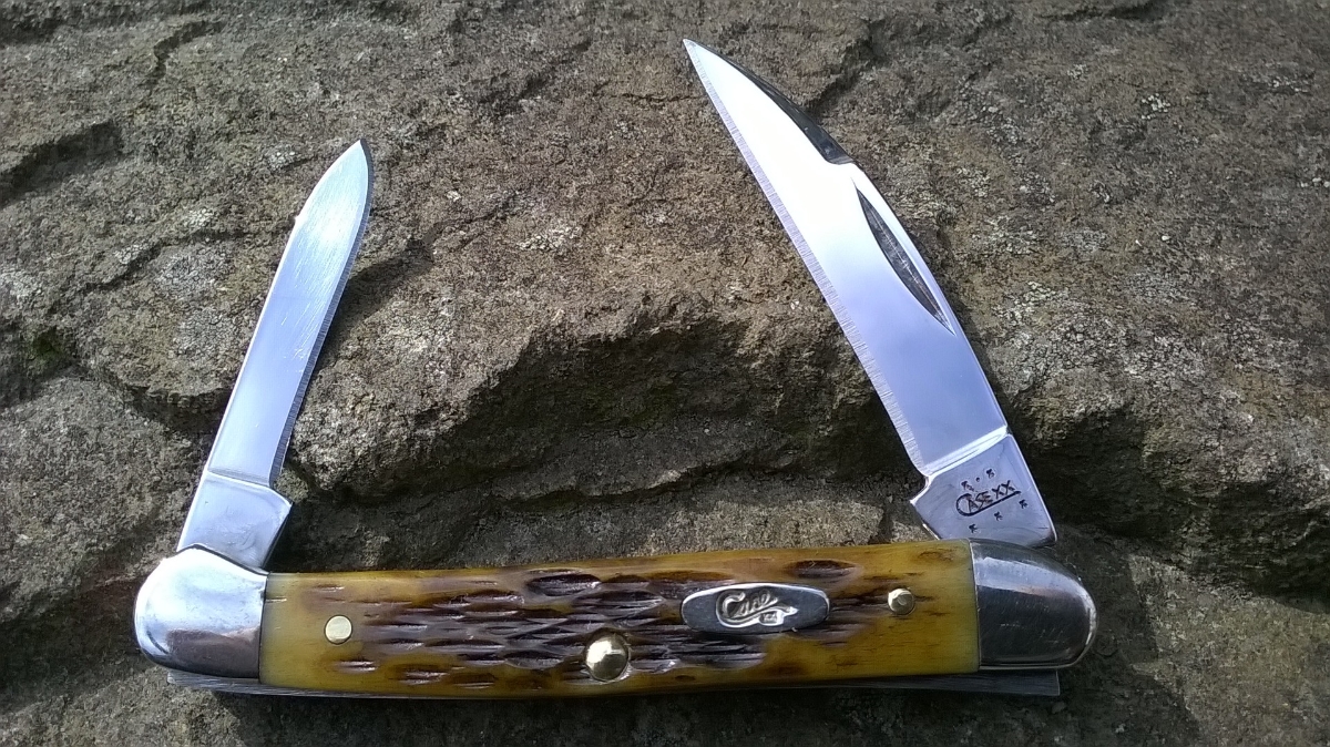

I've dyed many times. No horror stories, just success. I use a cue-tip and put little bit on at a time, dab here or there, or paint it on. Remove shortly for less penetration and lighter color. Let it sit on there or even dry to get deeper, richer, color. Fun mod you can do at home. Rit dye, leather dye for sure. Don't know about others. No hot water day or boiling dye for me. For what it's worth.
Top pic top knife is a Case Mini Copperhead Amber bone before dying. then below after dying. Same with before and after on the GEC 74 Mustang.

Man, those look great! It's also very affordable, fast & I bet it's within my rather narrow range of skills. Thanks.Ivoryman wrote:I've dyed many times. No horror stories, just success. I use a cue-tip and put little bit on at a time, dab here or there, or paint it on. Remove shortly for less penetration and lighter color. Let it sit on there or even dry to get deeper, richer, color. Fun mod you can do at home. Rit dye, leather dye for sure. Don't know about others. No hot water day or boiling dye for me. For what it's worth.

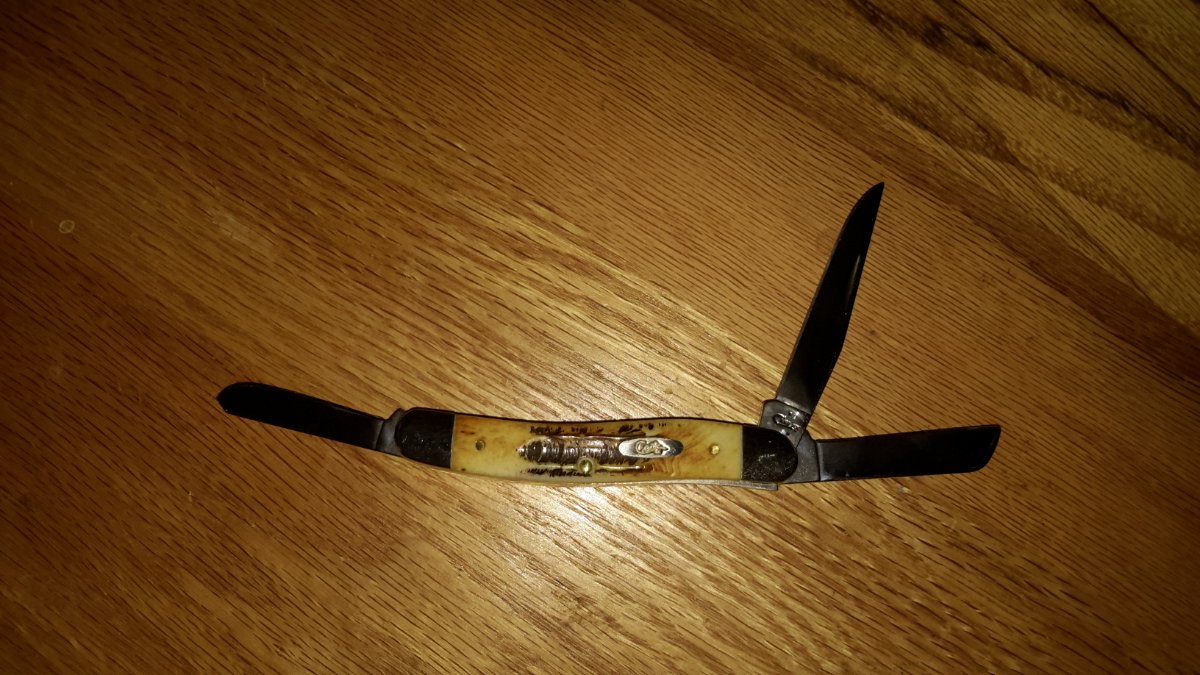

This is my workhorse. Case medium stockman in bone stag. It was a little to light for my liking so I made a stain out of walnut husks. I then submerged the knife in a half pint mason jar full of the stain for 2 days. I love the way it turned out. It's a great natural alternative to chemical stains.

Do you have a picture of what the covers looked like before you dyed them?

Did you put any kind of clear sealer over the dye?GardenGram wrote: ↑Wed Jul 07, 2021 1:36 pm This is my workhorse. Case medium stockman in bone stag. It was a little to light for my liking so I made a stain out of walnut husks. I then submerged the knife in a half pint mason jar full of the stain for 2 days. I love the way it turned out. It's a great natural alternative to chemical stains.

Here it is when I first bought it 2 years ago. It seemed to lighten up with use. I didn't put any kind of clear on it. I also used my home made apple cider vinegar to degrease and prep for the walnut stain. I use it hard everyday with no caution and the stain has held up for the last 4 months or so.

That darker stain seems to bring out the "grain" of the bone. I like that darker look!!
