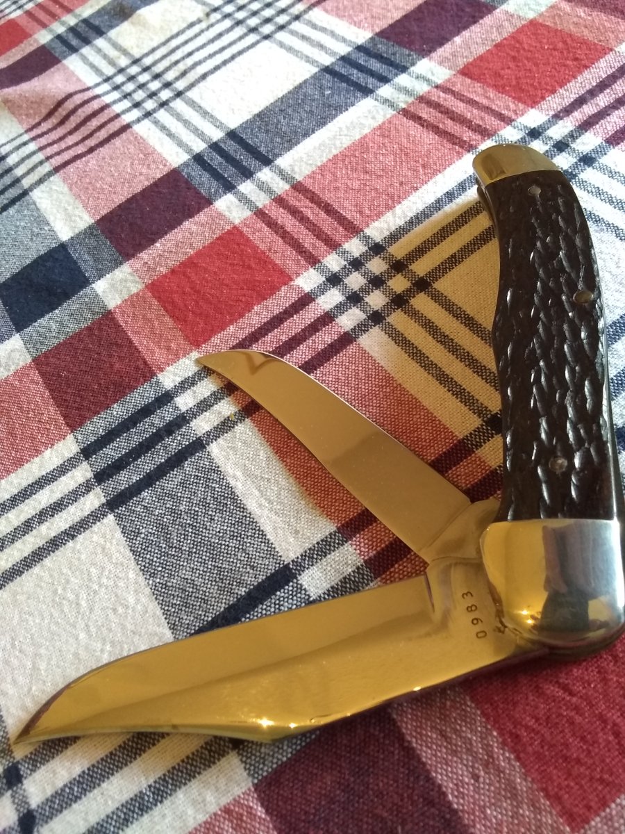

I think this Folding Hunter was made by Queen, possibly in September of 1983, as the pile side stamp I believe indicates a date rather than a pattern number. The mirror polishing on this knife is remarkable, had a hard time taking pictures without getting reflections. Eric said previously he's pretty sure Canal Street didn't make this knife.
Could it have been Bluegrass?

I don't know but it is a good looking and well made knife
- 1967redrider
- Posts: 21478
- Location: Alexandria, VA
Re: Who made KA-BAR pocket knives?
Miller Bro's wrote: ↑Sun Jul 04, 2021 6:06 pm I don't know but it is a good looking and well made knife![]()
I agree.
