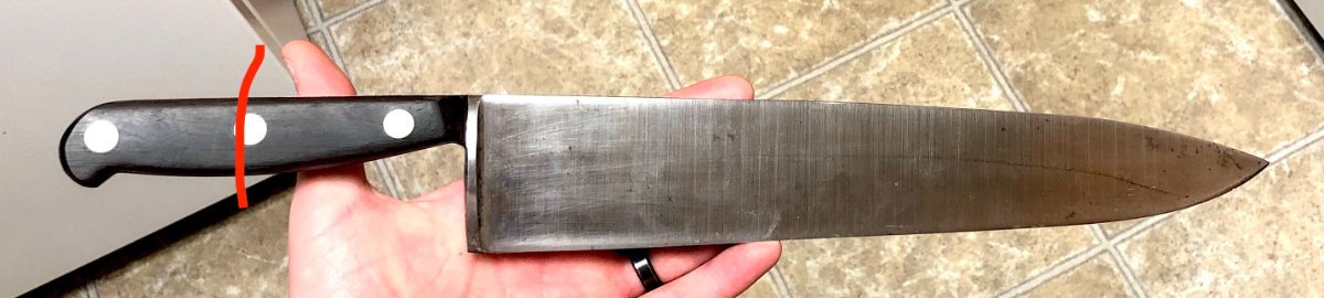

Lol! Sorry all, my friend has the knife currently but attached is a photo of it pre-breakage, with a line where it broke. hopefully, I did this right.

So tang broke where the center handle pin goes through.
Is the blade still stable or can it be moved up & down a little ?
It is a good looking Chef's knife.
kj

It's just slightly past it. My (hopeful) plan was to cut out a piece of steel to the shape of the half of the tang that broke, weld/attach it somehow and add a new handle. That is what I hope to be achievable. The blade is completely stable.

That's a nice knife. Is there a makers mark?
Did the tang taper in thickness toward the butt?
It would be a plus if you could get a usable knife out of your efforts.

It’s an old Case/Wear ever chefs knife. The tang does taper toward the butt. Does that make a difference?
It’s a collection piece and I was hoping to attach and shape to the tang and apply a new handle carved by myself.

A tang extension could be welded on then ground to the proper shape and thickness. Then you would rehandle it in your choice of material.
