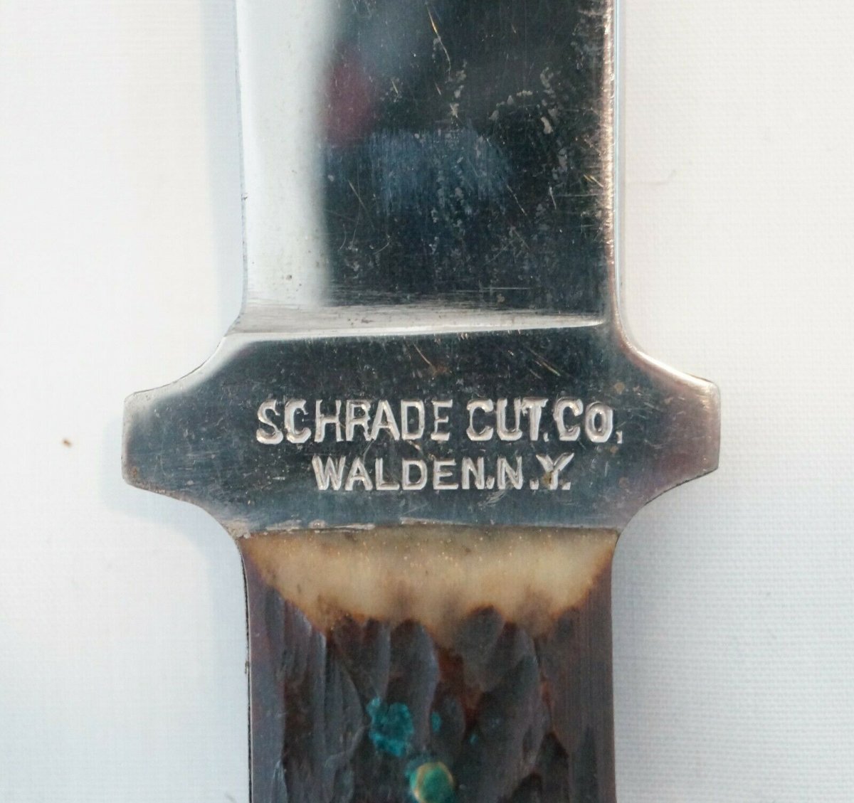

Hi Roland, I do believe this is a WW2 era private purchase knife meant for soldiers. Regarding the maker, I am unsure. I do know that there are a very few fixed blades attributed to Schrade Cut Co but they are marked SCCO, not just SCC. Cal has one of these bone scaled SCCO knives. I do own a lot of various 6" blade knives made for soldier use during the war but have not seen this one before.

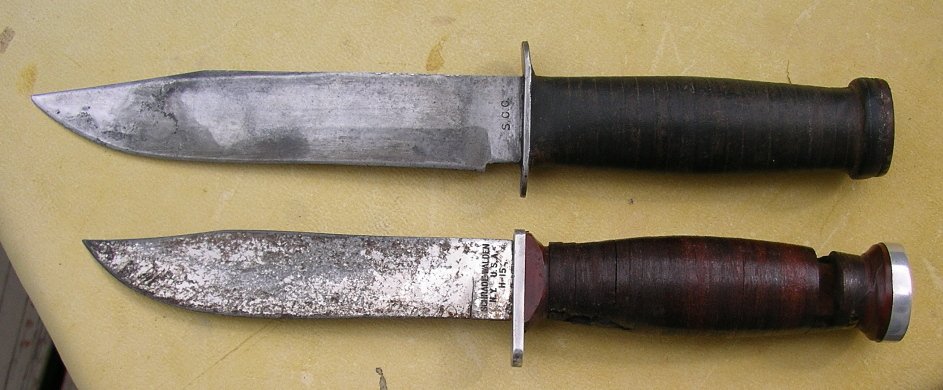

I have always heard that Schrade CutCo (pre-1946) never made a single fixed blade knife, but did sell a few that were made by others. I have two of them. One of them, with the integral guard was definitely a Kinfolks and even has a Kinfolks pattern number right on the knife. The other one defies absolute provenance.

Looking at that last "SCCO" knife, I think Roland's knife simply missed out on the "O".

zzyzzogeton wrote: Sun May 02, 2021 12:16 am Looking at that last "SCCO" knife, I think Roland's knife simply missed out on the "O".
Good thinking. Why did it not occur to me ? But the "SCCO" marking does not have a period after each initial, whereas there is on my S.C.C. knife.

Different stamps made per different specifications.
Someone submitted the work order paperwork for the die manufacture at different times. One person said "Schrade Cutlery Company" = S.C.C. Another said "Schrade Cutlery Company" = SCCO. A third person might have come up with "Schrade Cutlery Company" = SCCo or S.C.Co. or S.C.CO.
The devil is in the details, especially when it comes to something like a die. The maker is going to make a die EXACTLY as requested in the description of the work order. No artistic license allowed. This is how those "rare" versions come about - be it with knives, coins, stamps, etc. Some variations due to mis-made or damaged dies lead to "rare" instances.
tongueriver
Posts: 7239
Re: S.C.C. Fixed Blade
Post by tongueriver »
I agree with ZZ's assessment of the tang stamps. That said, I seriously doubt (opinion coming here, forewarned) that Schrade Cutlery Company made this knife or any other fixed blade knife. Ever. There are multiple scenarios here any of which could be true, but all are only speculation. The only human who knew the story has been dead for at least half a century. Here is a possibility: The war was on, and Schrade was not doing much. They had never made fixed blade knives but were interested in making a little money on government contracts. They had managed to sell a few electricians' knives. They had previously had Kinfolks make them a few fixed blades and asked them to make them a new fighting knife to submit for a bid to the government. So here they had the prototype they submitted. It failed because of their dollar $ bid. Oh, well. Fine; they never were that interested anyway. "We make folding knives, the best in the world." (Yes, they were making superb folding knives in an unbelievable number of elegant patterns). All of a sudden because of the war, this was not working. This rigidity actually cost them the company, because by the Spring of 1946 they were willing to sell out to Albert Baer. All thoughts welcome here.
