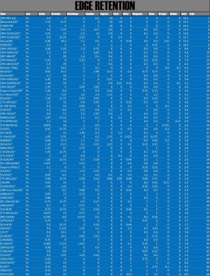

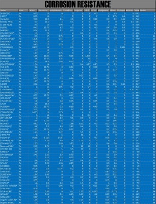

TABLES

I used Excel to create this, so it is easy for me to input any steel that has a listing of its chemical composition. Name a steel and I can let you know where it falls on my scoring system.
