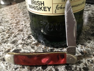

I had a Case junior Stockman which had been "repaired"--it had an incorrect sheepsfoot blade, one scale was missing, and it was generally a mess. Not having the correct blade, I decided to make it a single blade knife and re-handle it with synthetic material I bought from Jantz. It took me some time and I had to re-make the scales because I broke them attempting to pin them to the spacers. I decided to glue them in place instead--and didn't even risk pinning the spring pivot through them, heading the pins to the spacers instead and using a Dremel to hollow the backside of the scale for the heads of the pin.
The bolsters were pretty beat up, and I didn't try to take out all of the dings and dents--just cleaned them up a little. So it's a knife with...character.
It was clumsy and I'm sure not the preferred method, but I wasn't worried about ruining an expensive knife, and I think it looks pretty good in the end. The blade is tight and has good snap, and I was able to make it quite sharp (I have a cut to prove it!). Not something I'd feel like selling, but a perfectly serviceable and (I think) rather attractive knife.

That looks really good to me, nice choice of handles too!

You know some things now for the next one that could only be learned on this one. And you have a pretty knice pocket knife. Thanks for sharing.

nice knife ! I think it gives you a special feeling for a knife when you actually have something to do with the way it looks. Makes it more " YOUR" knife.beresman wrote: ↑Sun Feb 14, 2021 5:24 pm I had a Case junior Stockman which had been "repaired"--it had an incorrect sheepsfoot blade, one scale was missing, and it was generally a mess. Not having the correct blade, I decided to make it a single blade knife and re-handle it with synthetic material I bought from Jantz. It took me some time and I had to re-make the scales because I broke them attempting to pin them to the spacers. I decided to glue them in place instead--and didn't even risk pinning the spring pivot through them, heading the pins to the spacers instead and using a Dremel to hollow the backside of the scale for the heads of the pin.

Good Jobberesman wrote: ↑Sun Feb 14, 2021 5:24 pm I had a Case junior Stockman which had been "repaired"--it had an incorrect sheepsfoot blade, one scale was missing, and it was generally a mess. Not having the correct blade, I decided to make it a single blade knife and re-handle it with synthetic material I bought from Jantz. It took me some time and I had to re-make the scales because I broke them attempting to pin them to the spacers. I decided to glue them in place instead--and didn't even risk pinning the spring pivot through them, heading the pins to the spacers instead and using a Dremel to hollow the backside of the scale for the heads of the pin.

That looks good!
I glue scales on as well, but then pin them, too. When they fit, I have some 1/8" brass rivets from the old Schrade factory. They are easier to use than homemade pins, and has much less danger of cracking scales!
You made a good choice on handle material, and now you have a one-of-a-kind knife that should last a lifetime!

Good job and a fitting reward.

And the addiction gets a toe hold.
I like those handles.

I've been doing what you are for a few months now and I can tell you like others have, you learn something every time. My biggest problem in the beginning was I didn't have the right tools. Good luck sir and keep showing us your knives.beresman wrote: ↑Sun Feb 14, 2021 5:24 pm I had a Case junior Stockman which had been "repaired"--it had an incorrect sheepsfoot blade, one scale was missing, and it was generally a mess. Not having the correct blade, I decided to make it a single blade knife and re-handle it with synthetic material I bought from Jantz. It took me some time and I had to re-make the scales because I broke them attempting to pin them to the spacers. I decided to glue them in place instead--and didn't even risk pinning the spring pivot through them, heading the pins to the spacers instead and using a Dremel to hollow the backside of the scale for the heads of the pin.
