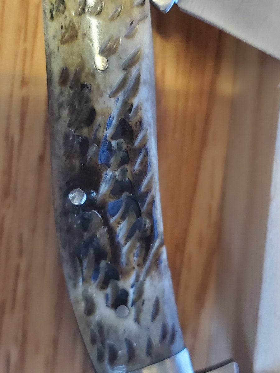

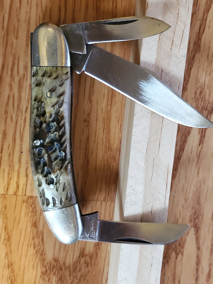

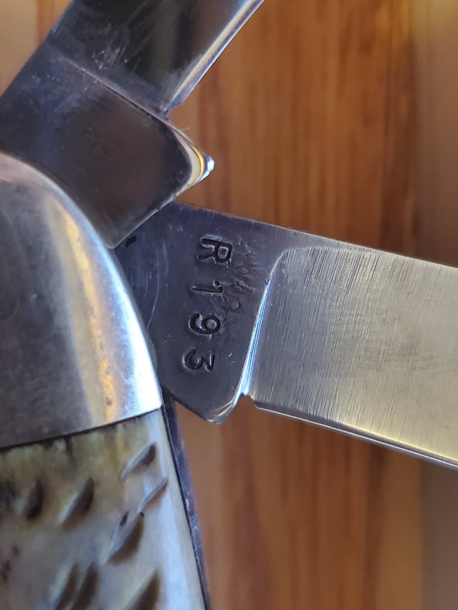

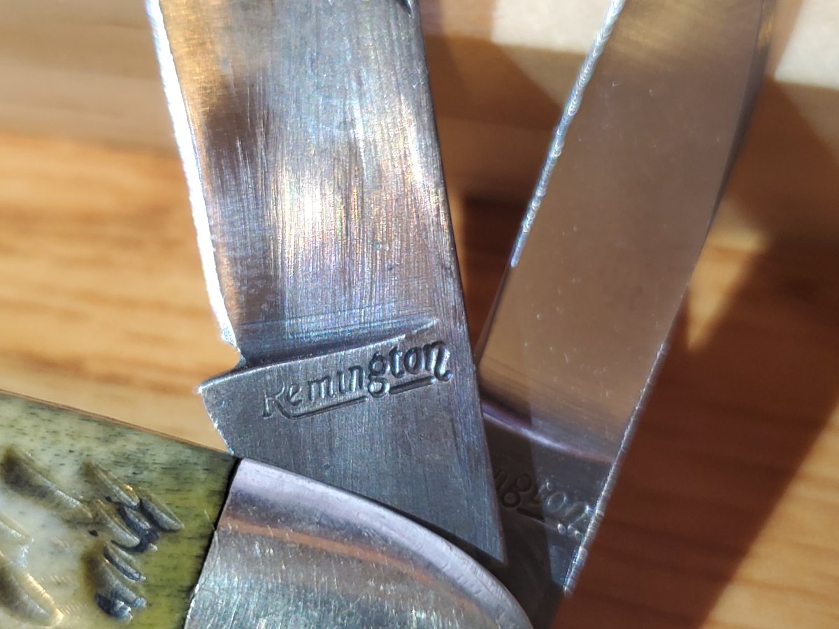

This was in a vintage collection that my great uncle had with many Case knives from the 60's and 70's. Cant find anything about any R193 anywhere.

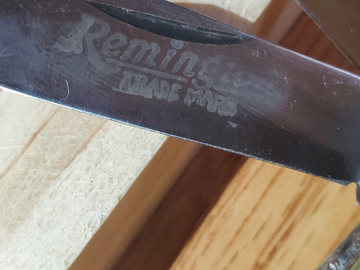

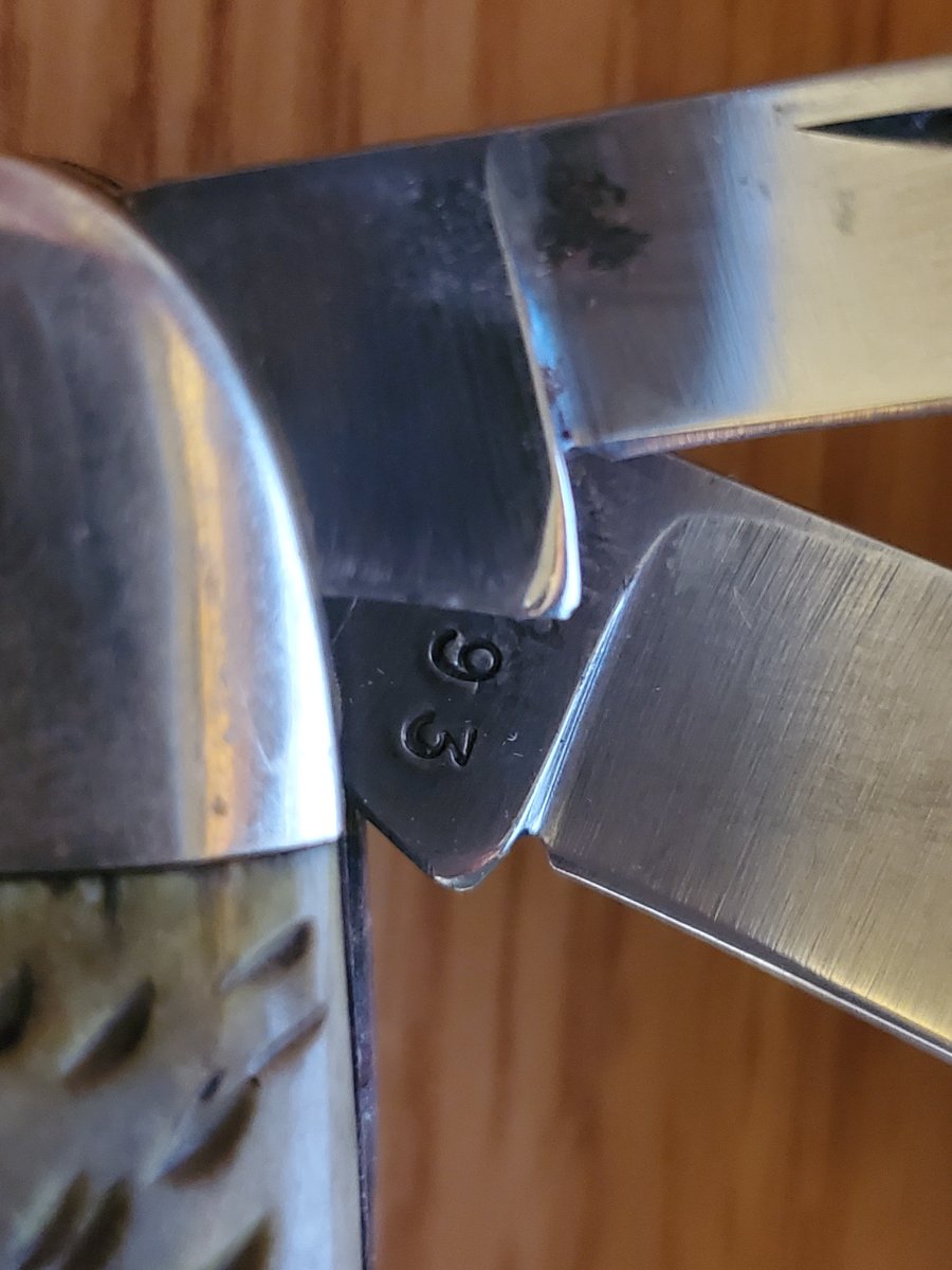

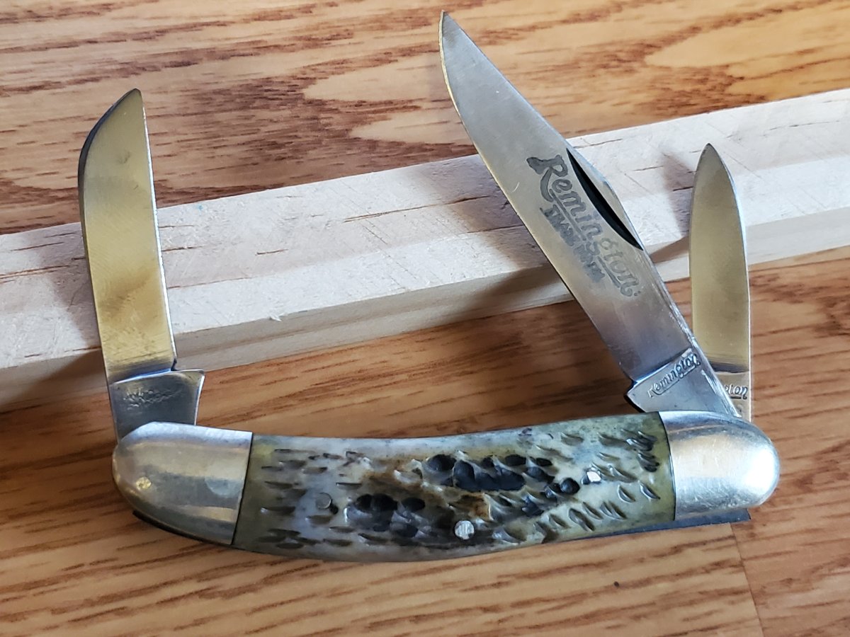

The Remington experts here will know, but I believe this is a total counterfeit.
The stampings look cold stamped and the Remington etch look off.
Everyone gets ahold of a bad once in a while. ::handshake::

Tim is correct, 100% counterfeit.

You’ll need to explain to her that it’s a counterfeit and thus not worth much. Might make a user for yourself or someone in your family that would like to have a keepsake from your uncle.

That blade etch is awful.

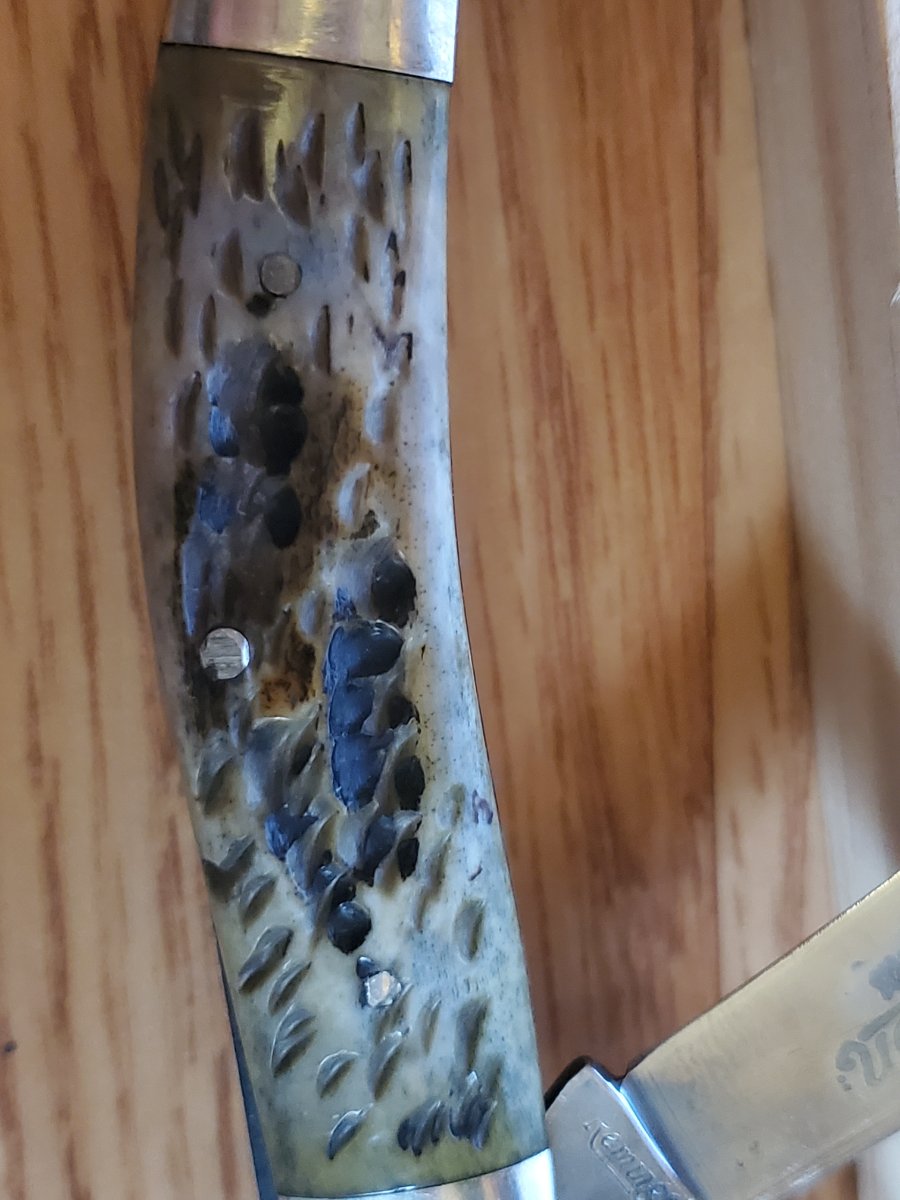

Looks inked and a cold stamp pattern number. Very randomly bizarre jigging too.
