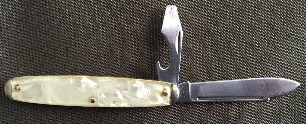

My favorite front pocket traditional knife has become the Lipic advertising knife manufactured by Camillus. It's a medium jackknife with a spear blade and caplifter/screwdriver blade.
I have one with plain white scales that may or may not have originally had a printed advertisement... there's nothing showing now. I just picked up another one in "cracked ice" type celluloid scales that has fully intact printing on it that I'd like to remove.
I tried an application of Flitz metal polish, hoping I could rub off the painted lettering. That didn't work, at least with one try. I'm thinking maybe I should try to gradually sand it off with 1000 or 1200 grit SiC wet/dry paper and then polish the scale afterwards.
Any recommendations or suggestions?

Bob, I don't know what the "best" way to remove the advertising is, but I can tell you what I have done. I have quite a few Camillus 23's that I have restored. I completely removed the synthetic scales on most of them and rehandled them with a variety of materials, but on a few that were in better shape, I removed what remained of the advertising with sandpaper as you suggested. I think I used 800, 1000, 1200, 1500 and then 3000 grit, followed by a good hand polishing with flitz and then the loose cotton buffing wheel at low speed, and then a good wax to finish.

Sanding and polishing would seem to be the safest and most obvious method, and the way I'll likely proceed. I was curious if someone might know of a shortcut. For example, I had thought I might try a solvent like lacquer thinner but I chickened out. I didn't want to risk ruining the scale, even to test the solvent in a small area.

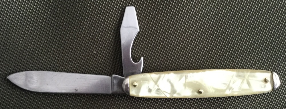

0000 steel wool and some Flitz polish got the printing off and the scale polished with no harm or noticeable evidence. Thanks for the suggestions, folks! (Wayne and Bob)
