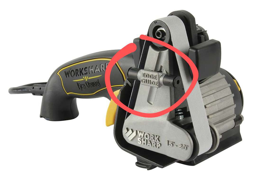

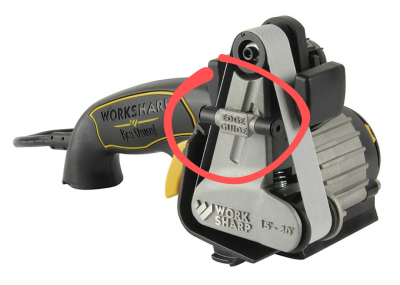

Mark-- on the Ken Onion edition the front horizontal blade rest/guide pivots out of the way for pocket knives. Does the regular edition do this? I always pivot it out of the way when sharpening pocket knives for the reasons you stated above. I don't think I would use a belt on a "valuable" or a "collectible" knife coarser than the very fine or honing belt.Sharpnshinyknives wrote: ↑Thu Jan 21, 2021 9:52 pm Ryan, Glad you brought this thread back up. Also glad you picked one up. I have thought about moving up to the Ken Onion version with the wider belts and more angle options. I did just buy 24 new belts for the one I have. Trying some different grits than the ones that came with it. Mostly finer grits to really put a fine edge on some blades.
One thing I found out the hard way, and maybe the better version wouldn’t have this issue, is that thumb studs present a real problem if the studs come out away from the bolsters very far. You just can’t get the entire cutting surface to the belts and your bevel is now off. Trust me you don’t want to take the guides off to fix the problem.
I agree with you about how many passes are needed. You don’t want to use the coarse grits on a blade as many times as they suggest. This thing really takes off metal. I was surprised on a really old knife I have how much more blade loss I had after I took just one pass on the coarser grits. Best to start out with less than you think and work up and back down.
Here is a picture of the blade rest on ours (screen shot from the internet). You pull out on it and it pivots to the vertical position if needed (It's spring loaded). You have to get a feel for it as the blade you're sharpening will just sit on the back horizontal blade guide/rest. After a few tries you'll get the feel for it.

Ryan, it does not have a guide that pivots. I wish I had known before I bought the difference. That tool sharpener does look pretty nice!
