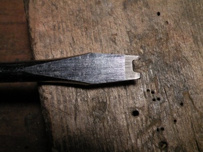

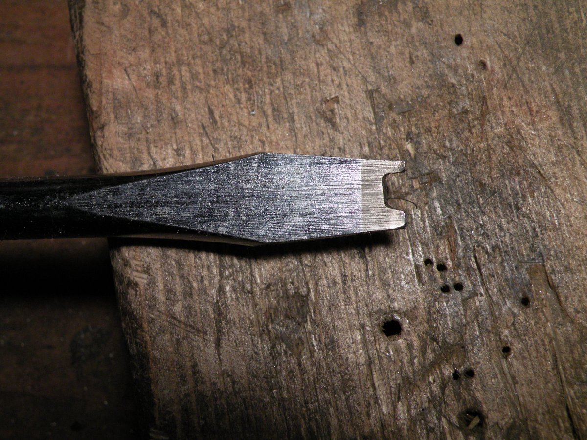

Take a screwdriver with a wide enough bade to span the whole nut. Grind the screwdriver tip down until it is close to the same thickness as the slots in the nut. Grind or file a notch in the middle close to the same width as the diameter of the tang. I used a cut-off wheel to make a perfect square notch. If the screwdriver tip is not very close to the size of the slots in the nut it will mar the nut. These can easily be made with a little patience and work perfectly. A penny will not do unless you have a loose nut.

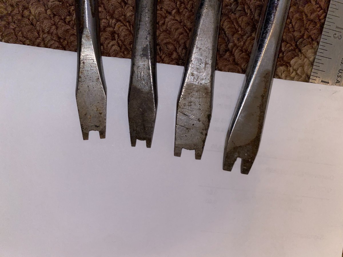

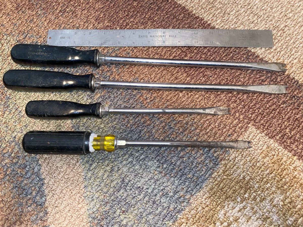

Here are 4 big heavy screwdrivers that I filed out and use for removing barrell nuts from pommels. I can put a lot of torque on these and it is needed in many cases. I clamp the knife blade in a plastic jawed vise on my bench and use plenty of downward pressure while turning. At times it can be very difficult to remove the nuts even doing it like this. Care has to be taken to not let the driver slip and scar up the nut.

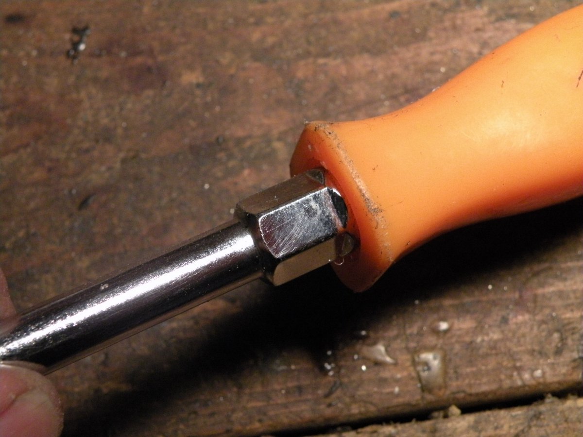

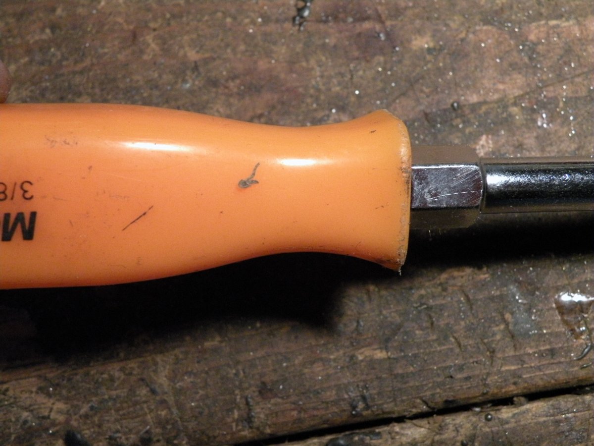

Ditto, Kroil and a big screwdriver modified to fit the pommel nut perfectly. I like this one because of the nut at the base of the handle. Once, I had one that was really stuck, and I pushed down and twisted as hard as I could and my son put a wrench with an extension bar on the screwdriver's nut and it worked like magic. I like to put the knife with the handle up in a vise, add the Kroil around the tang nut so you have a little puddle there, and let it sit at least overnight. Last step - clean the tang threads with a wire wheel and the nut threads (if you are going to reuse it) before you put it back together.

Herb and Wayne have the right idea. But they are using the screwdriver tips as from the factory. I grind mine down to where the thickness of the blade closely fits the slots in the nuts and they are therefore less likely to slip and mar the nut or pommel. Don't know where they are right now for pics. If you only have a straight shaft screwdriver without the hex at the handle end to apply a wrench for more torque simply clamp a vise grip pliers on the round shaft for more turning power. Sometimes the end of the tang threads are a little mushroomed over and I use a die of the proper pitch and thread to clean it up before re-installing nut.

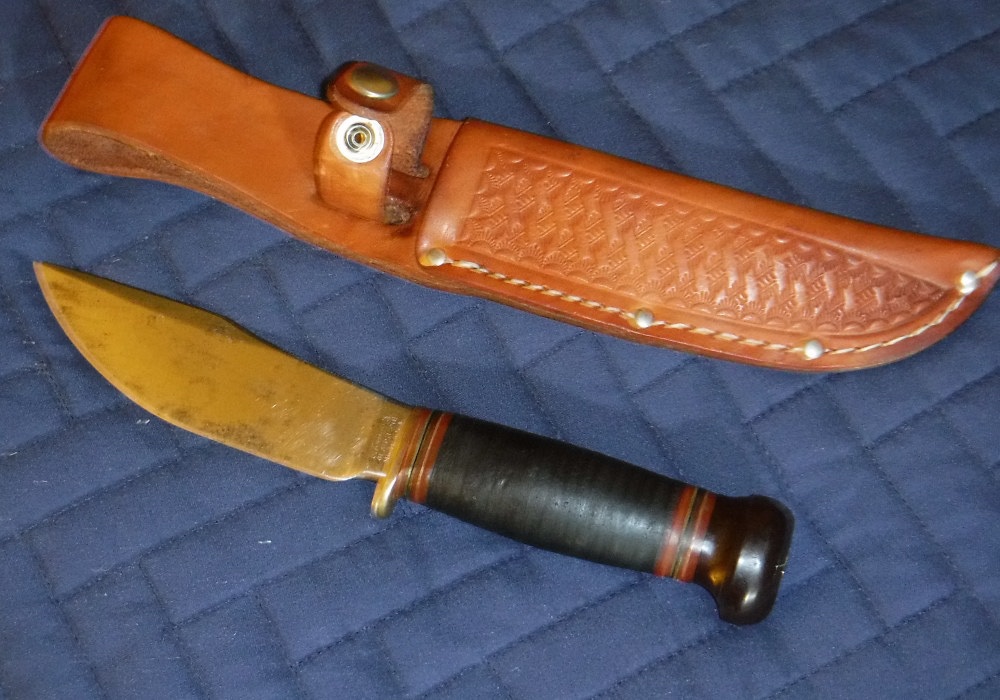

The pommel nut tool from Gladstone, MI showed up today. It fit the pommel nut and, with the aid of an adjustable wrench, I was able to loosen, then tighten the nut enough to eliminate the looseness in the bakelite pommel. Mission accomplished!
The knife was a gift from an elderly friend, now passed. I'm going to carry it next hunting season instead of my trusty Randall Model 8. (Please excuse the horrible iPod photo)

The knife is well-used and was pretty rusty when I got it. I cleaned it up enough that it doesn't make me cringe, but still shows that it lived a hard life. That darn bakelite pommel stands out like a diamond stuck in a goat's butt... the rest of the knife looks rough but the pommel still shines like new, in the photo anyway. The bakelite just doesn't age like leather and steel.
