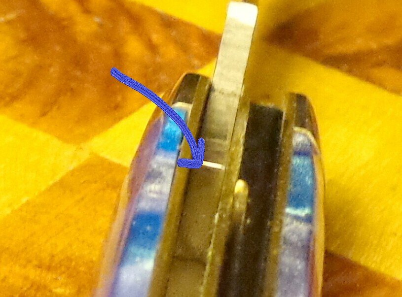

Sometimes the problem is that the blade is just too tight in the frame. I have cured that problem by saturating the joint with metal polish and opening and closing the knife several hundred times: then cleaning and oiling.

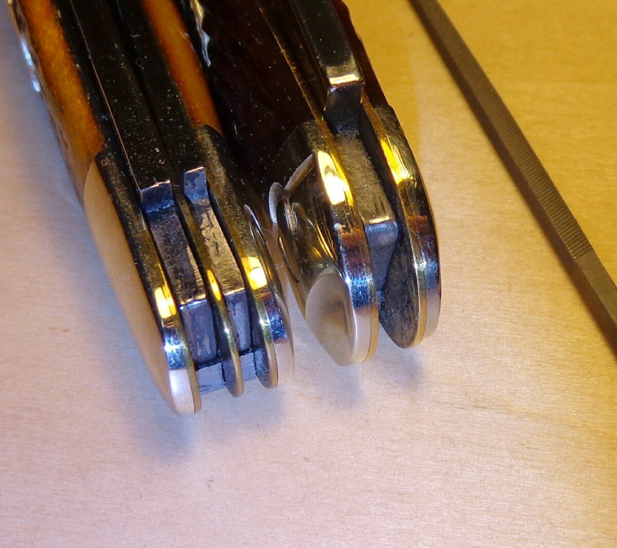

Check the tang. If the tang has a really acute corner, as in the knife to the left in this photo, you can follow Herb's suggestion. Take a tiny file and round the corner just a bit.
Mel

Herbva: " you can slip in a tiny jeweler's file and shave off a bit of the corner of the tang where it first contacts the spring when you are opening the blade. " Could you post a picture with an arrow pointing to the area of the tang to be filed ?
"where the tang first contacts the spring" is not accessible, so i must be looking at the wrong spot.

The arrow points to the crucial area if you are opening the knife!kootenay joe wrote: ↑Mon Nov 30, 2020 1:46 am "where the tang first contacts the spring" is not accessible, so i must be looking at the wrong spot.
I really want to understand this.
thanks, kj

Thanks i was looking at the spine side. So do it with blade fully open and file end of tang down in the well.

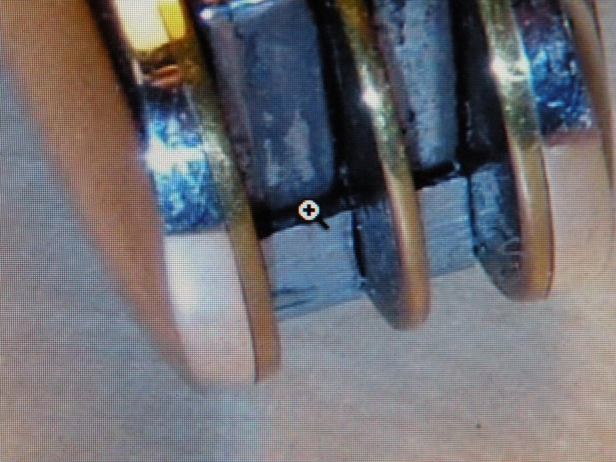

Greetings Roland. I hope that all is well in West Kootenay. I see now that I should have been clearer about the corner of the tang I was referring to. I have taken the liberty of attaching a picture below of the picture that Mel provided above and I have added a "+" next to the corner of the tang I was referring to. When the blade is fully open, this corner will be on top with full access for a small jeweler's file. One only needs to take a tiny bit off to slightly round this corner, which will be pushing into the spring when you start trying to open the knife. As David mentioned, go slow and test often. Of course, it is important to then remove the metal filings first before doing anything else. I use compressed air to remove the filings. I do not use sandpaper for this because the grit will fall off and into the works of the knife. Also as Bob (realeye) mentioned, it is important to have the joints completely "ultra" clean. I do this as a first step on any knife I work on. Everyone has their preferred method of cleaning the accumulated crud out of a knife. Mine is WD-40. With the knife resting on its back with blades open, on a pile of old newspaper, I flood the blade well with WD-40, let it sit for a while, then clean it out with a blunt end probe wrapped in paper towel. Make sure you push it around vigorously and into all the corners. (The WD-40 will dissolve hardened grease, dirt and other evil contaminants that have accumulated inside the knife.) Repeat this procedure until the paper towel comes out clean. Frequently the snap will be restored or improved and the blades will operate much more smoothly after this simple operation. Sorry for the long-winded explanation. Best regards. Herbkootenay joe wrote: ↑Mon Nov 30, 2020 1:46 am Herbva: " you can slip in a tiny jeweler's file and shave off a bit of the corner of the tang where it first contacts the spring when you are opening the blade. " Could you post a picture with an arrow pointing to the area of the tang to be filed ?

thank you, but now i am a bit confused. In the picture posted by Mel, the blades are open and the corner to file is down in the blade 'well'.
The picture you posted shows blade closed and the place to file is where the tang touches the spring. Looking at knives i have here, this corner (edge) of the tang lies flush and tight to the end of the spring. There is no way for a tiny file to get between the tang and spring to be able to round off edge of tang.
Sorry i am not 'getting' this.
I do understand that if the edge of the tang is slightly rounded it can roll under the spring more easily thus making blade a bit easier to open.
Oops, maybe i do get it. With blade open, the edge of tang that is accessible in the well, is the same edge that abuts against the spring when the blade is closed. Is this correct ?
kj

Roland, yes, that is correct. The corner of the tang I pointed out will be on top when the blades are open. As I stated above, "When the blade is fully open, this corner will be on top with full access for a small jeweler's file." I have only had to do this procedure a few times, and I think it has always been on larger, stubborn knives. Usually the cleaning I mentioned above, and a few drops of Quick Release oil had freed up the blade or blades sufficiently.kootenay joe wrote: ↑Mon Nov 30, 2020 2:29 pm Herb,

Herb thank you for sticking with me until i 'got it'. And thanks to David too. I am not a natural mechanic but really enjoy learning 'how to' on most things.
