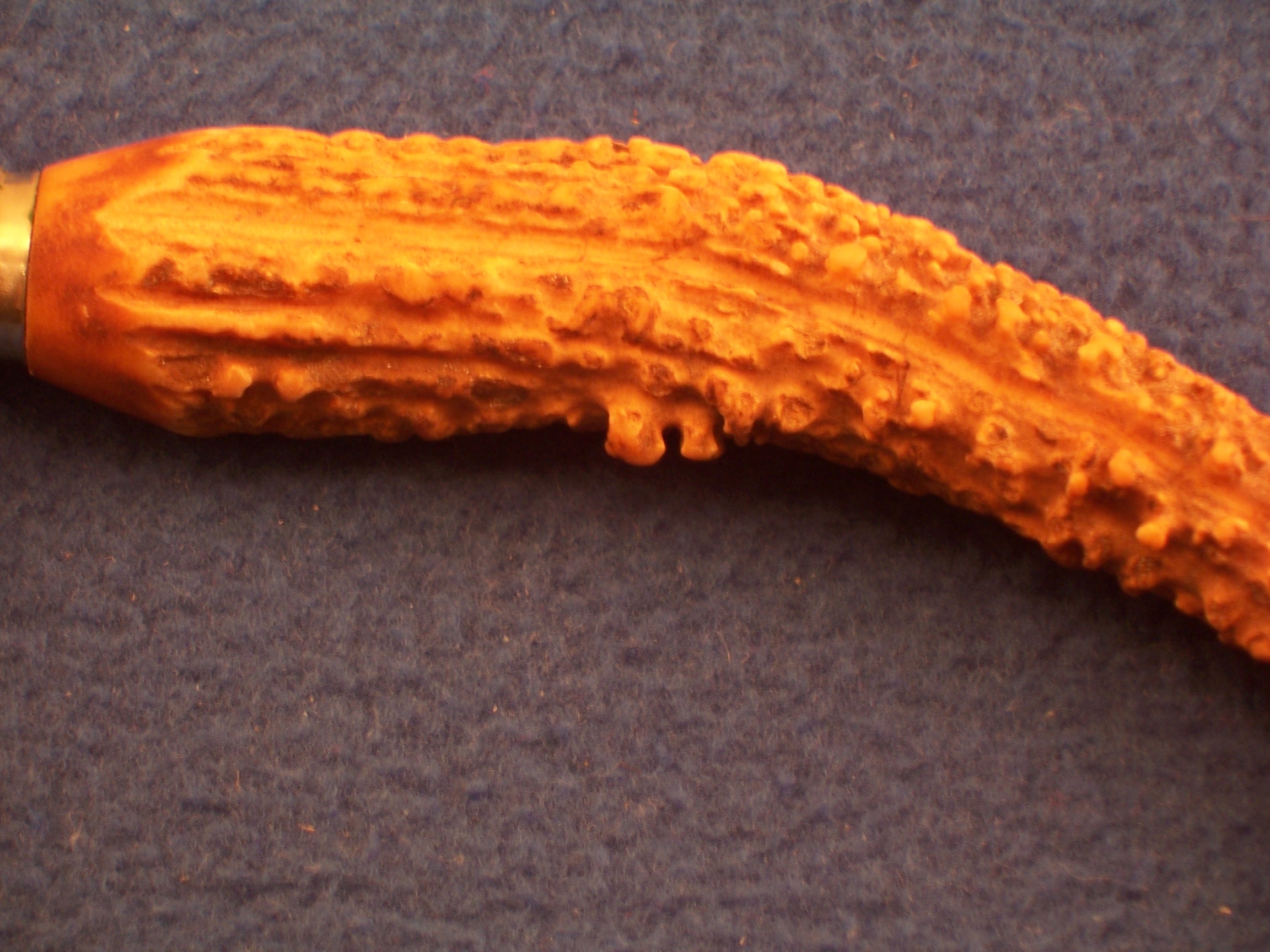

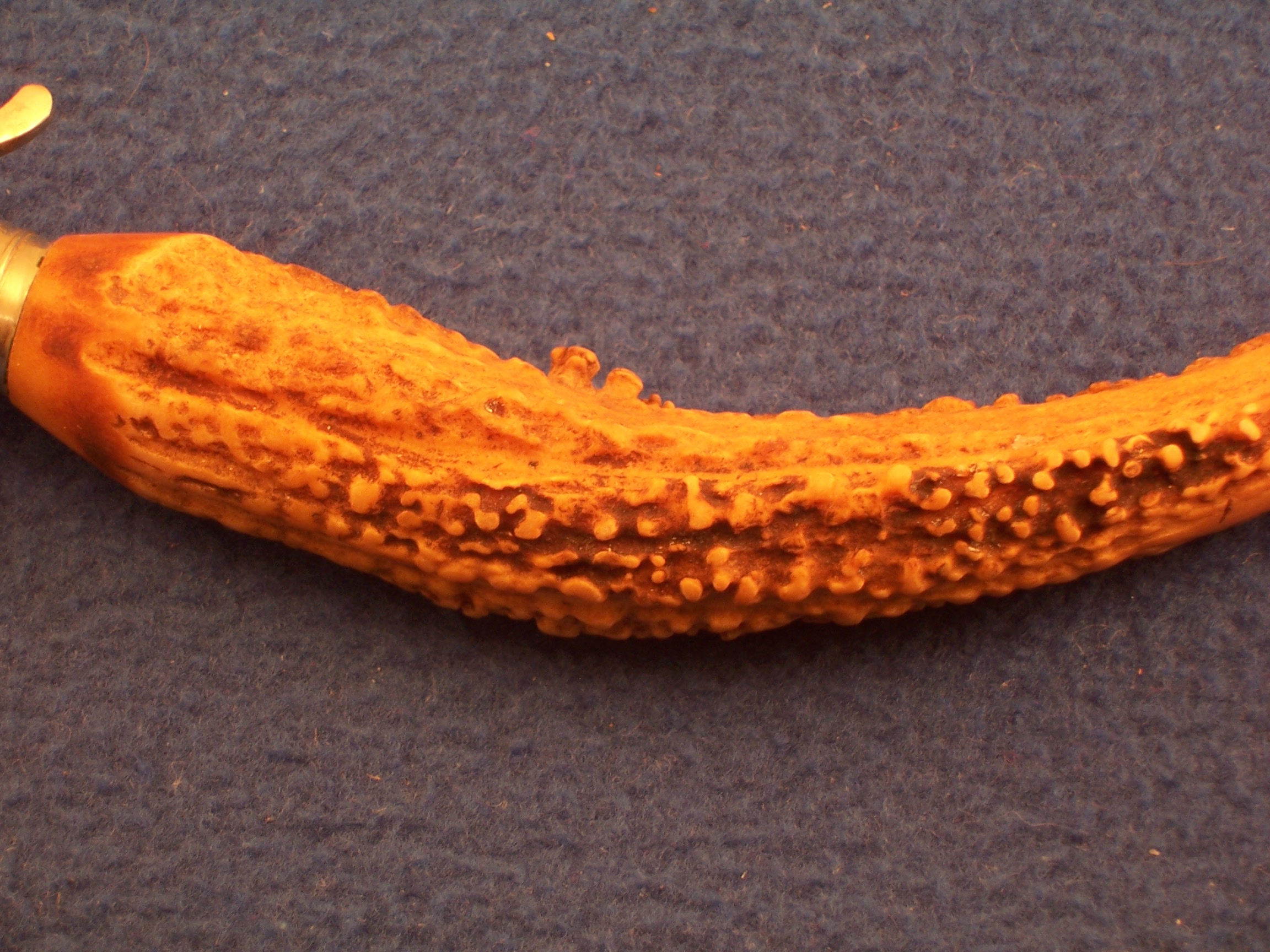

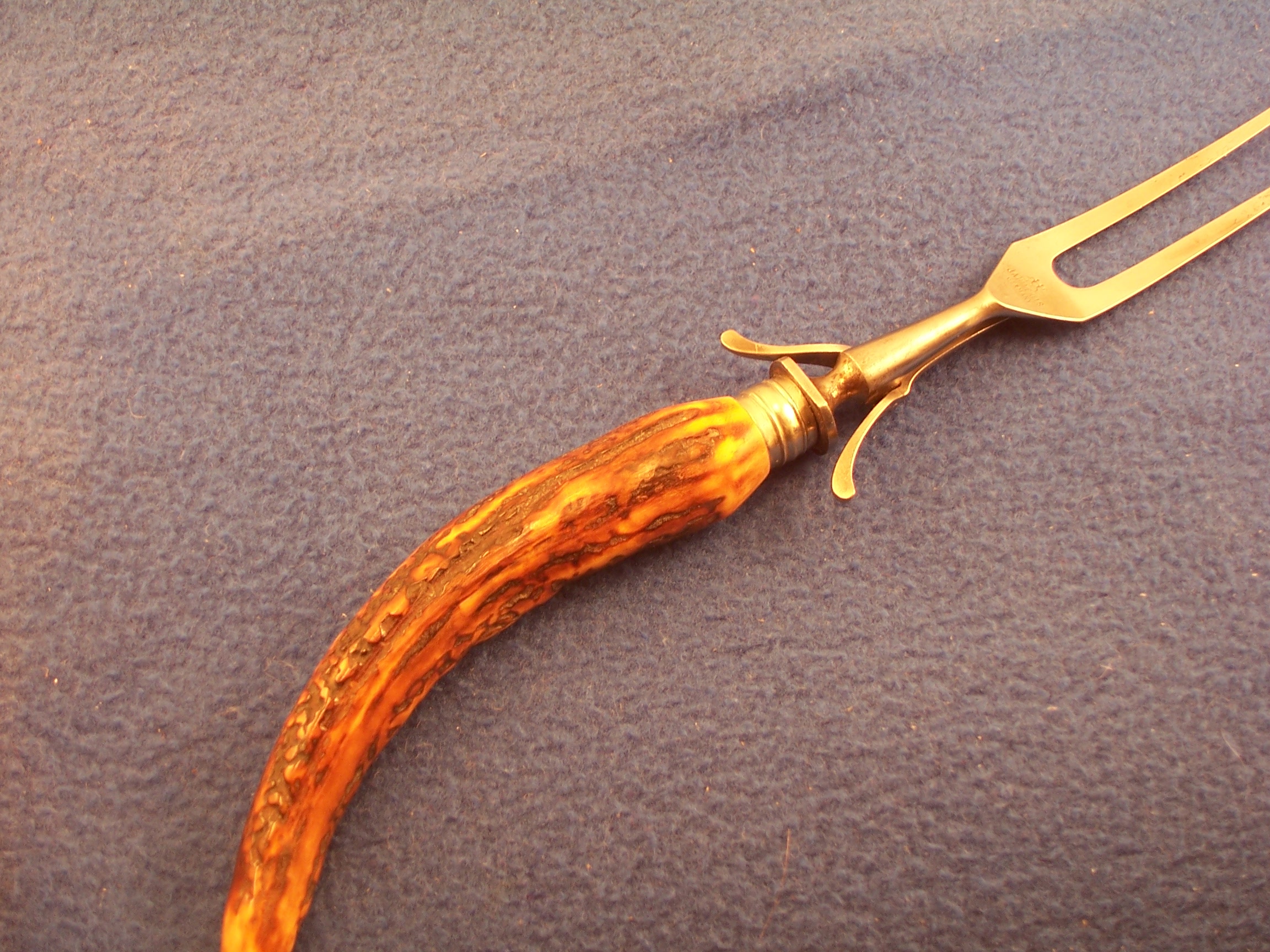

Can I torch a stag handle the 2nd time?
I cleaned a stag handle too much.
Most of the black is gone now.
What do I do to prepare it for the torch?

Hey Ken,
Sure... you can torch it, until you get it the way you want it. I would prob. clean the Ren Wax off the handle first - but that's just me. The torch will prob. burn the wax off, neway.
Just keep the flame away from the blade ! A lttle heat goes a long way.

a propane torch with a tiny flame and keep it moving and away from temepred steel parts like springs, and blades.

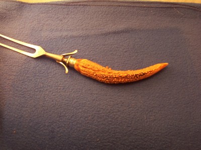

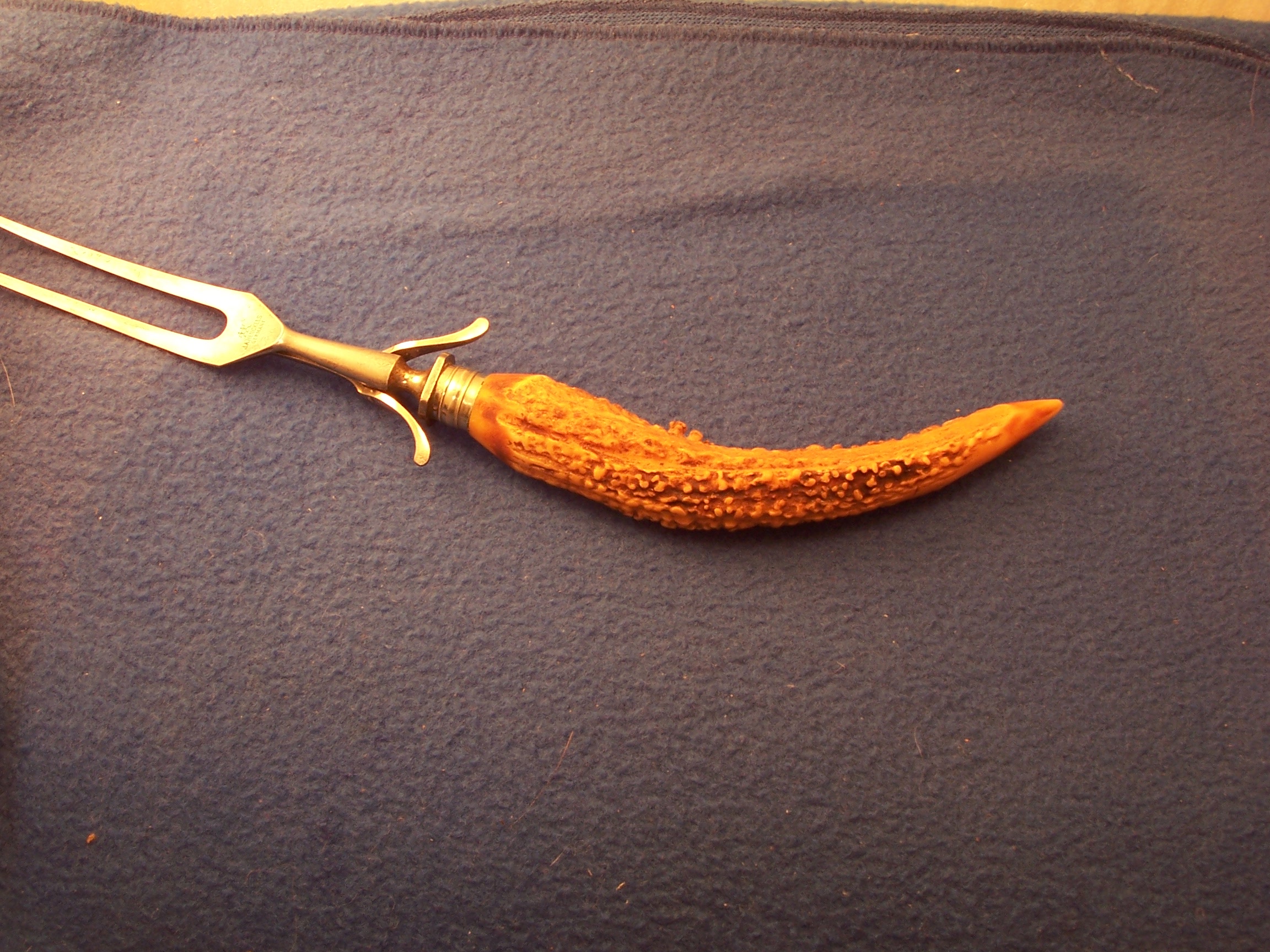

I had to wait until the camera batteries recharged.
Here is what it looks like now.
no springs to worry about.
So just torch it carefully. KOOL

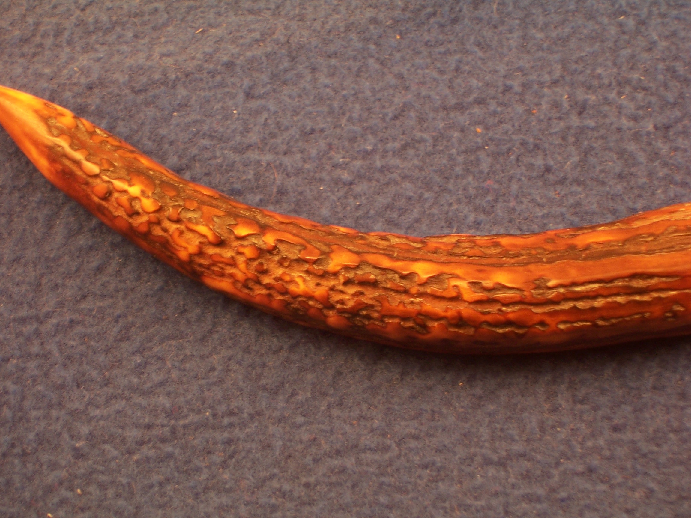

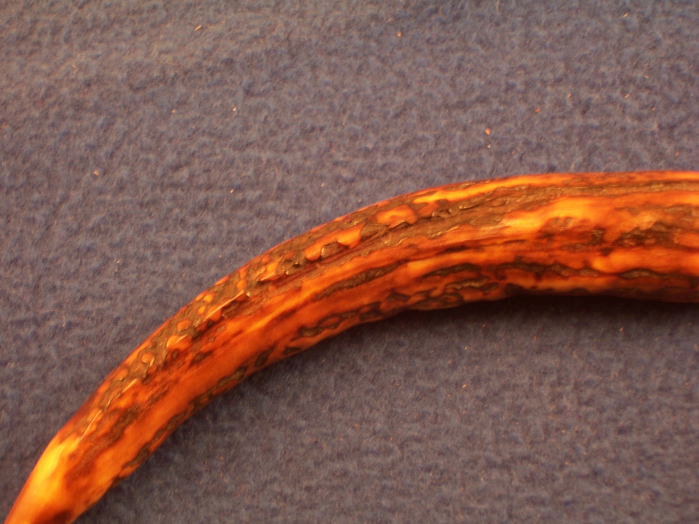

I can see why you would want to torch it again, the close up photos of the handle look like the shrunken carrot that I found in the bottom of the fridge yesterday....
This was rather EZ to do. I would say it was like a wood burning project way back in Boy Scouts with a wood-burning pen (I used a torch). Of course I did not have bolsters or springs to mess with.
A fast burn is best, so not to burn away the nobs. I think I went to slow on the burn. Lost some nobs...But I learned.
O well I am please with the end results.

Looks good to me Ken. Nice job!
