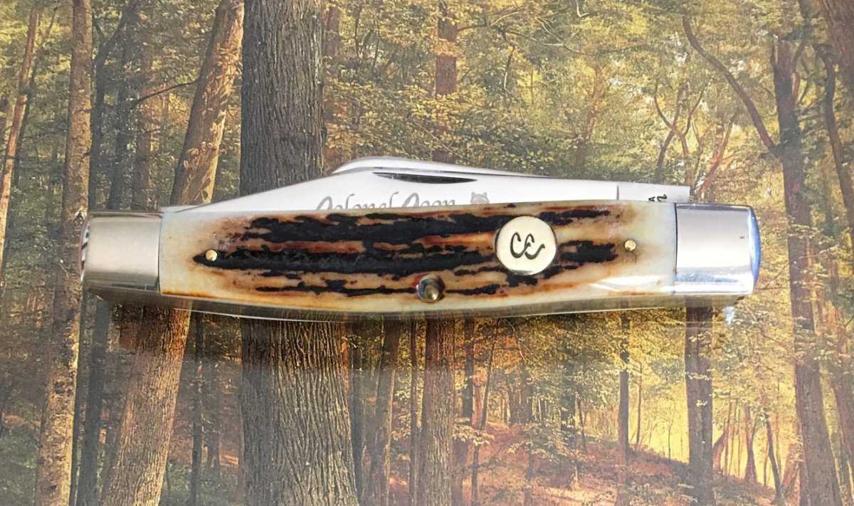

Happy Thanksgiving, everybody. Someone please tell me what formula was used for the steel in the blades on this Colonel Coon. It's their #49 Stockman, built on a Queen's #49 pattern:

It is a Colonel Coon in name only, so I would guess the steel is whatever Queen was using at the time, doubt it is D2 or ATS-34, probably 420HC.

geocash wrote: Thu Nov 26, 2020 1:26 pm Happy Thanksgiving, everybody. Someone please tell me what formula was used for the steel in the blades on this Colonel Coon. It's their #49 Stockman, built on a Queen's #49 pattern:

Thank you, everybody. Since Queen was using their own pattern it makes sense they would also use their own materials so I feel pretty good about 420HC.

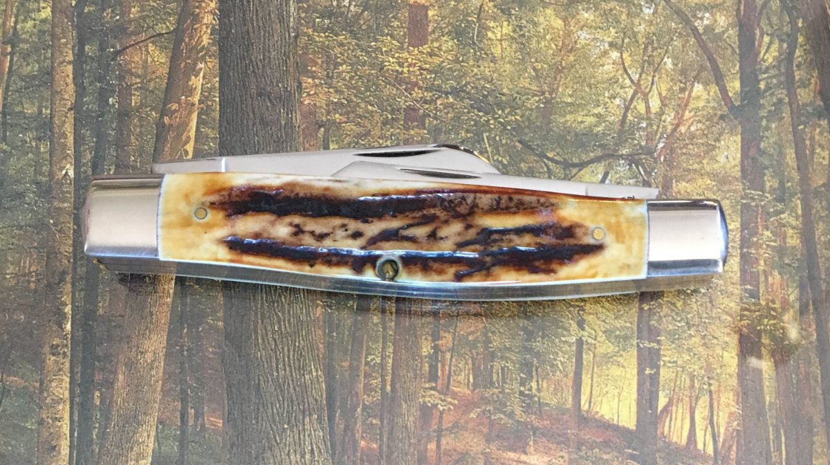

By the way, that is a beautiful stag #49. Is there any chance that you'll treat us to a picture of its pile side?

Modern Slip Joints wrote: Thu Nov 26, 2020 6:54 pm All of my Queen made Colonel Coon folding knives that came in boxes came in orange two piece boxes that have "high carbon 440 stainless blades" written on one end. When 440 is not advertised as having a higher alphabet suffix than A it is safe to assume that it is 440A. During the years they were made Queen's standard stainless was 420HC. In use I doubt that you'd be able to tell one from the other.
While many of Queen's Robeson pocket knives are stamped PH-D2 I have not seen that stamp on a Queen made Colonel Coon.
Please correct me if I'm wrong but I believe all the Queen made Robesons and Colonel Coons were made for SMKW.
By the way, that is a beautiful stag #49.Is there any chance that you'll treat us to a picture of its pile side?
Very good. Your comment motivated me to find the box & look more carefully. I thought it just had "CC49" but on the other end, in small light print, it has "high carbon 440 stainless blades" just as you said. Well, I had the answer all along but at least I got to show off the knife. And since you asked so nicely, of course I'll show the other side, too. Thanks.

Its sides are very well matched. Both look great!
